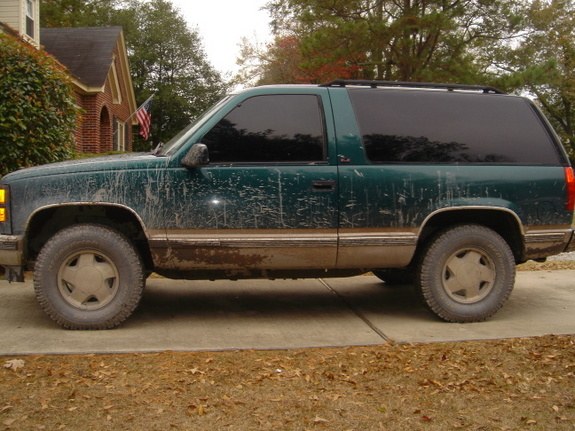

Does anyone have pictures so we can see the difference between 265 to 285??
BTW, the picture of my hoe below is with 265/70/16 . . .

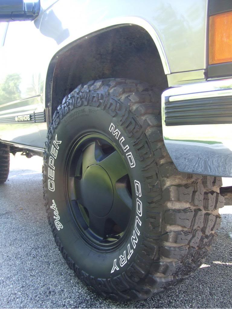

On your stock rim which is a 16x7 w/ 5.5" of back spacing i would only go up to a 305, even w/ that you will probably have some rub on the frame. If your keeping with stock i would just go 285 and you will minimize rubbing and cupping on the tire. If you go aftermarket i would look into something around 8" inches wide and 5-4.5" of backspacing, then you could get away w/ a wider tire.
This was my 285 tire on stock rims, had no rubbing and good even wear on the tread.
