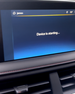

I have a 2023 Tahoe RST. I really like the vehicle. Two Infotainment System issues. First, while driving, the Infotainment System will randomly shut off and restart. The screen states "device starting." If I am driving and on a call, the call will drop off the system but still be on my phone. Second, if listening to the audio, whether radio or sirus, the audio will cut-off for a second or two and come back on. Any advice is appreciated.

Suggestion: take a video of it happening, so that if they ever get to the point of saying it’s normal…you have evidence.
I had a similar issue with my 2023 RST. While driving, the infotainment system would shut off for no reason and then start back up. I contacted the service manager at the local dealership, and he told me to disconnect one of the battery terminals for a few minutes and then connect it back and see if that resolved the issue. I disconnected the negative terminal for a few minutes because disconnecting the positive terminal would have been a lot more complicated. I have not experienced the random rebooting and restarting of the infotainment system since then.
I'm having the exact same 2x issues you previously described. Mine will only reboot once a week or so. No real rhyme or reason. Time, temp, usage are all over the board and haven't found any consistency yet.
Why does disconnecting the negative to the battery work?
Did you lose any settings that needed to be reset? Or lose any functionality?
