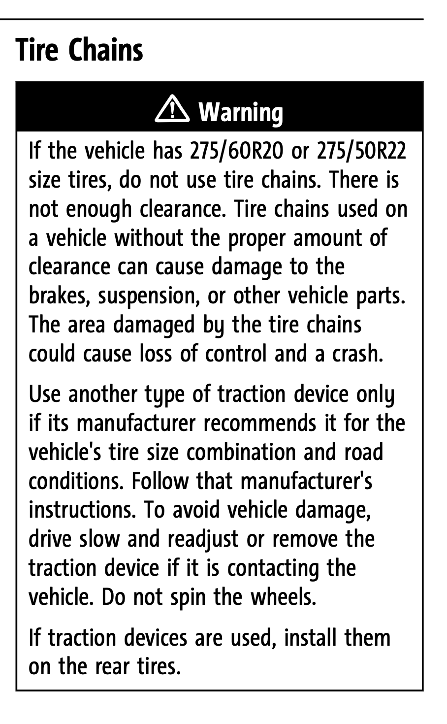

We have a 23 Tahoe with 275/60-20s on it. These tires have the same circumference as your 24s (but not as wide). Per the owners manual you can't use tire chains. You may be able to alternatives to chains like cables and only on the rear. Your best bet would likely be to get a 2nd set of rims and put some true winter tires on. Living in Wyoming and previously in Colorado most of the time winter tires on a 4 wheel drive are enough to not get a ticket/stuck.
