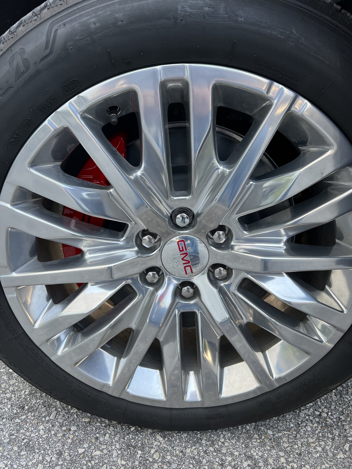

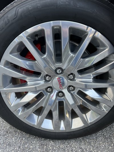

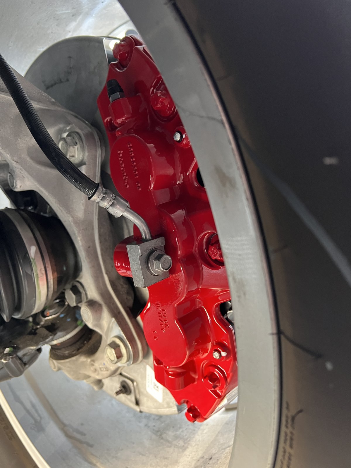

I have the Brembo Performance Brake kit installed on the front only on my 2023 Yukon Denali Duramax 4x4 with Air Suspension. Installed by the local dealer. The only issue installing these is that the larger front CV joint blocks access to the four bolts holding on the hub at the yoke. Need to pull the axle out a bit in order to gain clearance needed to separate the hub from yoke and swap out the dust shield.
