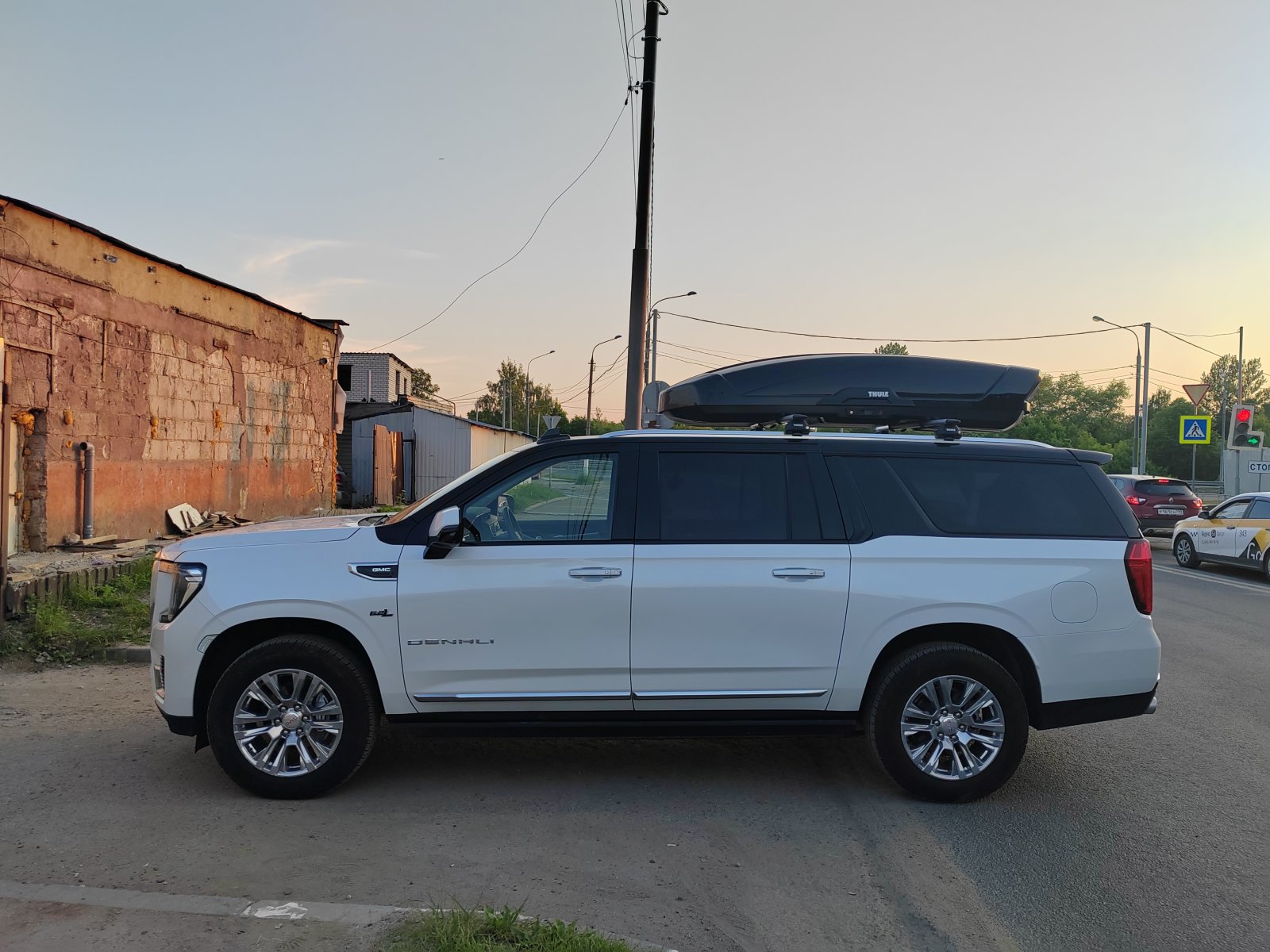

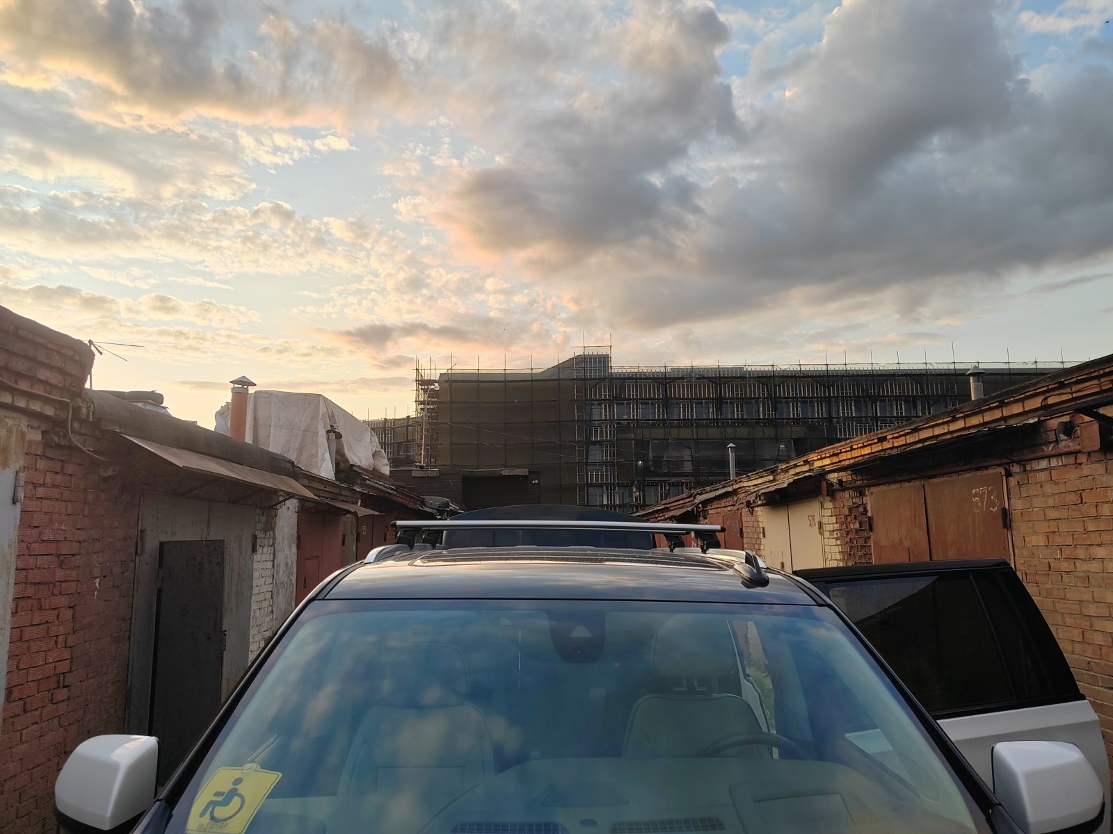

I may not quite understand what you want, but my Thule kit fit perfectly on the Yukon 2022 without drilling the roof. and boxing stood on the crossbars of Thule.

I think OP needs the chrome or black rails that mount to the roof of the truck so he can use the cross bars and a cargo box. His truck appears to not have the rails that run the length of the roof.

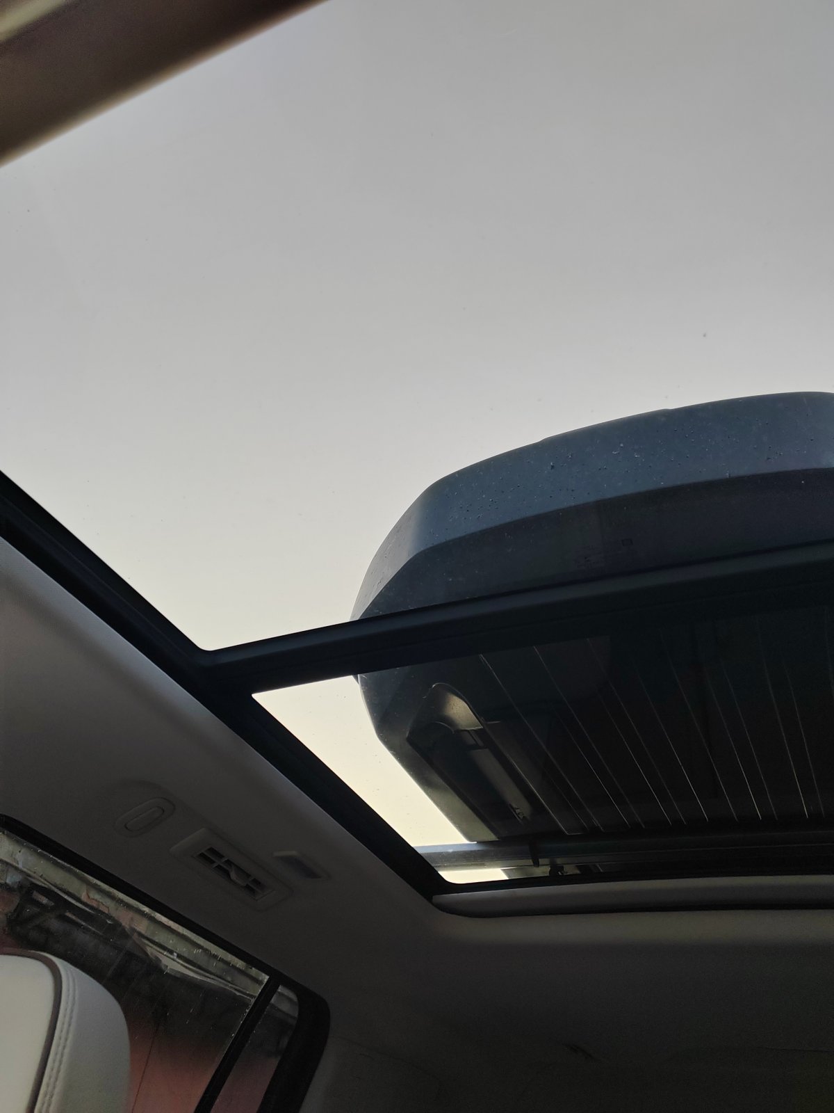

On another note, which Thule cross bars are those?? They look like they sit far lower than the stock ones on my denali. I am about 3" or so too tall to park my truck in the garage with my cargo box mounted. Would like to just leave it on but the height of the stock cross bars makes that prohibitive. Next question would be do you have a sunroof and can it open fully with those cross bars mounted?

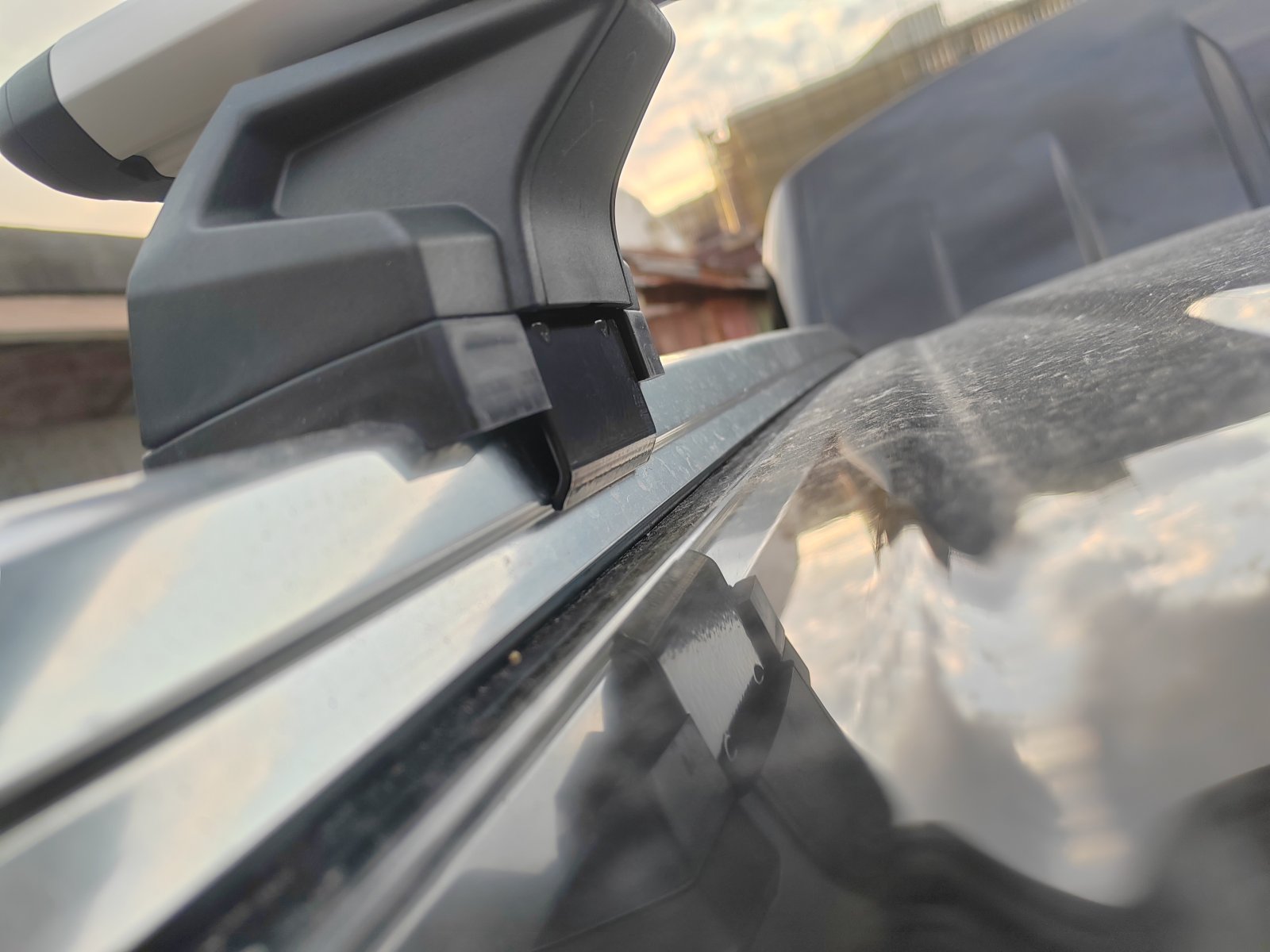

This is a three-part set. Thule wingbar evo 135cm. It comes with two sets, these are Thule 710600 and Thule 186117 this is an adapter for our roof rails. Yes, the hatch opens without any problems, the box does not interfere with it in any way

Thank you! Any idea how far off the roof they sit? Trying to compare height to the stock roof rails.
