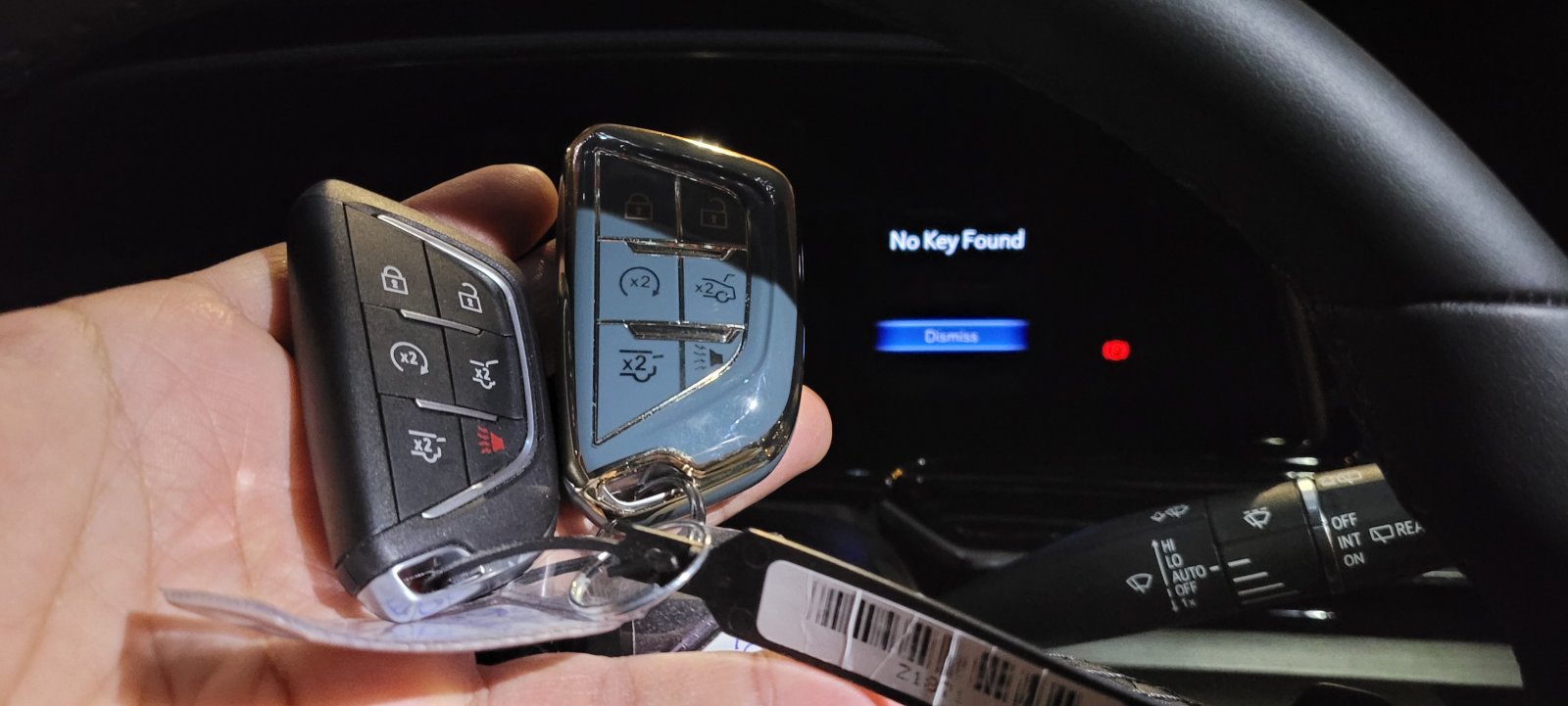

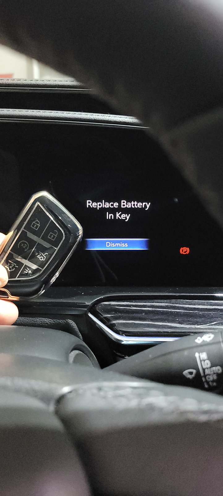

Hey guys,
Hoping someone can chime in and help.
We picked up our 2023 Escalade 1 month ago today. After 2 weeks Both key Fobs went dead and were not recognizable by the vehicle. Took to dealer and they ordered "new" Energizer batteries which were supposed to be OEM to replace the dead Panasonic pair. This is in both key fobs. After 1 week since replaced key fob number 1 already saying replace key fob battery in the vehicle. I'm at a loss. Dealer says they've never heard of it. I'm going to take it in but wanted to see if anyone experienced this issues with any of the full size platform.

Something must be going, I don't believe the dealer about OEM batteries. I have had the battery last a long long time in my 2016 Tahoe. I would just buy a Duracell CR2450 which I think is the replacment and try that, then call the dealer

Honestly I bought a battery but to have both remotes die at the same time to the point of locking me out of the car I think something else happening. I watched them open new packages of batteries which were the same one I bought and 1 week later it's showing replace battery. They suggested using a Faraday Box and keeping key away from car which I already do. 100% I know it's not me. I've only had the thing for 4 weeks. Will take it in anyways but sucks to think I might be the only one with this problem....

#Update Tried picking up a battery and replaced my main remote and that died In 7 days:(. Took to dealer and was told the "never seen before" line. They're nice about it but before they do any major diagnostic with the car they ordered 2 new remotes first to see if that would remedy it. Fingers crossed when the remotes show up they last long.
