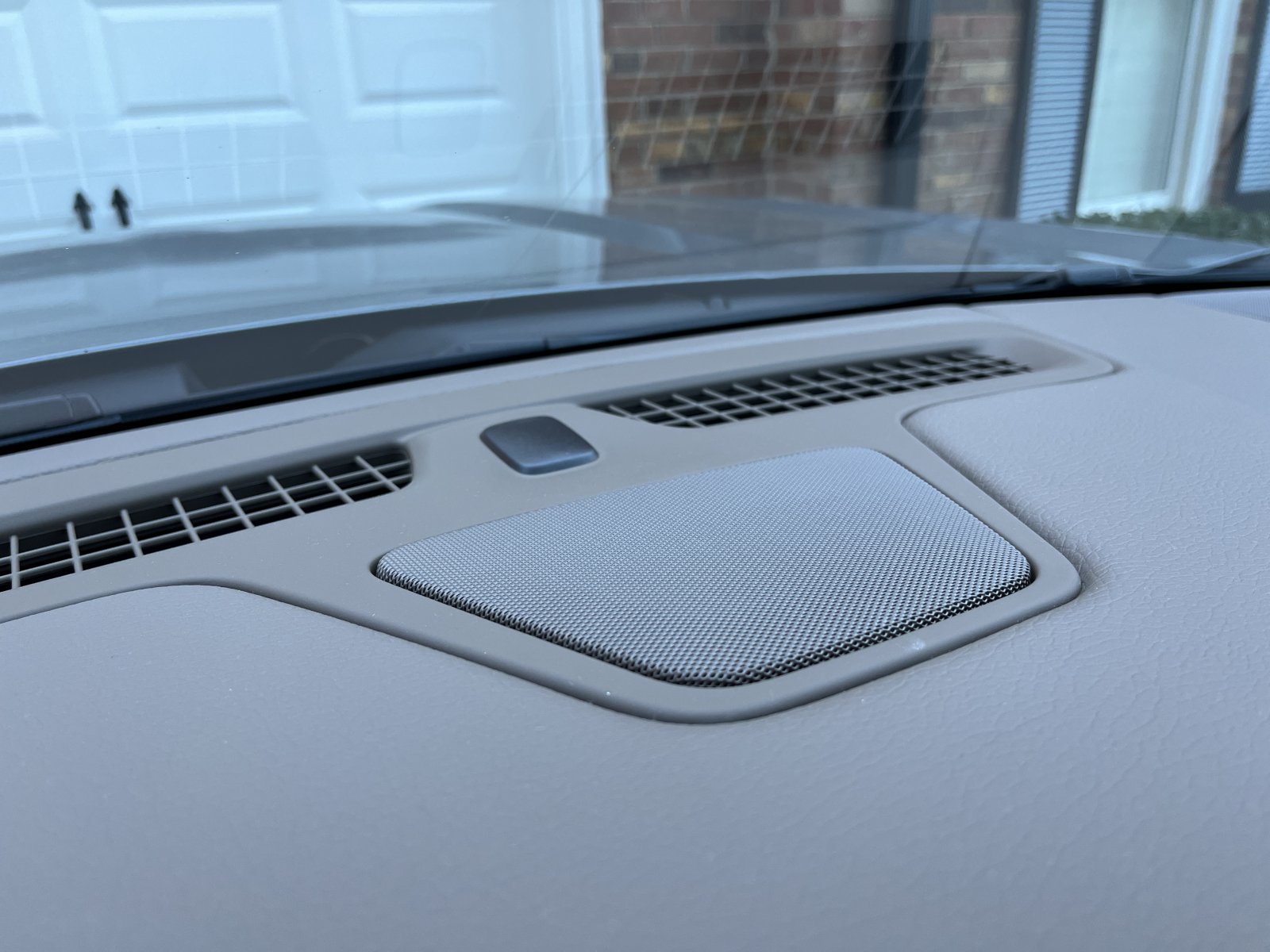

Just to confirm… you’re referring to the entire plastic piece that contains the defrost vents and goes around the speaker?
Thank you for posting this picture. I was going to do the same thing to confirm the piece that actually comes off. Before I start trying to remove a piece that shouldn’t be removed!

Yes, to confirm, I'm referencing removal of the entire "t-shaped" piece that contains the defrost vents, speaker grill, and light sensor. I started on the passenger side, right of the center channel speaker grill (on the trim piece itself, not the speaker grill itself, the grill is attached to the larger trim piece that we are removing).
I've done it twice. Use the right tools. That skin wedge is amazing. Work your way around and lift to find where the clips insert, obviously, the insertions being where your pressure needs to be. Be gentle but assertive and it will work.
