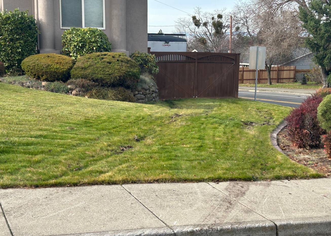

Yep, that's what I'm finding out. I pull a 5500lb trailer over my front lawn out to the street. I have a 'grass driveway' with 9" stone and those plastic grids with 1-2" dirt/grass on top. Slight uphill to the street.
Normally I just 2WD over the grass to the street but due to tons of rain, the left rear tire slipped in the grass->mud and I wasn't moving. Put in 4WD-Low and slipping (left rear) tire spun a bit -> 'clunky engage' -> more clunks -> general spinning / could not move forward and tore up the grass a bit more.
Put in 4WD-Hi and pulled right across the lawn to the street.
I don't understand 4WD-Low as it seemed (to the inexperienced! here) that it would be the preferred way to power forward at 2mph over a short distance with the trailer in tow.

**Disclaimer** I’m not a professional off-roader but have done it a time or two. More than a dirt trail. Less than the Rubicon trail.
4-Low should be operated in a locked gear ratio too. I’ve used it twice in my Sub and I pull the gear lever all the way down and lock it into gear 1. IF I need it I will allow second.
My Land Cruiser has the ability to lock 1st or 2nd gear which is super helpful but the GM selector only locks out the highest gear. That might be the “cluck” you felt because 4-low gear changes have a ton of torque in them when shifting.

There is an "auto" 4wd setting that would probably work well for what you describe. Pretty much the only time I throw my truck in 4 low is when I'm in mud. It also turns off traction control which is probably why you felt a wheel slipping like you describe.
