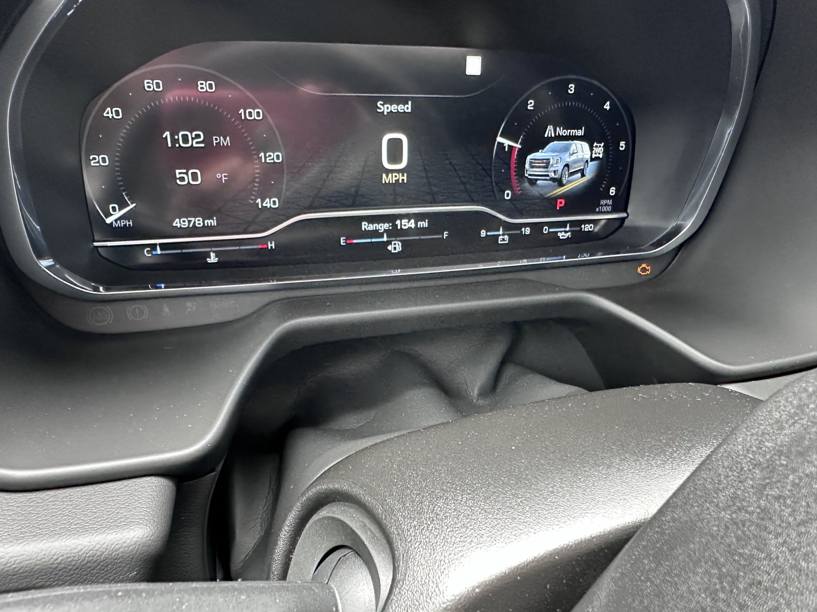

2023 Yukon less than 5000 miles same issues. Dealer has been great and given me a loaner but going on week 3 with no timeline for a new injector. Definitely a known problem. GM is lying and I don’t trust this vehicle. This is my 5th Yukon and a huge disappointment. The dealers are frustrated the customer is frustrated and I’m thinking of pulling the lemon law and going to a Ford.

ateas30
Apr 17, 2023
I have a brand new 2023 Tahoe with 2400 miles on it. Currently at dealership but not sure if they can reproduce issue. Here is what’s going on, I have found if you drive it, park it for about 15 minutes and get back in to drive again, the car comes up and says service engine and transmission, traction control unavailable and forward collision unavailable please service, check engine light comes on and it will flash if you drive it and get no power out of Tahoe, engine is running really rough feels like it’s going to blow up and I got the codes from OnStar code P0204 and P0300. If you shut off the vehicle after this happens and leave it for a couple of hours and go to drive it drives like brand new again, but if you shut off and leave for about 15 minutes and go to drive again same thing and same process to reset/fix. Has anyone seen anything like this? 2023 Chevy Tahoe LT, 5.3 with 4WD
I’m having similar issues with my 2023 Tahoe High Country… 4400 miles now. the only thing mine is doing however is check engine light flashes for a few miles and then quits. This is the second time it’s happened, both times it’s gone to the dealership… first time they told me it was bad gas, and to continue driving it. Second time, I just got it back and they supposedly reset some codes and want me to continue to drive it. I’m furious and do not trust it at all after reading all these posts.
