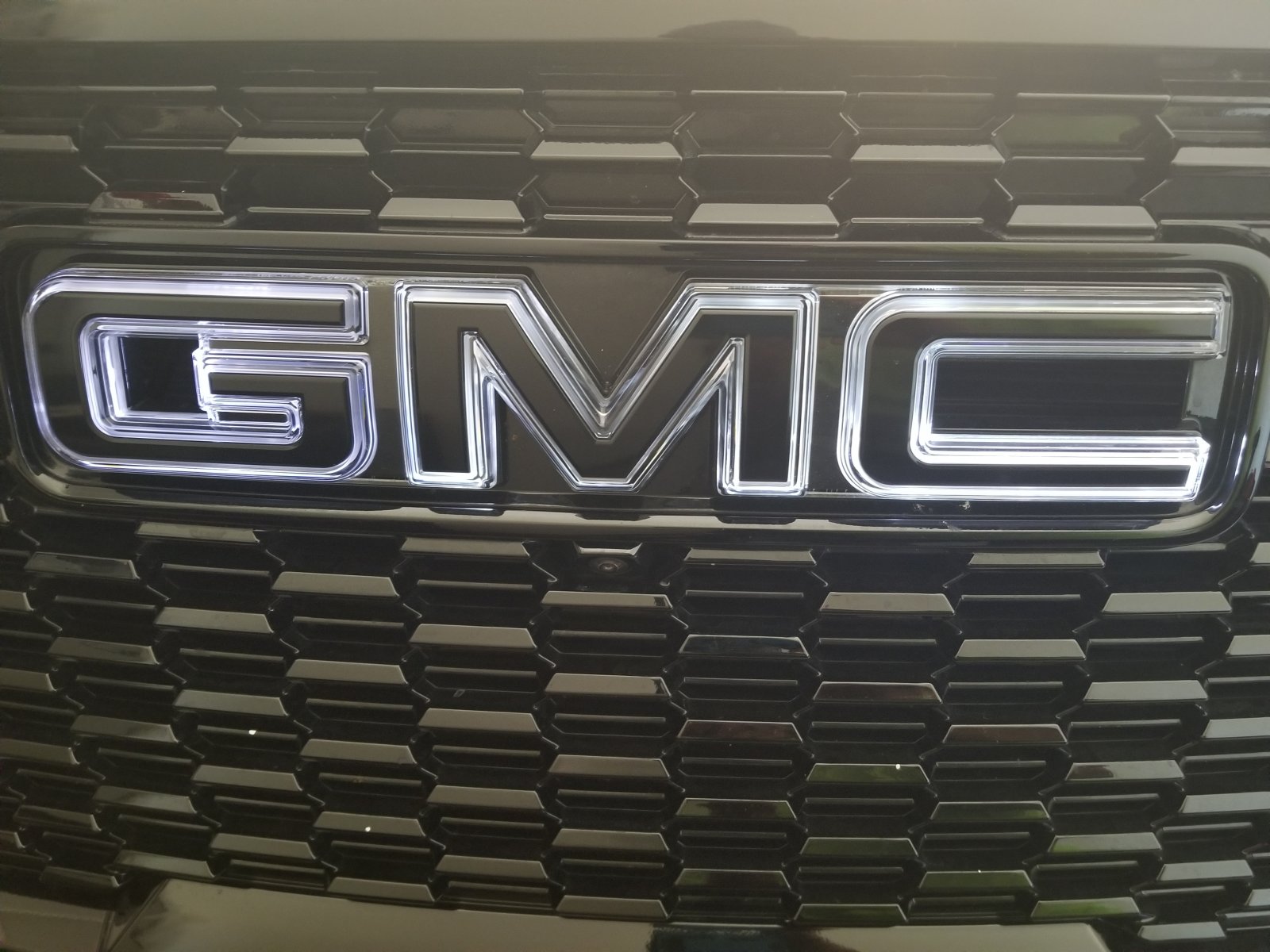

Can you tell me when illuminated are your letters illuminated completely all around equally? Mine shine brightly at the bottoms of the letters but not the tops. I’m trying to determine if I have a defective emblem or not.
I’ll have to check closer tomorrow. I didn’t take it out tonight but from my memory, it looked super even top and bottom, our Sierra HD emblem was very even as well. Does a picture show your issue?

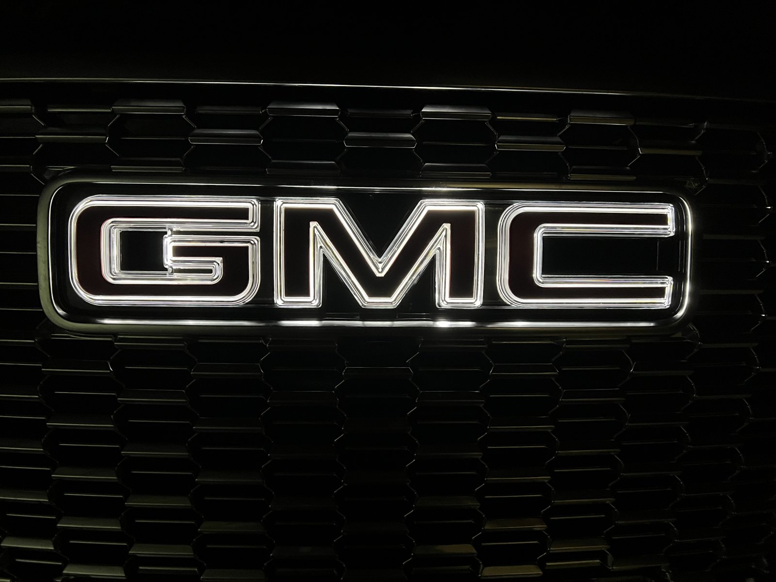

Here's a picture, the G doesn't look bad but the middle of the M and the top of the C look like they are missing some illumination or bad bulbs.

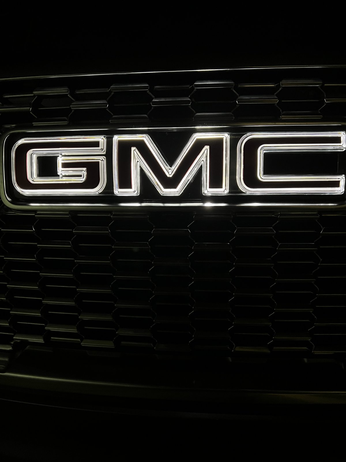

Mine looks pretty damn even. Sorry for the delay had to wait for night time to get a proper shot.
Ya, Mine doesn't look that good. I'll bring it up to my dealer next time its in...Thank you.

Got mine replaced finally under warranty. Just one of many parts that are practically nonexistent to get. Only 27 Black pieces left in the country as of yesterday and under restricted distribution to new vehicles only. My dealer somehow managed to wrench one loose.
