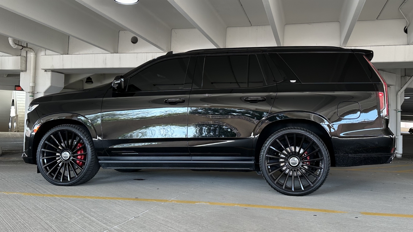

Just got a 22 Escalade Sport Platinum. The air suspension raises by itself when driving and stays raised until you slow back down or park.
How do I keep it low while driving? It looks SO much better low.

How much does it raise from there when you drive it?

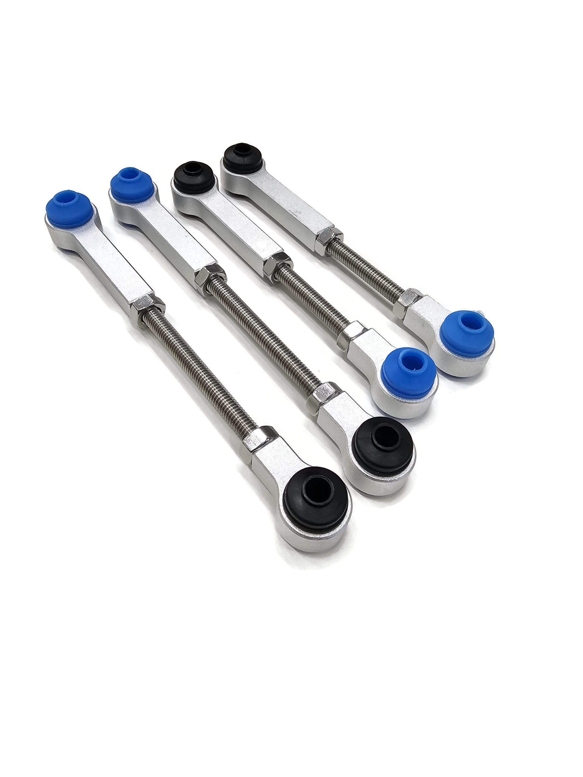

It raises the same amount as stock, it just starts from a lower height.
I had mine roughly set so that the high setting was close to the oe low setting, and then it dropped more for access height when parked.
They're adjustable so it's really a matter of how much you want to go given that ride quality suffers the lower you go cause you're giving up play in the suspension.

Did you re-align when you installed the links? Any abnormal tire wear or rubbing? I have 26's

Yes they did an alignment. No rubbing on 24s, can't speak on 26s but I don't see why they would rub as long as you've kept close to the oem geometry. Didn't keep the truck long enough to know about uneven wear, but that shouldn't be a thing if aligned correctly.
