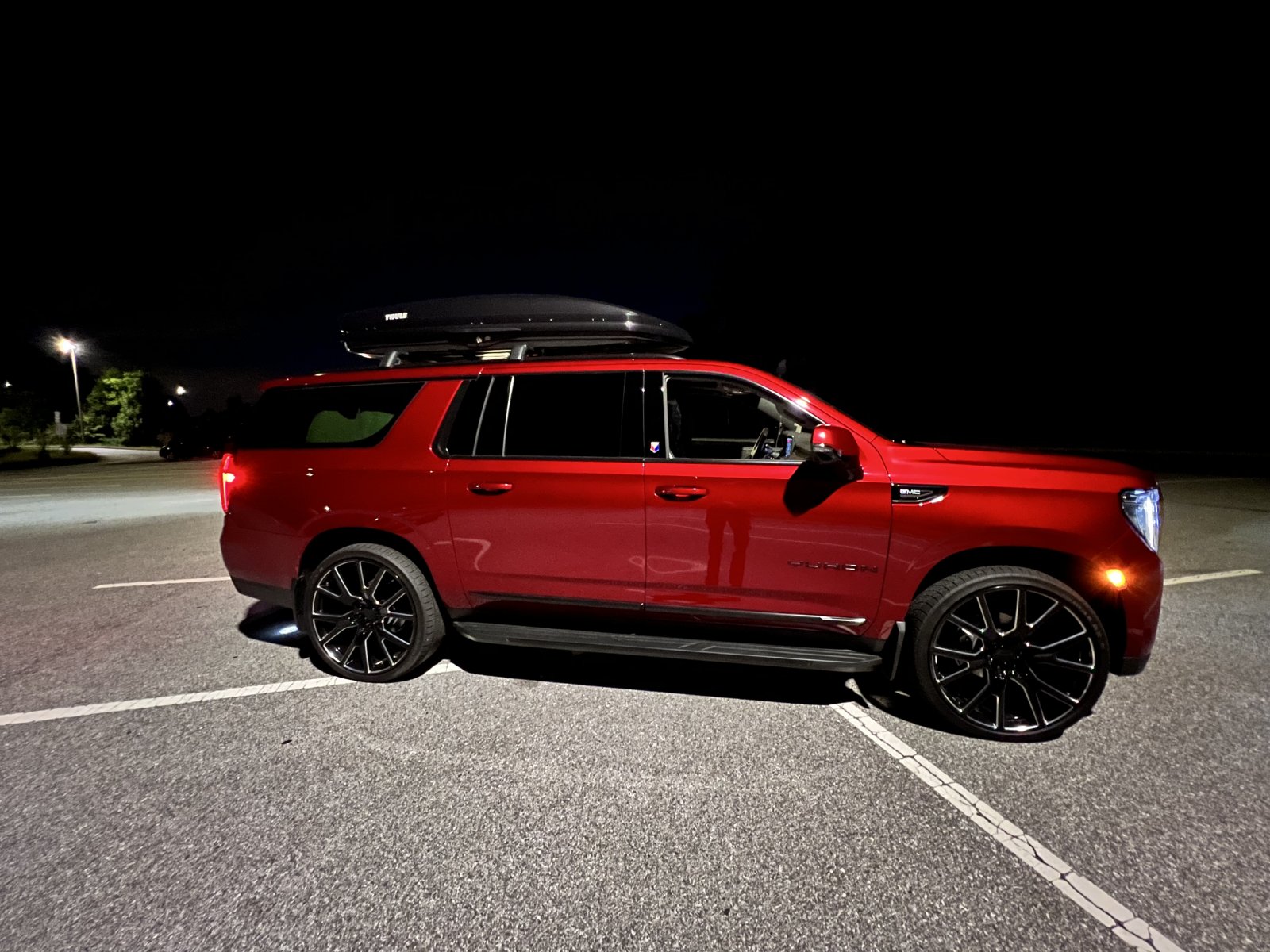

My big baby. Would hate to let her go over reliability issues.
