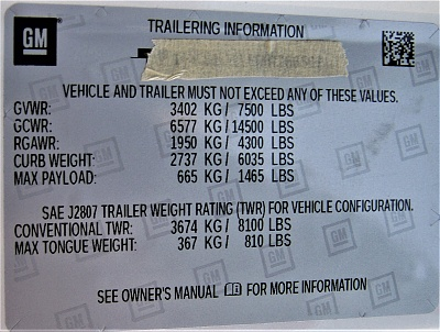

Actually, let's take some numbers and figure out this weight distribution when loaded.
I believe the Z06 comes with stickier tires from the factory and would, thus, be able to transfer a bit more weight to the front under braking.
The static weight distribution of the C8 platform is about 40:60. I wouldn't be surprised if it's dynamic weight distribution could be 60:40 under threshold braking.
A front engine rear wheel drive vehicle might be closer to a static weight distribution of 50:50 and experience a weight distribution of 70:30 under threshold braking.
If you look at the brake specifications for 1 ton SRW HD pickups, you'll see that the Ram 3500, Silverado/Sierra 3500, and Ford F350 all have very similar brake rotor diameters. The variance is at most .2 inches. In fact, in the gas motor (non diesel) 1 ton HD pickup configurations, you could see a static weight distribution of 35:65 when loaded.
In a dually diesel configuration, that weight distribution would be even more extreme when loaded and it would make sense that the exhaust braking is applied to the rear axle. You wouldn't want that braking force to be applied to the front axle instead of the rear axle.
When loaded from either payload and/or trailering, what do you think the weight distribution of the SUV would be between the front and rear axles?
I've used a trailering sticker for a 2022 Yukon XL Denali from this site:
GVWR = 7500 lbs
Curb weight = 6035lbs
Payload = 1465lbs
RGAWR = 4300lbs
GVWR - RGAWR = Front Gross Axle Weight Rating
7500 lbs - 4300 lbs = 3200 lbs
Front Gross Axle Weight Rating = 3200lbs
Rear Gross Axle Weight Rating = 4300lbs
Static weight distribution = (FGAWR / GVWR) : (RGAWR / GVWR)
(3200lbs/7500lbs) : (4300lbs/7500lbs)
With a fully loaded 2022 GMC Yukon XL Denali:
Static weight distribution = 43:57
Now I looked up the factory brake specifications for the vehicle and this website says the following:
Brake​
Front brake diameter13.5
Front brake typeventilated disc
Front brake width1.18
Rear brake diameter13.6
Rear brake typeventilated disc
Rear brake width0.79
