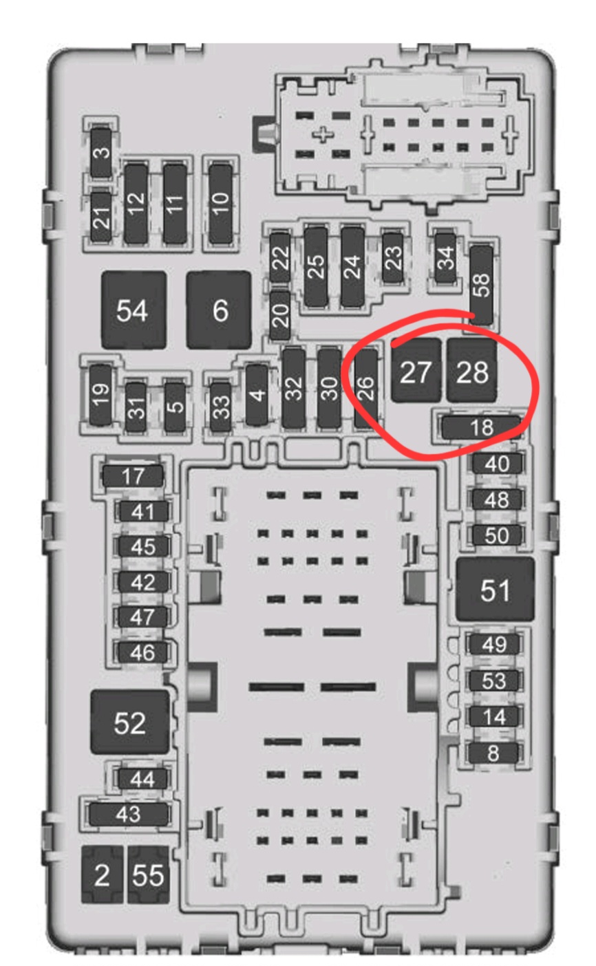

Found it!
I tested it on my Yukon and it works.
I moved the fuse over in the panel and it powers my accessories while the truck is off.
There is one big fuse "50" in the 27/28 slot.
Move it to slot 28 for constant power.
Move it to slot 27 for ignition only power.
*Edit: Forgot to mention - this is the passenger side fuse panel
