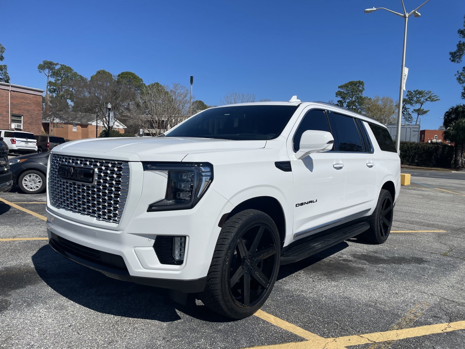

I just got a 2021 Yukon XL Denali 3.0 with 3K miles. Went to crank and started receiving numerous messages on the dash. Forward collision system unavailable, service ESC, reduced acceleration drive with care, and service traction control. I then received a text to service engine and transmission within a day from on star. Any ideas on what this could be? I’m not happy right now.

Sorry to hear you’re experiencing this. What’s crazy is, that barrage of error messages you mentioned are what many of us have experienced when lifters have failed. I’m not mechanically inclined at all but I assumed that the diesel and gas engines don’t share much of the same technology like DFM/AFM, so I wonder if that’s just a generic engine error message response with our new Tahoe/Yukons. Keep us posted on what service ends up figuring out what the issue is. Hopefully they’ll get you back on the road real quick.
**By the way, your Denali looks slick AF. Love the mix of black and white chrome delete.

I had this happen on a 2017 F250 the first year of the updated trick, was in the shop 7 times and in the end it was the main wiring harness and something had to be recalibrated. It was braking by itself with no vehicles in front of me , it was crazy, had every error message imaginable and in the end it was something pretty basic. Glad your Denali is running strong . Btw it looks very very good, probably the best one I’ve ever seen.
