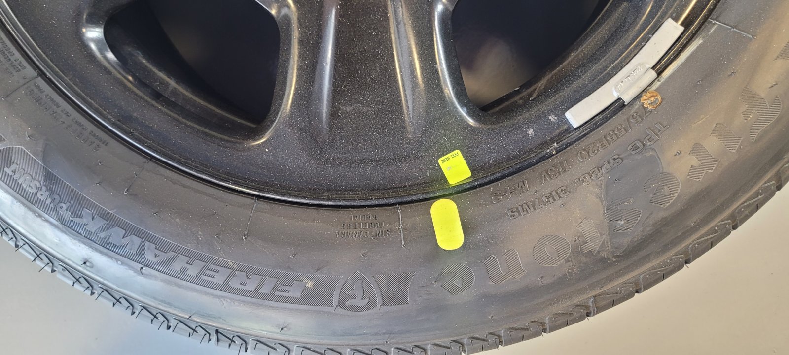

The stock tire on the 21 and PPV Tahoe is a 275/55r20 Firestone Firehawk police. We have already wore those out on our 21's and replaced them with a Goodyear. I can not recall the model but I will try and write it down when I go back to work on Monday. I can take a ciuple of pics then also.

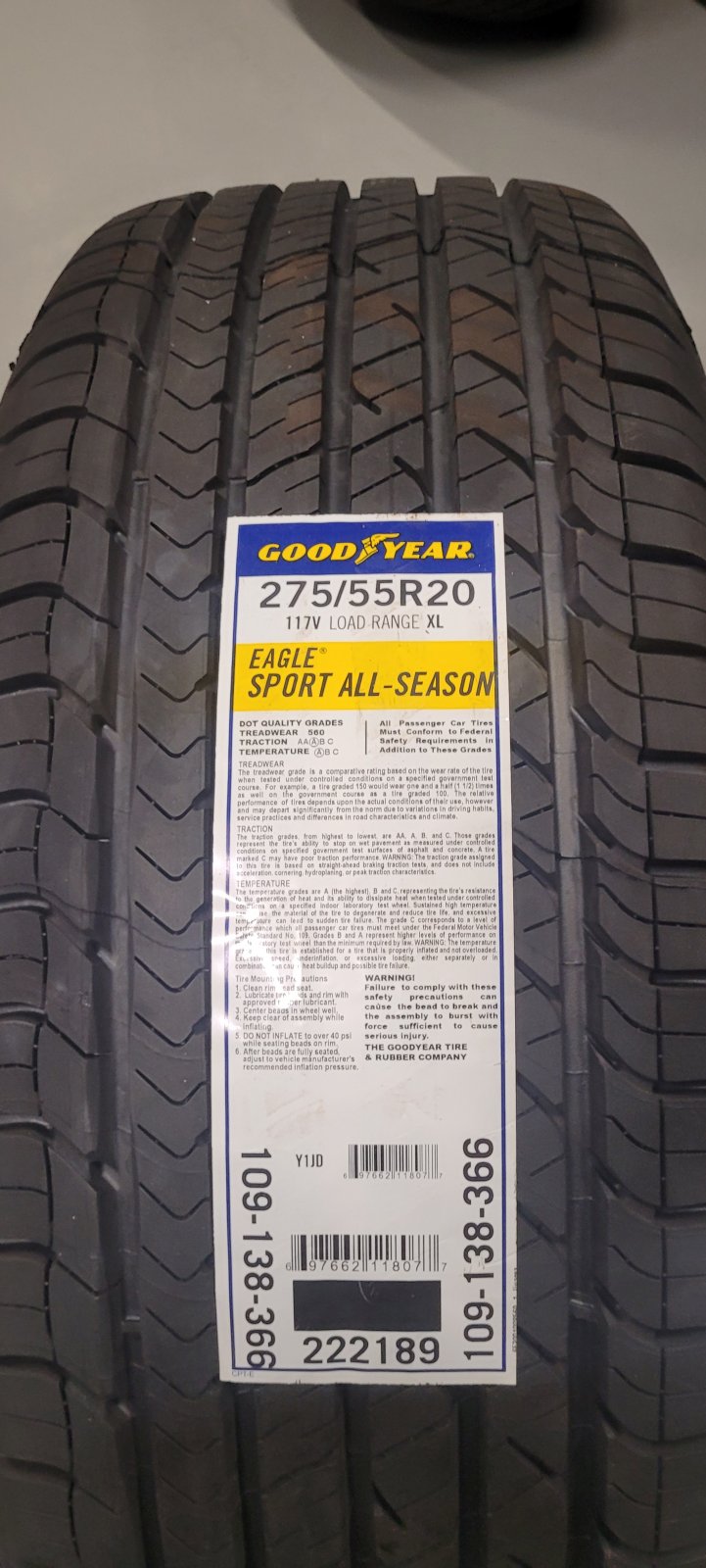

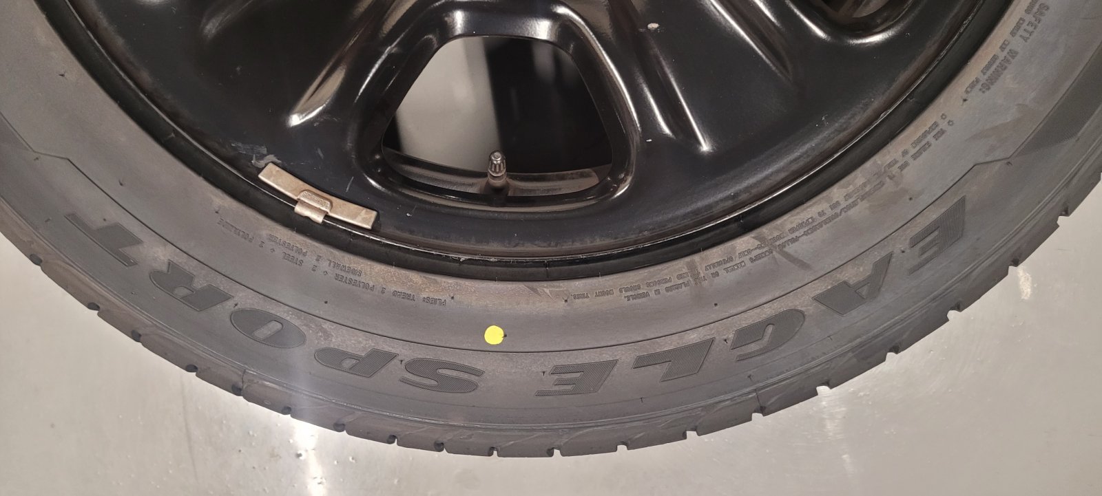

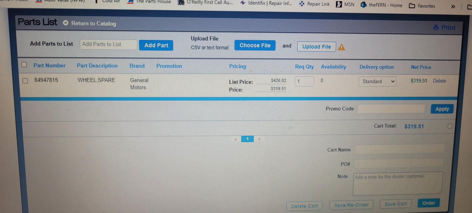

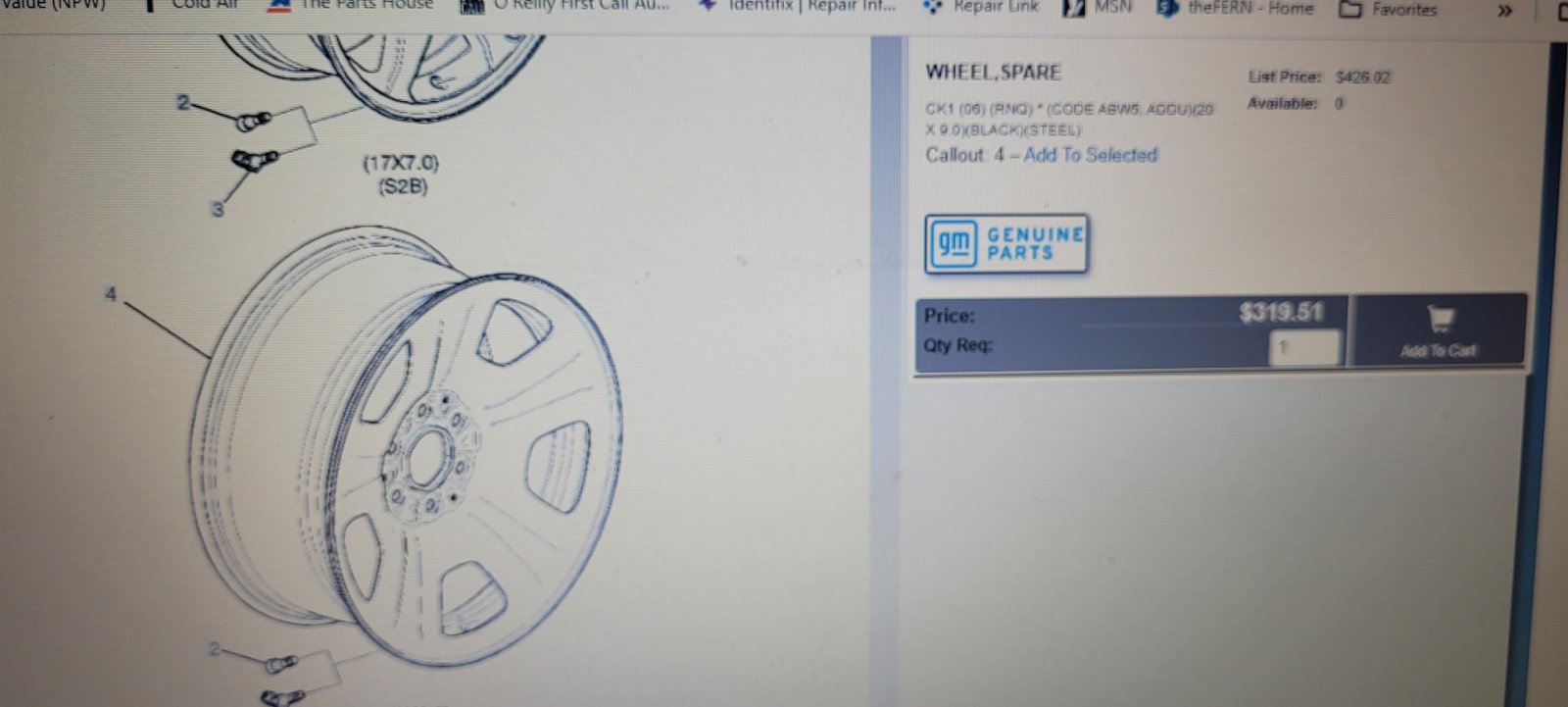

Ok the part number for the 21+ tahoe ppv steel wheel is 84947815 list price is $426.02.
The ppv tire that came on our tahoes is a 275/55r20 Firestone Firehawk Pursuit. As they wear out we replace with a Goodyear Eagle Sport. This is the tire my goodyear rep sells all of the local pd agencies for the tahoes.
