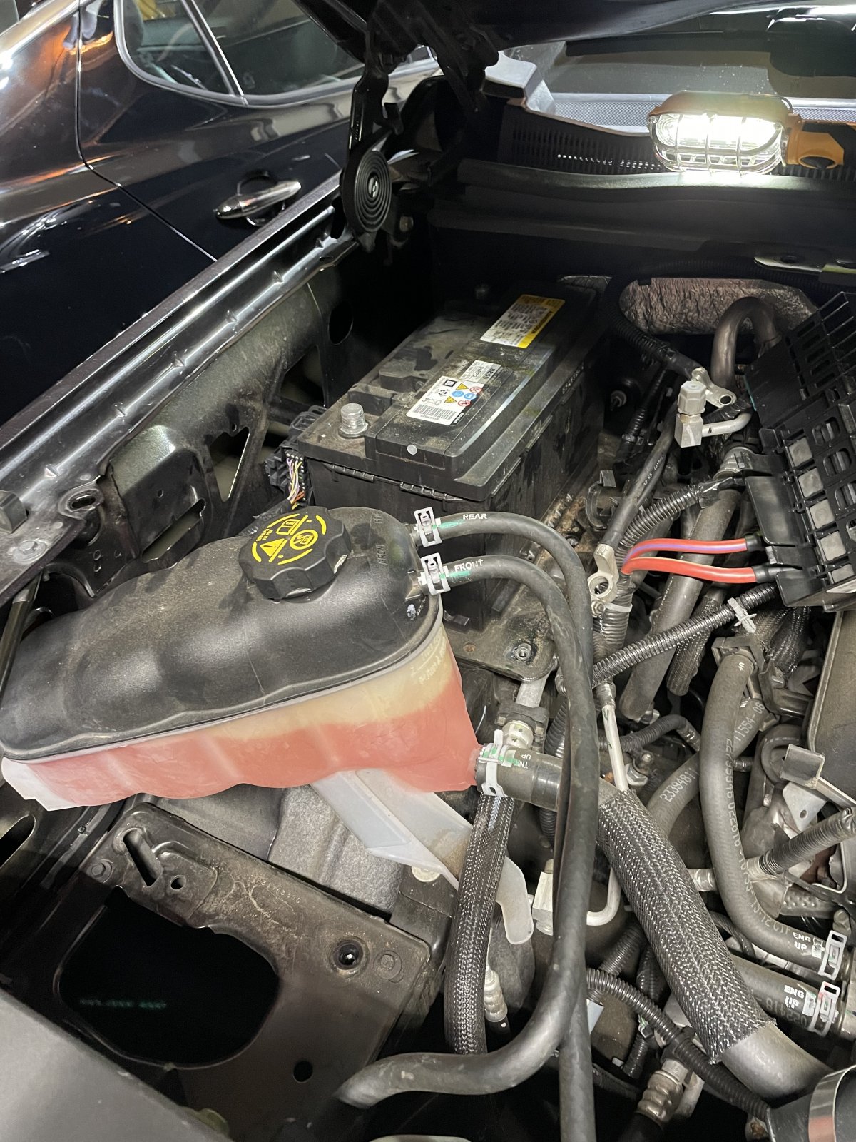

Mine died today. 3.5 years old 43k miles. Mostly town driving with lots of starts.
Bob2C
Jun 11, 2019
532
435
Northern VA
What a pain to replace. It’s not hard just have to remove some stuff. Took about 20 min for removal and about 10 min for the install. What happened to a simple battery swap where the only bolt to remove was the hold down?
