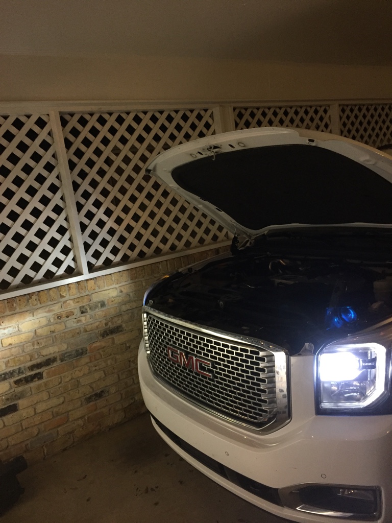

I converted my SLT’s headlights. I swapped in factory Denali HID headlight assemblies. I made a harness to address the pulsed voltage that’s sent to the low beam on halogen equipped models. Instead of using the factory 4300K HID bulb, I went with the Osram CBI. They’re 5000-5500K and match the LEDs on the vehicle.
Sent from my iPad using Tapatalk
how you did that? how you did a harness?
SnoWhtYukon
Jul 1, 2022
Maryland
@cmatt, do you sell the harness that you made for the HID conversion?
