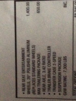

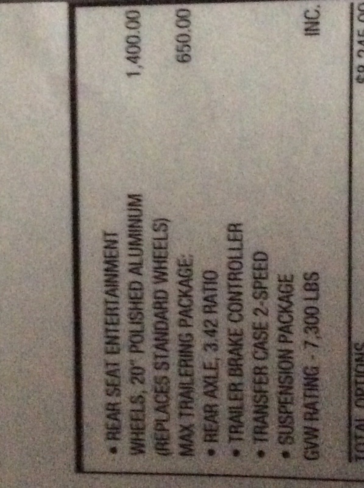

The OP said HD towing package [Z82], not MAX [NHT], if that changes the comparison.
FWIW I know they are out there but I shop for used Tahoes/Yukons almost continuously and have never seen one w/ the MAX package.
You are looking for love in all the wrong places...
This is NHT...
Here is sticker (RPO code in glovebox is NHT)

If one orders the Max Tow Package then they must want a real tow beast. So why the 3.42?
This discussion got off track and ended up Max Tow vs. Z71 when the O.P. asked about HD Tow vs. Z71; that is what I meant.
