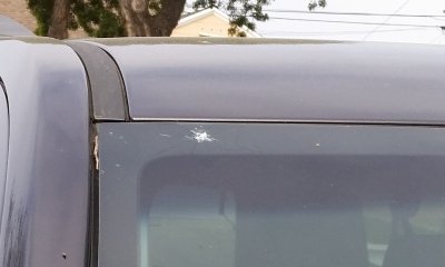

I experienced a massive shatter/cracking in my windshield when my 2015 was a little over a month old. Driving down one of our more notorious freeways, something struck the windshield, which sounded like a .50 cal striking armor plating (THUMP!). The wife was sitting on the passenger side and both of us jumped, (she had her sun visor tilted down) but we saw nothing. It was a mystery and I said, "How did that not shatter the windshield? Whatever that was".
Once we got home and she climbed out, I put her visor up and saw the impact, something struck the windshield right at the upper edge, where it meets the body.At the velocity I was traveling (75+/-), that object, had it hit an inch or two lower, there's little doubt it would have gone right through the windshield and probably struck her in the face, neck or chest, killing her.
I had no idea what it was, if it was a rock tossed up by a tire, or if someone tossed something off the overpass we were crossing under, but it left a Quarter-sized impact on the glass and spider web cracks radiating outward.

Cracked windshields are a part of life here in Colorado. They are most likely to happen when there's a compromise near the edge of the windshield, where the flex is most pronounced. I have a nice-sized star about 1/3 down from the top on the passenger side right now that I haven't had time to fill, but (knock wood) it's not getting any larger. Other hand, you can have an almost imperceptible ding in your windshield at the edge, and it will spread with as little as a temperature change.

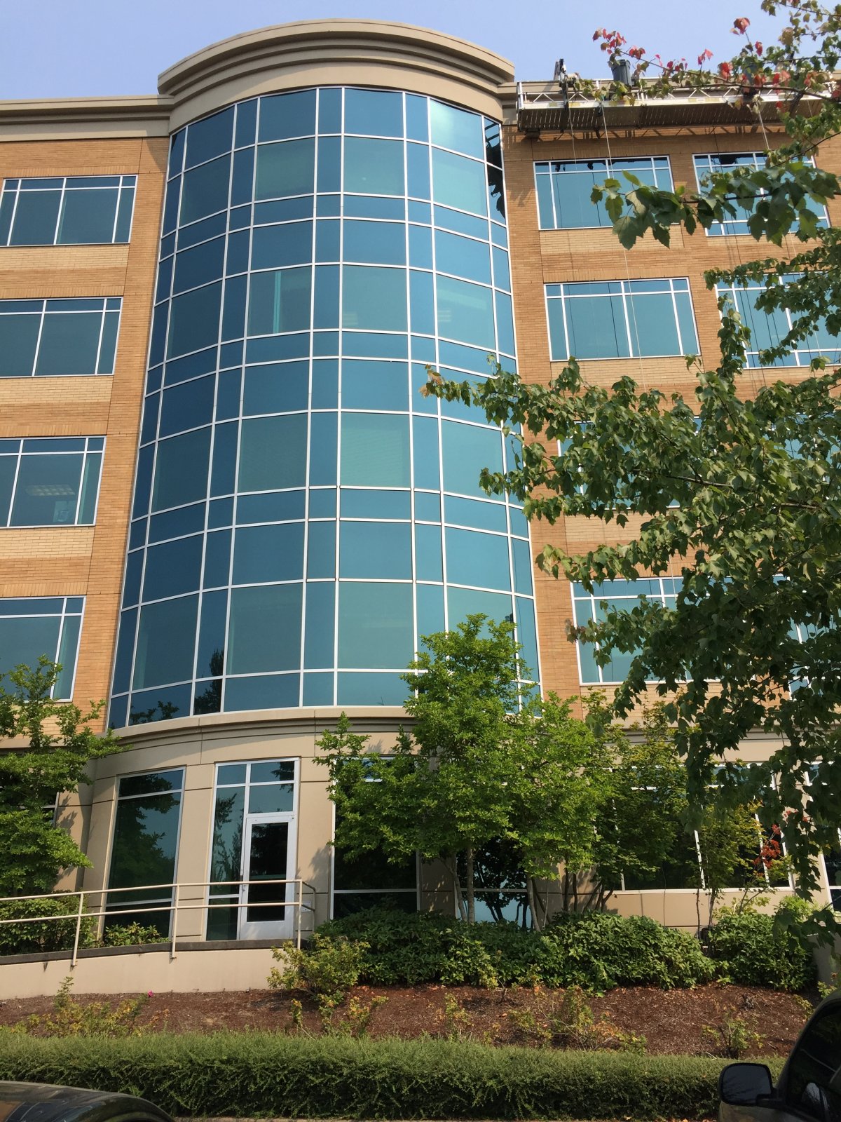

For what it’s worth, I’ve been in the glass business most my life. Laminated glass which is what a windshield is, (as opposed to tempered glass like the doors and rear glass in today’s US vehicles) is made up of 2 very thin layers of annealed ( non- tempered) glass with a layer of plastic in the middle. Those 2 layers of glass are a little over 1/16” thick, and the edges are their weakest point. It’s super easy to crack one of those layers. When we are installing 1/4” laminated flat glass we make sure to seam (sand) the edges good after cutting it to size because even a tiny rough spot at the edge will most likely cause a crack when we install it and push on the edge to seat it. So just imagine taking a piece of regular annealed 1/16” glass and how easy it would be to crack it if you hit the edge. In the center it’s much harder to start a crack so a lot of times an impact leaves a divot instead while if the happens at the edge it starts a crack. In Europe their windshields are tempered due to different safety laws so they don’t get cracked windshields but if there’s an impact sufficient to break the tempered glass, it’s terrible because you have thousands of tiny pieces of glass in your face and the windshield is completely gone. This is especially bad if it happens at high speed.
