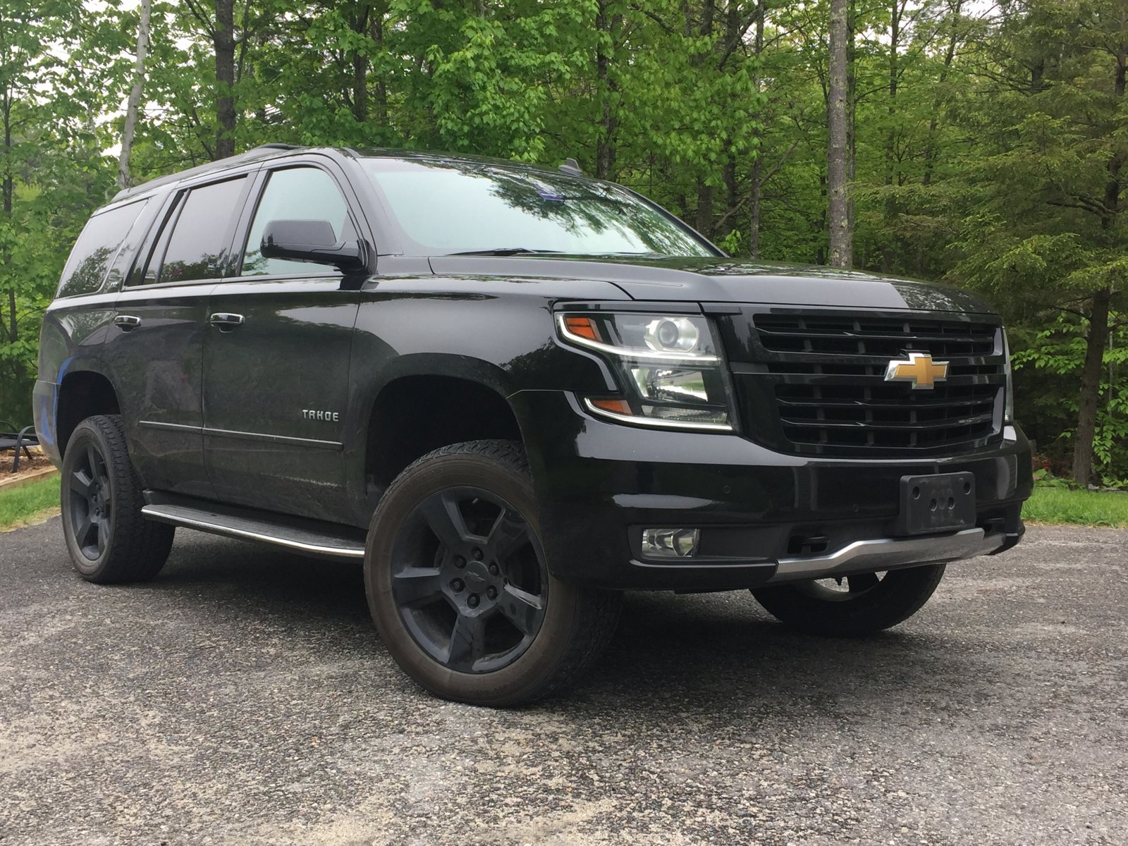

Check out @Xineering's GM Shock Sims - this circuitry allows you to "delete" the MRC and put on any passive shock/strut/coilover front & rear combo you want to run on your truck. The kit for all 4 corners is around $425. Then you can start looking at any lift kit that would fit on a "non-premier" Tahoe.
I just had the Xineering circuits installed this week with Fox 2.0 Coilover 2" adjustable lift height assembly in the front and Bilstein 5100 in the rear with a 1" spacer.
I will be making a significant posting soon regarding my entire build and blackout. I own a 2015 Tahoe LTZ that had the magneride on it with the max towing package. Working on purchasing new tires this week. Looking at 295/55R20 or 285/60R20 (both 33" diameter) to go on my OEM Chevy 20" wheels.
BTW - the Fox shocks are SWEET! Just eating up every bump, pothole and dip in the road!

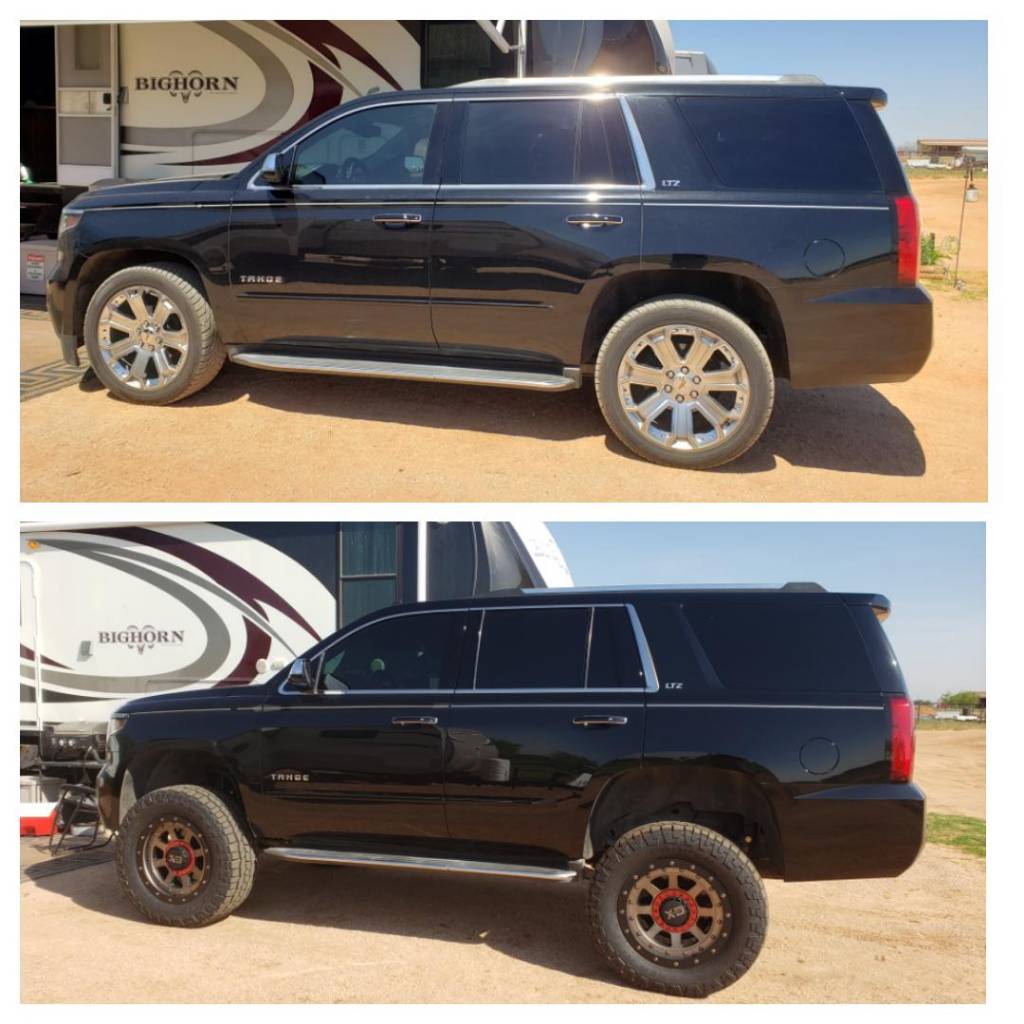

This is my 2015 Tahoe LTZ with magneride and air ride. We went with the BDS 6" combo. They had to order two kits, like you said, and it clears 35x12.50r20. I didnt like the 22's so we went with these XD's. They're zero offset. We removed the lower valance from the bumper and the running board filler/trim pieces so there was no cutting up front for clearance. Two things I'm not happy with:
1. With this lift kit the vehicle maintained the factory 2" rake and BDS doesnt seem to know why, nor the company that installed the lift. Seems I'm stuck with it.
2. I do get some rub when I turn sharp in reverse.
The ride quality overall is still great and we bought the DiabloI3 tuner and reset the tire size, turned off the afm and put a mileage tune in. We get 17.5 to 18 on the highway now.
Sent from my SM-G960U1 using Tapatalk

Sounds terrific w/your custom tuning!
Pictures? Curious about the rake remaining...

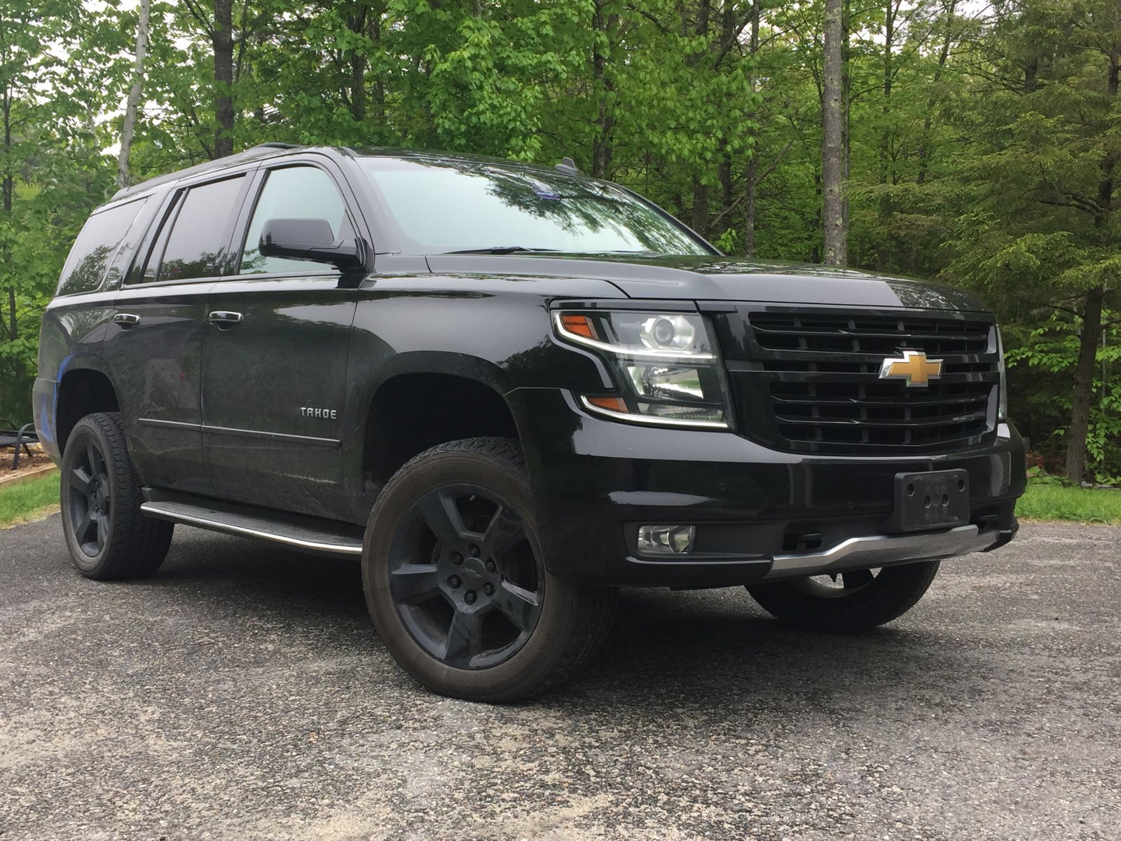

Absolutely sweet ride! Did you install any aftermarket upper control arms ? Did your LtZ come with 20inch wheels as mine came with 22in? Thanks!

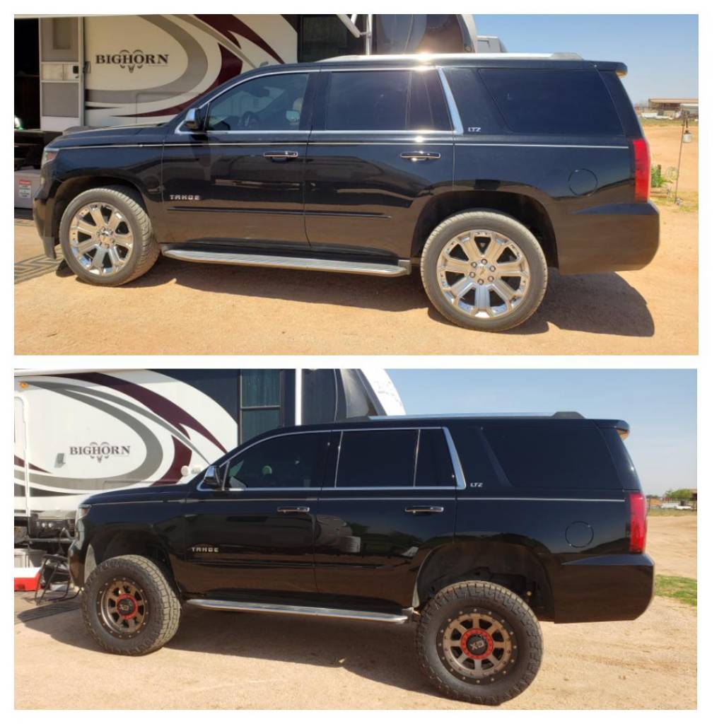

All you got to do is throw a leveling kit under the struts to level it out completely that’s what I did with my 6” fabtech lift
Get alignment checked afterwards but the lower leveling kit is cheap 40-60$ and about 30 min to install it without even having to remove the tires
