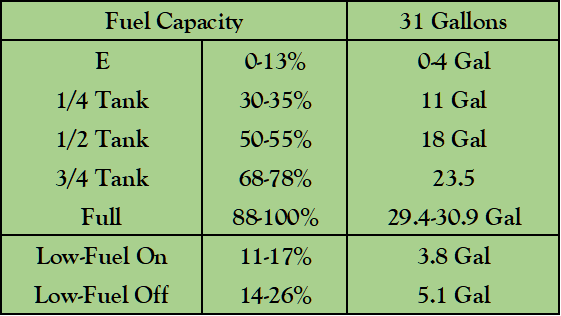

You can see the percentage with a scan tool or phone app. I think he's just not familiar with it. The 25 gallon fill to 3/4 is normal, the time when it showed 1/4 tank after 80 miles of driving was probably all city driving or lots of idling.
