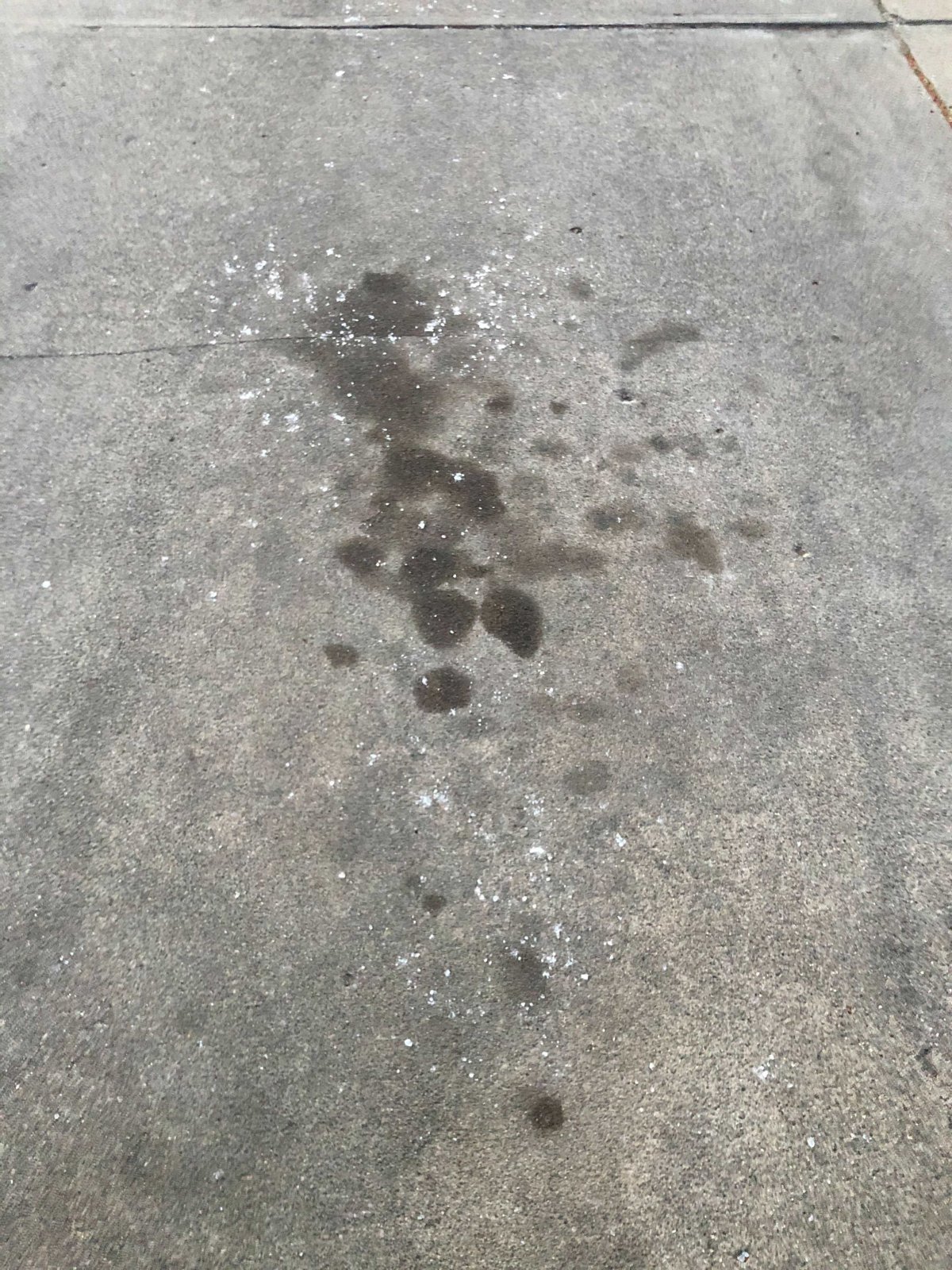

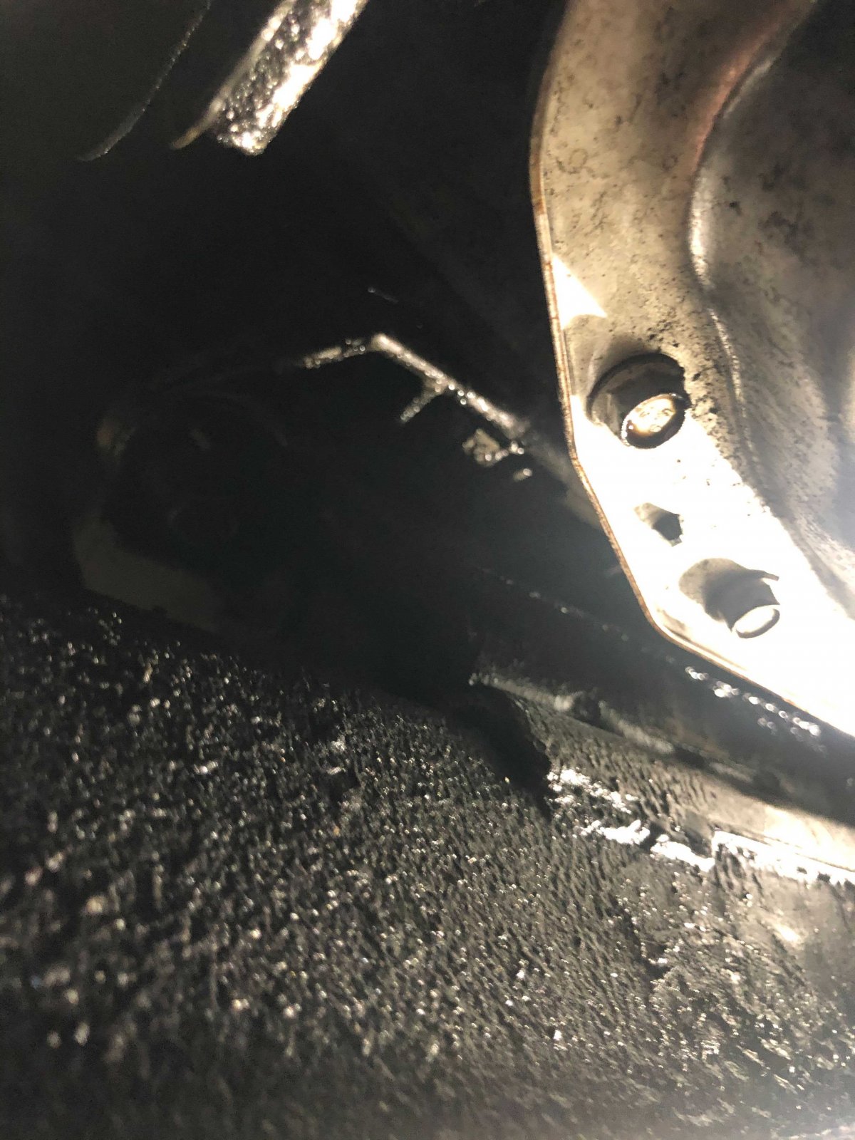

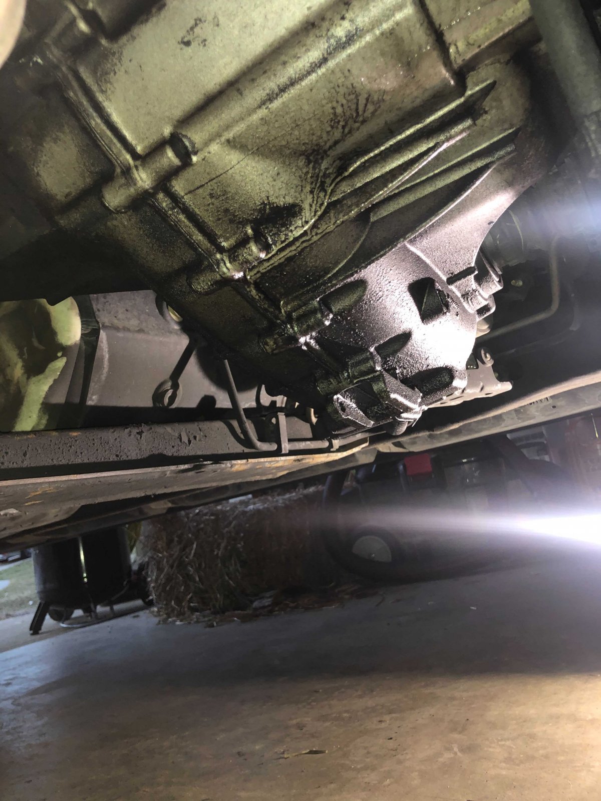

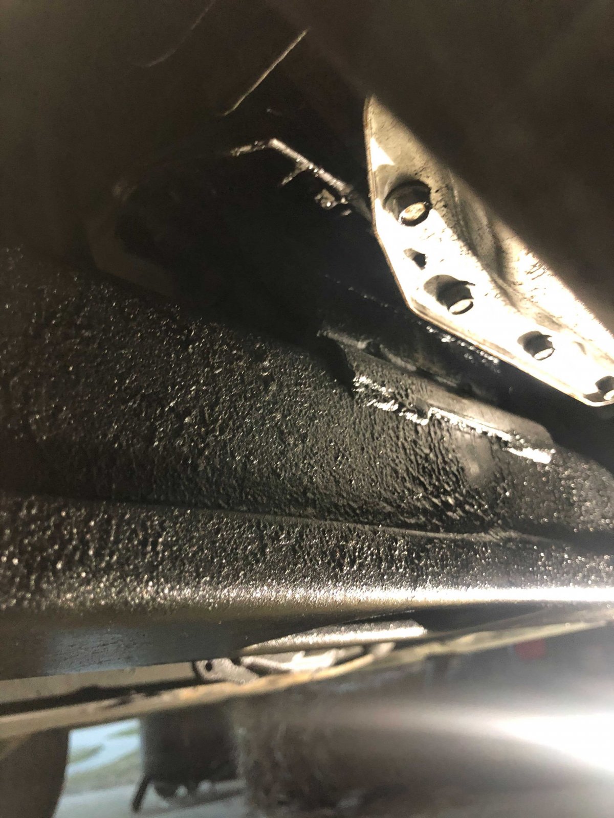

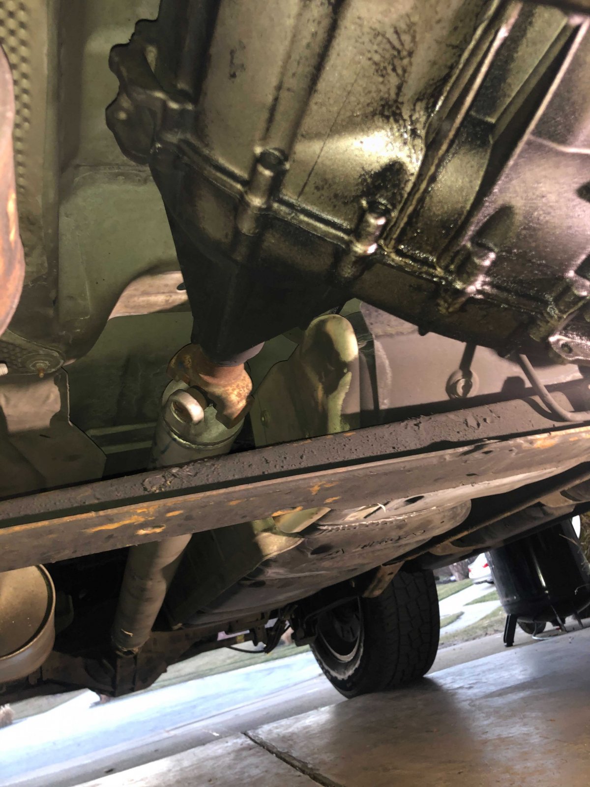

The transmission was changed in autumn. During the winter, I started noticing spots on the driveway. Noting huge, but over time it adds up. When working on an exhaust rattle, I noticed a wet grimy buildup on the frame under the automobile. Could the transmission have a leak from a change in the weather? Or should I be looking somewhere else? I have attached pictures.

Looks like your transfer case has a leak. Often happens when they remove the transmission and do not replace the seal on the TC side. I haven't seen under your hood but on mine it is on the accumulator. Took me a while to find it too!
