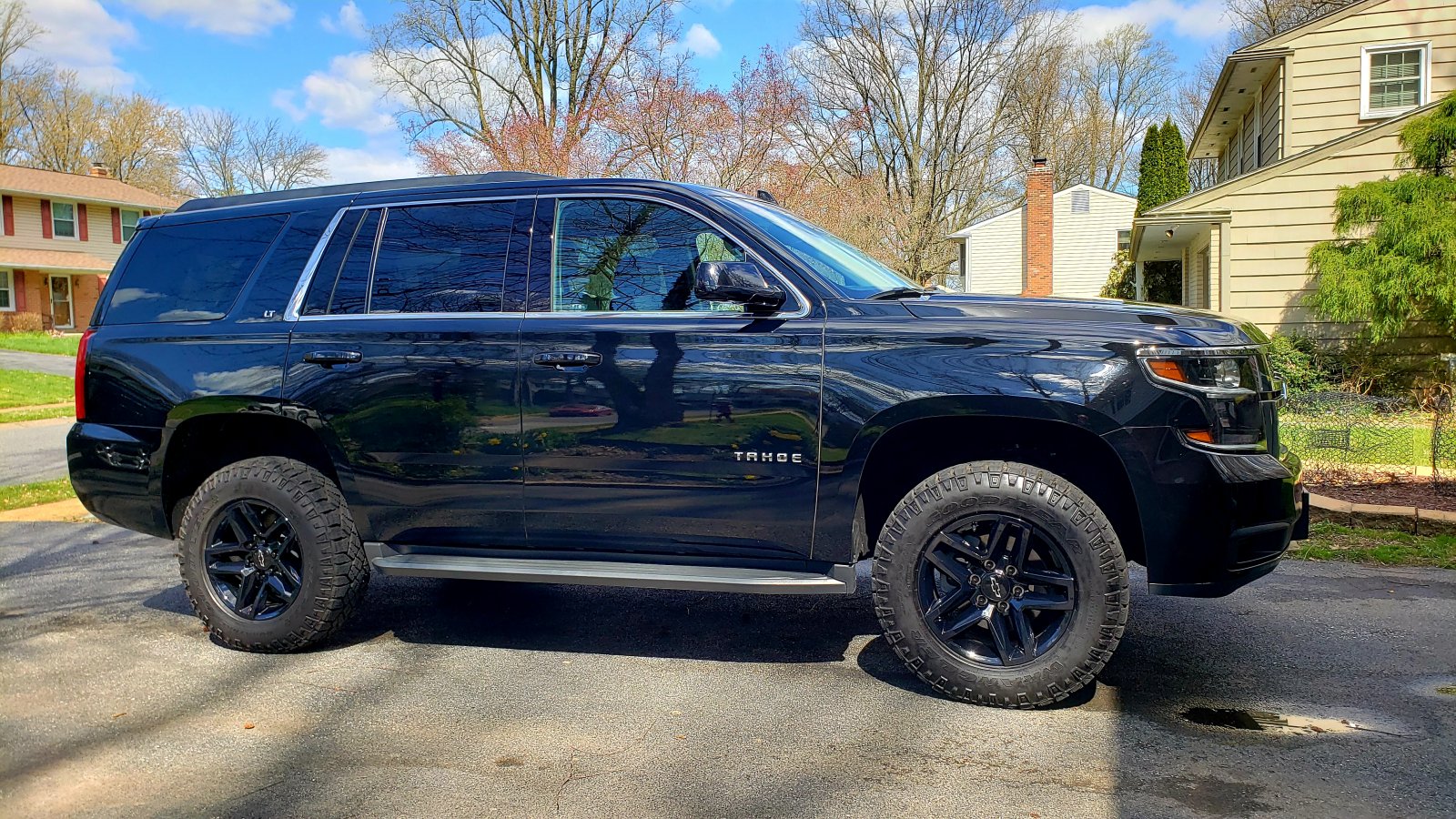

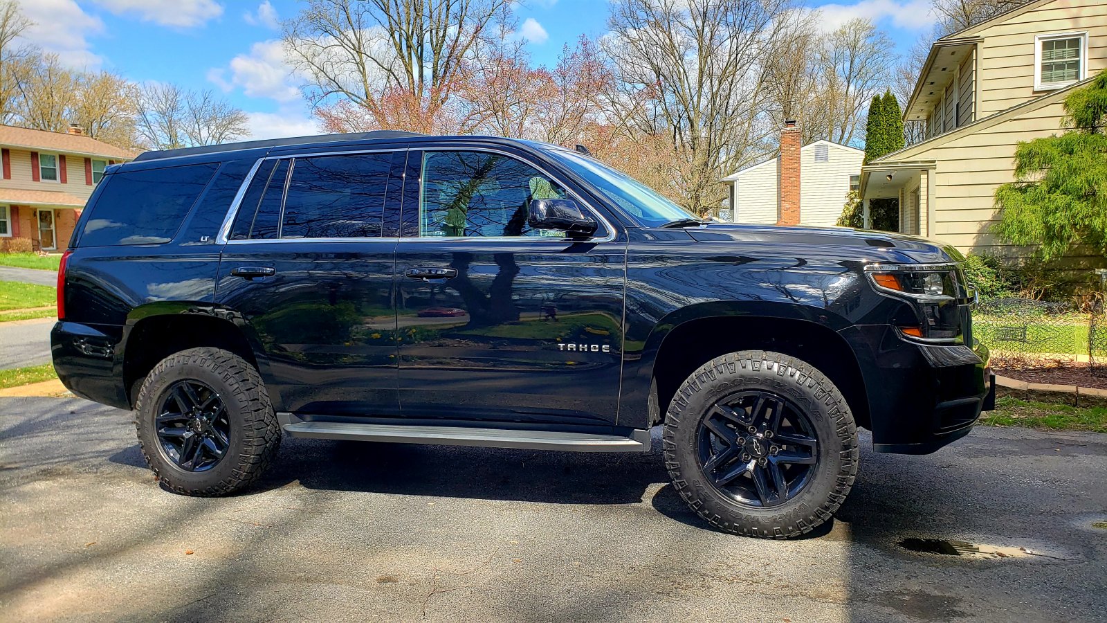

Dont think 285/75 would fit as 275/70 are pushing it. Here are the 275/65/18 ridge grapplers I had - they fit nicely without any rub, but I spend most of my time over 80mph, and these suck over 70. My next tire will be that size, though. Defenders...

Thanks for the reply and pics, very nice looking. I based the tire measurements off custom offset recs so it’s really helpful to see some pictures like these. Do you have a 2 inch leveling kit on there?

Running 275/65/18 on the Trailboss wheels. 2" Rough Country front and 1" spacer out back. they are just big enough to make it look decent. No rubbing at all. Maybe a 285/65/18 would fill a bit more but didnt want to sacrifice the MPG. this size actually put the speedo 100% dead on with my GPS vs Speedo. 265/65s were off by 3mph at 60. Duratracs are a good tire, not obnoxiously loud, but far from quiet.
