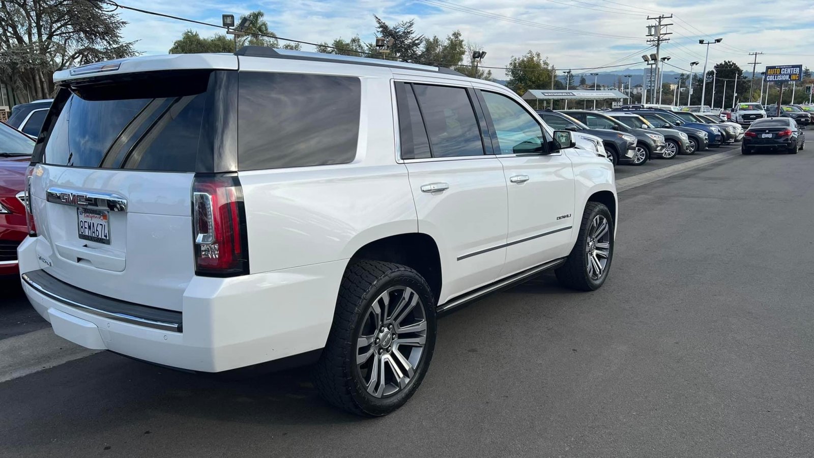

Nothing special currently. Just stock

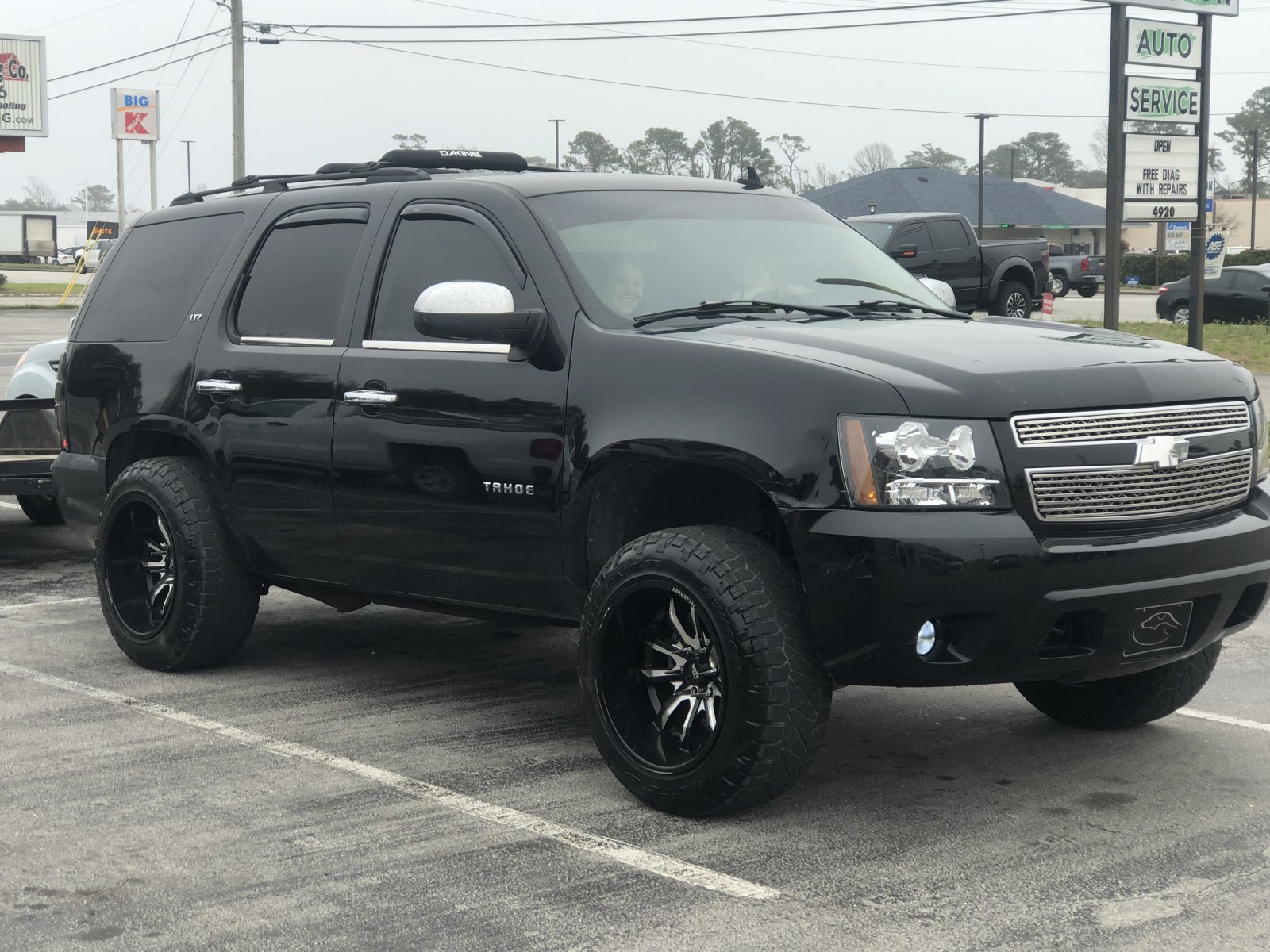

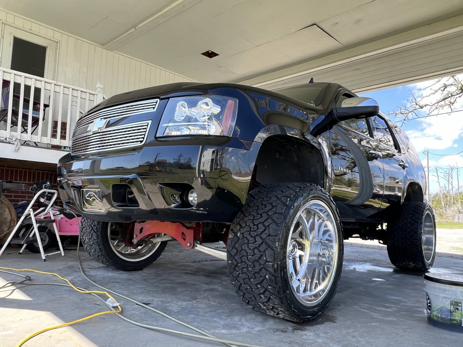

It should be fine. However you may see it as too skinny with the 10 wide wheel once it’s lifted atleast I always have.
Here’s a couple pics of my rigs on X12 wide -44 offset and X14 wides with -76 offset
Even X14 wides with 2” spacers almost equal to X16 wides.
22x14 and 35/12.50 7.5” lift
24x14 and 35/15.50s 8” lift
24x10 with 2” spacers and 33/12.50s
3” lift
20x12 and 33/12.50s 2” lift
22x14 and 37/13.50 2” adapters stacked on top of 2” wheel spacers
Just some real world comparisons of different wheels and tire sizes and widths to give you a better idea
Look on the custom offsets gallery also they have a lot of stuff on there! if people had to trim or not, how much lift was needed, etc
Don’t be scared to trim if you have to. you can do it cleanly where it isn’t noticed and a lot of people have to do it to clear the wheel and tire setup they want to run on these trucks
