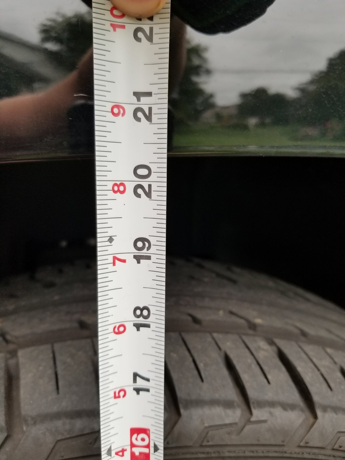

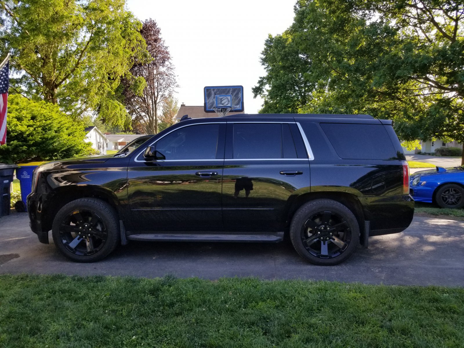

Before and after with the rear springs, shock extenders, and adjusted links.

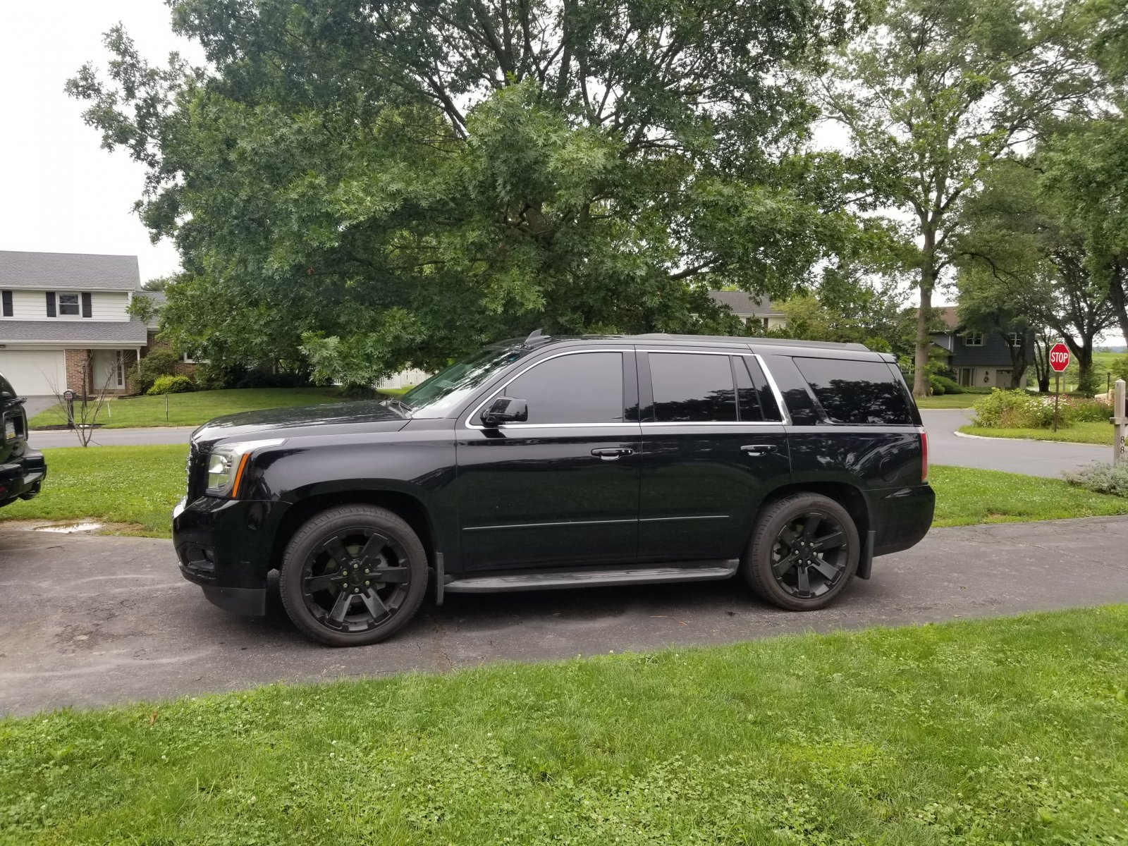

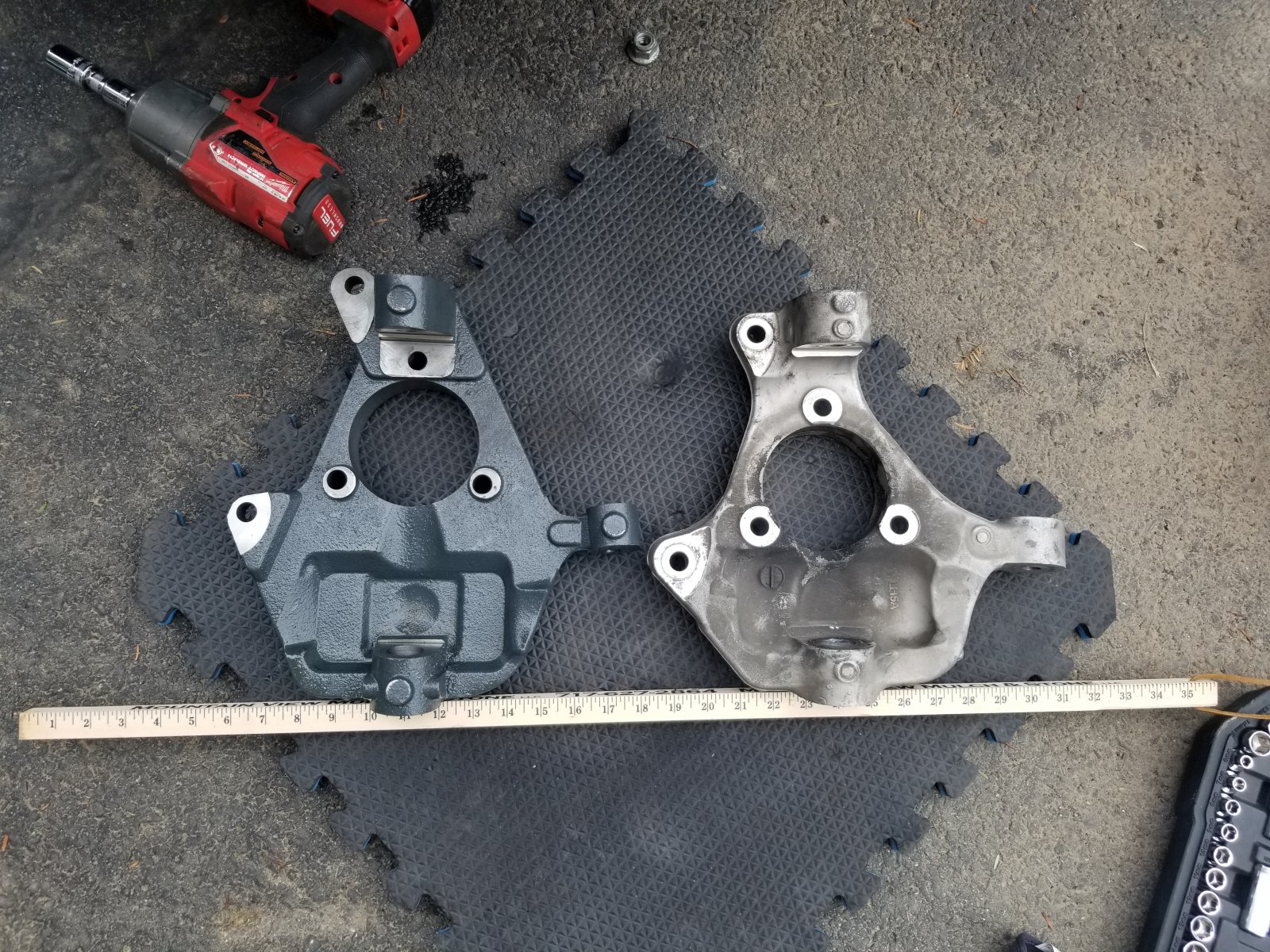

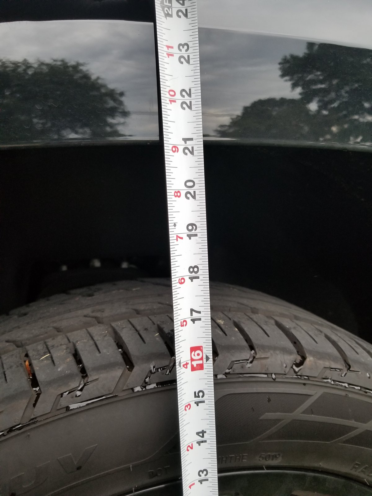

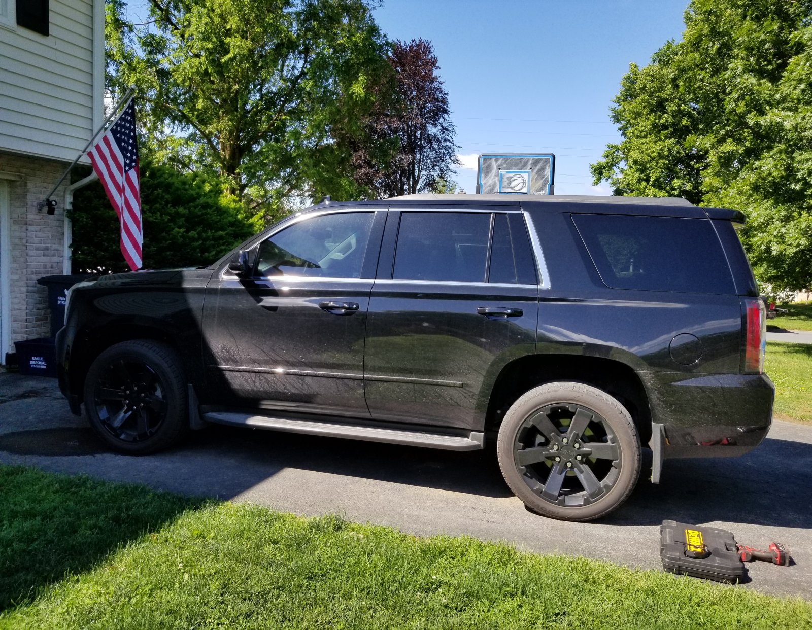

Before and after front drop spindles installed, and compared aftermarket to factory spindles. Then with how it sat with all parts installed.

like one past post mentioned with both spindles removes and put next to each other is the cv shaft hole offset from one another? If the answer is yes then you will get your drop. I don't understand if the holes are at different positions then how can you NOT get a drop. Now it is confirmed the 2" drop from the spindle really only gets you 1.5"ish.
Plus post picks of your findings

I guess I never saw this last response, but yes, the holes were about 2" higher than stock so it absolutely should have lowered. I never did figure out what the problem was, and almost always wish the kit worked when I walk by my car. The ONLY thing I can possibly think, is that if I got another set of drop spindles again (I sold the original ones from this post), and installed them, then loosened both lower control arms, then maybe it would drop. I never did that because I didn't want to screw up the alignment and not be able to go exactly back to stock if I had to put the stock control arms right back on if it didn't drop, because It's a daily driver. The only thing I can think is maybe the control arm bushings were binding, or basically were pre-loaded and not allowing it to drop, since the drop spindles or the belltech adjustable drop shocks with the removable rings gave me the same 3/4 inch drop.
