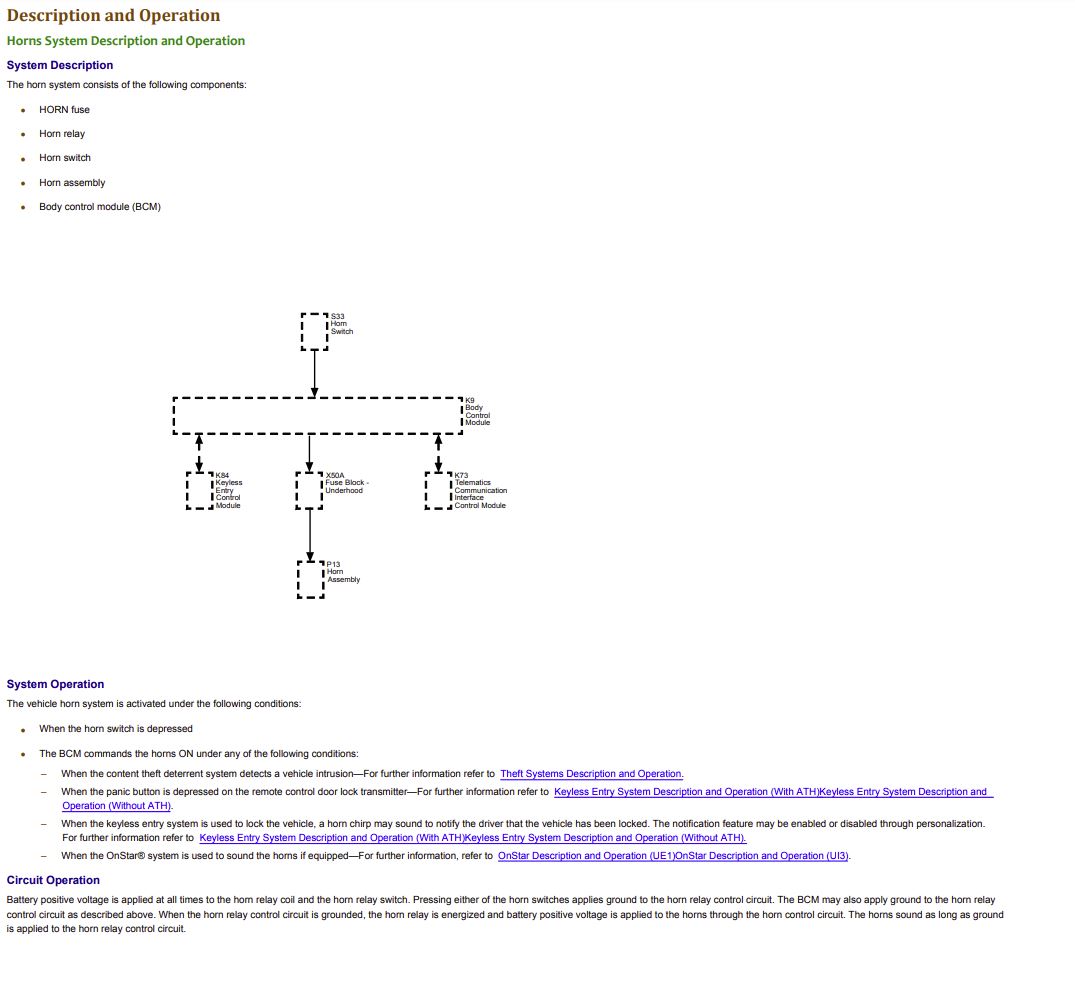

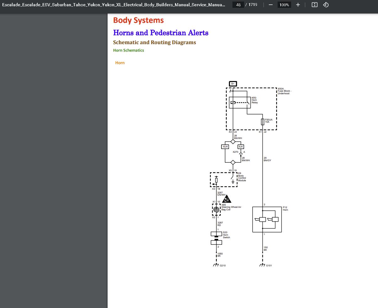

1 wire from the bcm to the horn (relay) fixes it, horn is normally grounded, all you have to do is apply power.
circuit is normally open, pressing the horn button in the steering closes the circuit = horn activation.
the wire is probably cut between the bcm and relay
