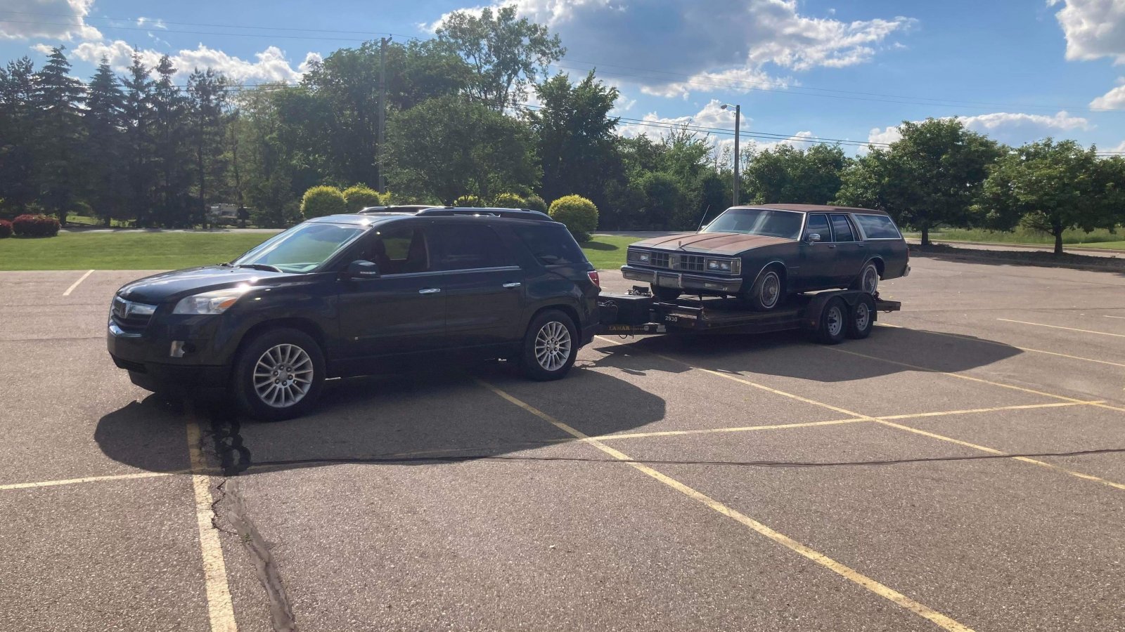

If this thing can pull this and this is all of the squat I got...
Id like to think I could hook up and not squat on this. but here is a photo of the small trailer hooked up. No squat but the rear shock bags are super blown out. thought that the bags are cosmetic and not what are actually holding the air in the system. Yes, the angle on the trailer is off.
