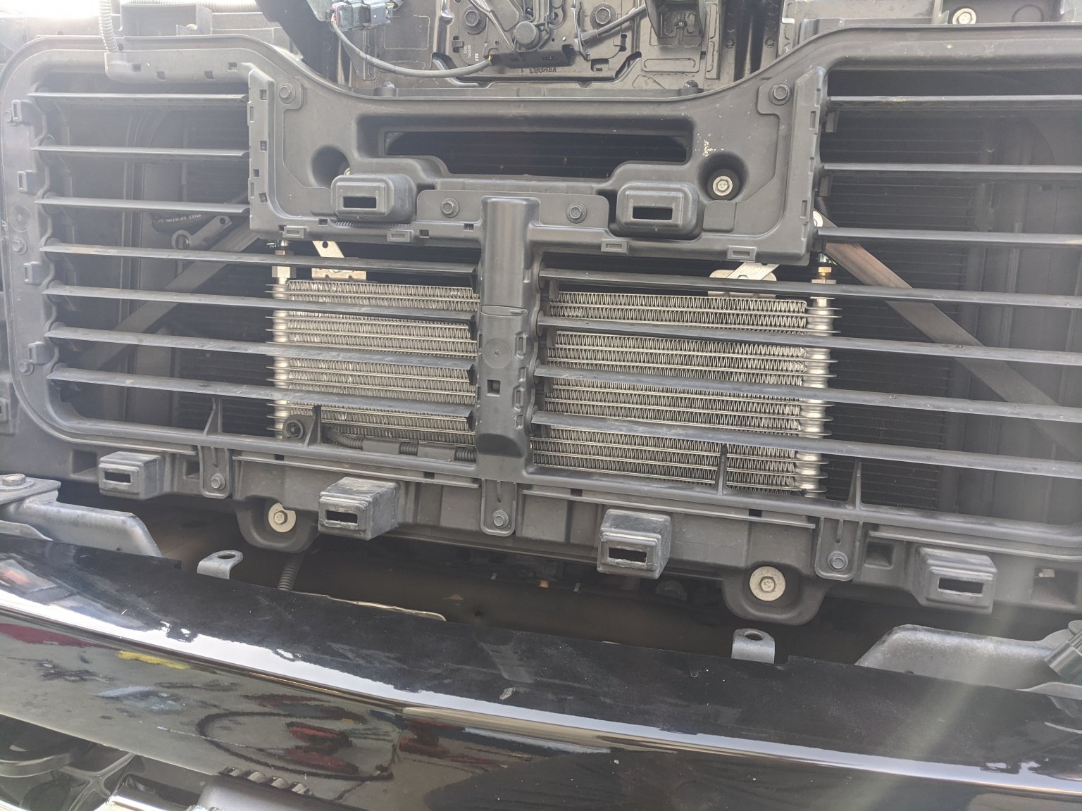

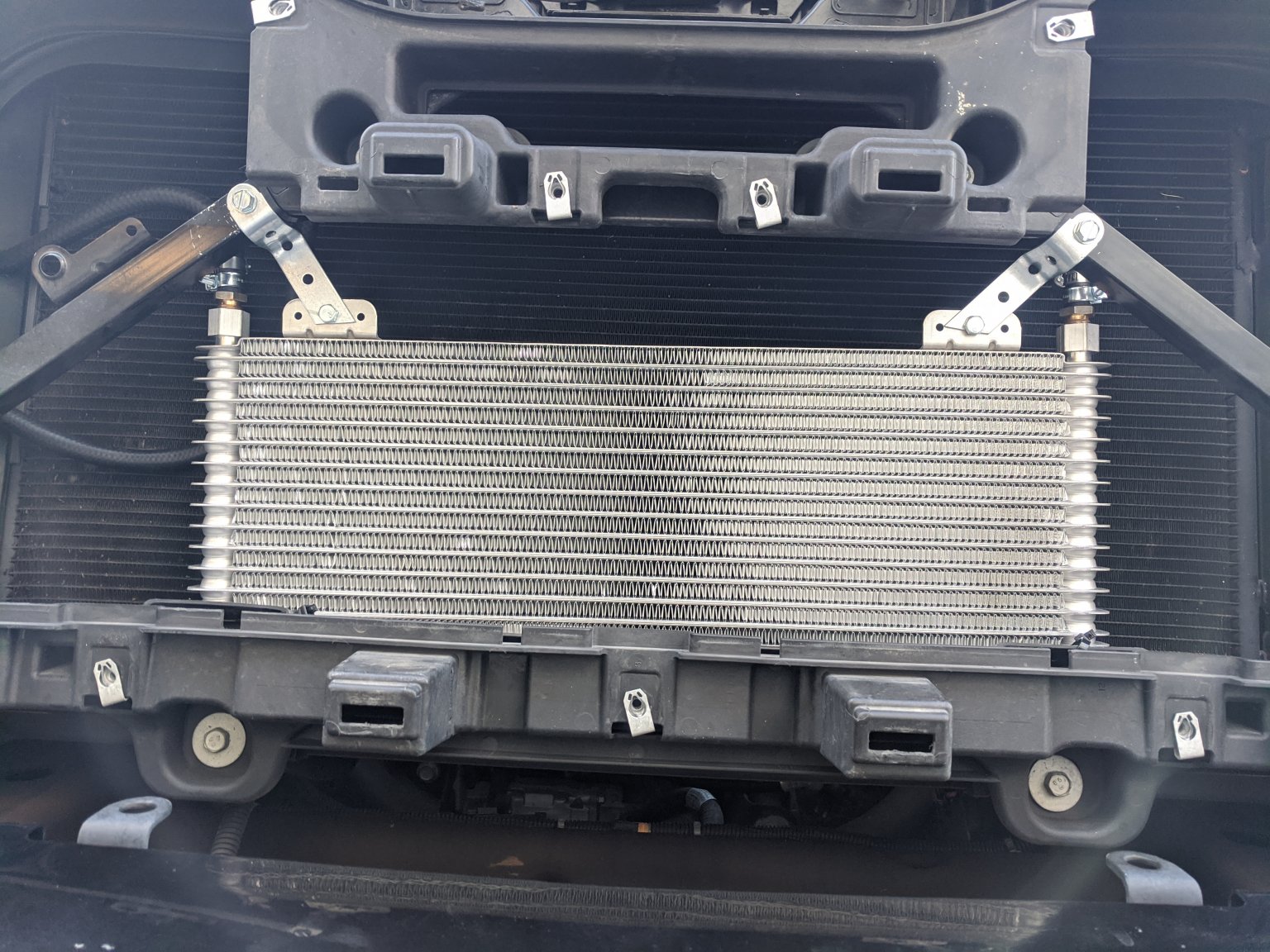

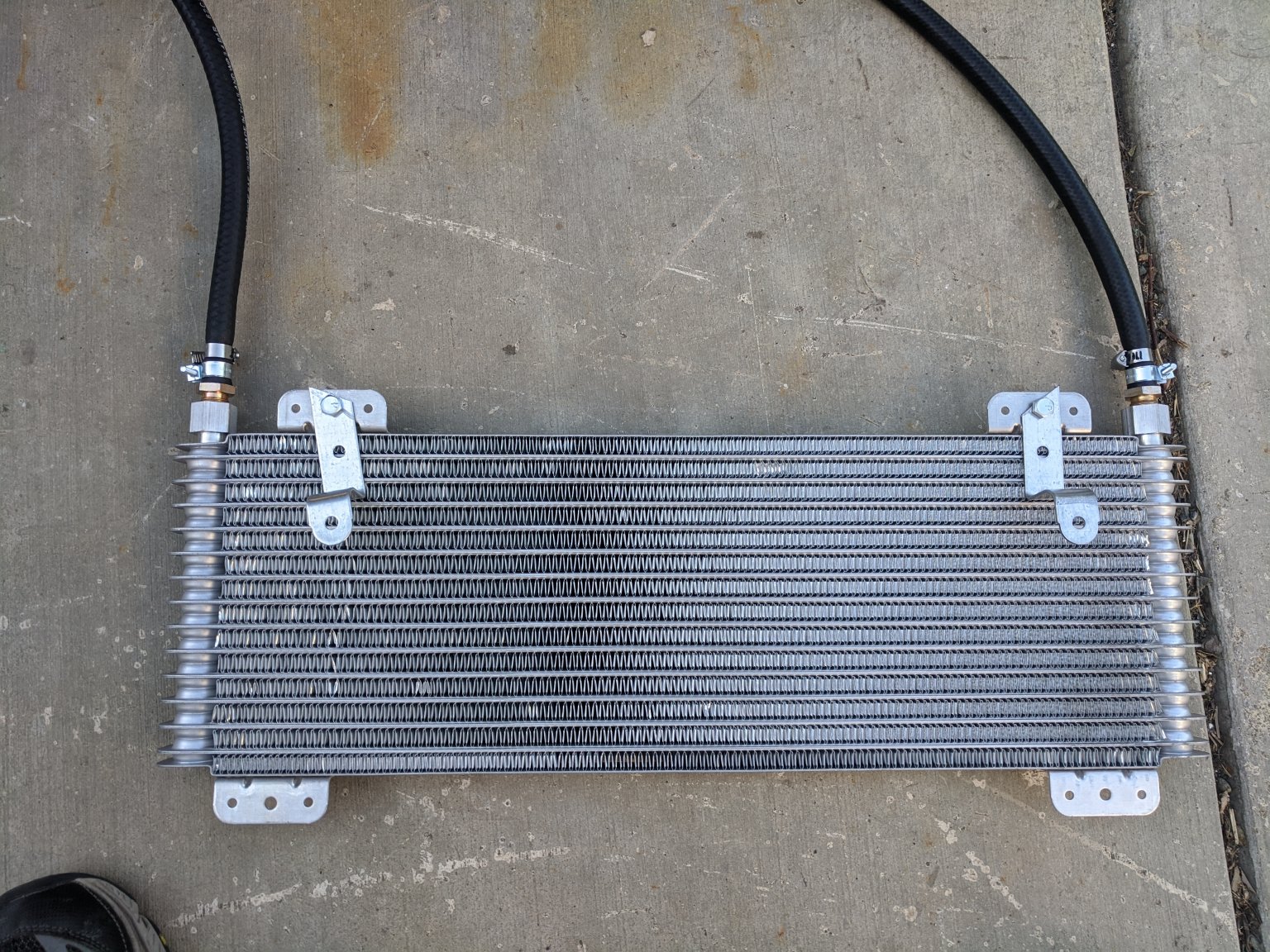

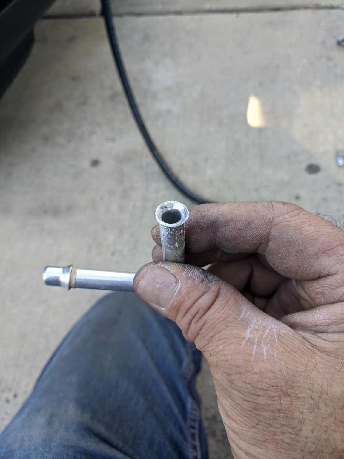

I did the thermostat fix and added the tru-cool 40k to mine and a B&M deep pan, I ran it in series with the little cooler that is part of the radiator shown above, space is tight and you have to trim a smidge off of the shutters in one spot but it works, just had to drill some holes in the plastic guard around the radiator (passenger side) to feed the lines and cut the factory line and make a fitting. now mine is typically in the 140's maybe 165 in the summer. it used to run 200+ just driving down the street. I also had blackbear turn the shutters off in my tune
