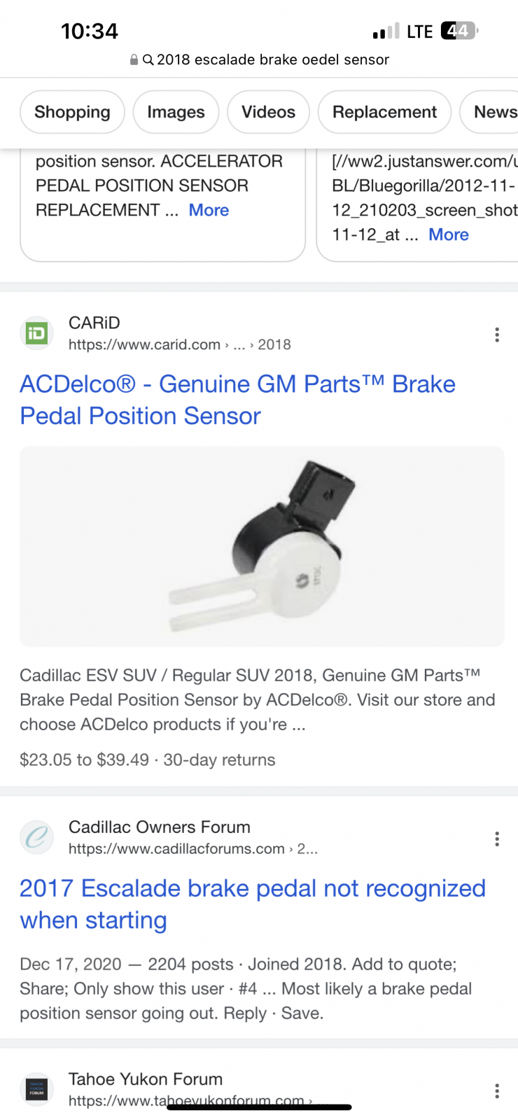

I believe the sensor was only like 40$ +\- and was located on the brake pedal mount under the dash you’ll see a black box thing it’s got two screws maybe 8mms? And a simple unplug and reinstall
