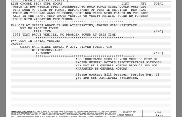

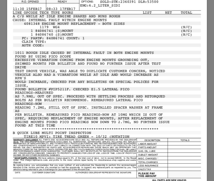

Here are the service logs.

It shows the put me in a silver Yukon loaner.... they did not. It was an Acadia. Also I think I should still be concerned with the RFB. Even though they replaced 2 tires... the vibration and pressure still exists.

It says the vibration is gone...did you do a test drive with them?

I did not. Service manager was insisting he drove it and there was nothing there. I made him aware I would be back after the weekend if it was still there to me. I had to have the car... having 5 kids they couldn't accommodate me in a loaner.
