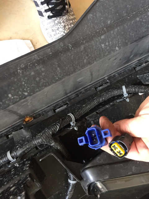

How did you install the harness? Seems to not line up? Does it need to be re pinned

It's a different plug but it will fit, I forgot all about the plug and need to call them on the difference for a fix. The plug is for a 5202 bulb and we have a psx26.

I used an X-Acto knife to shave down some of the plastic .... popped right in
