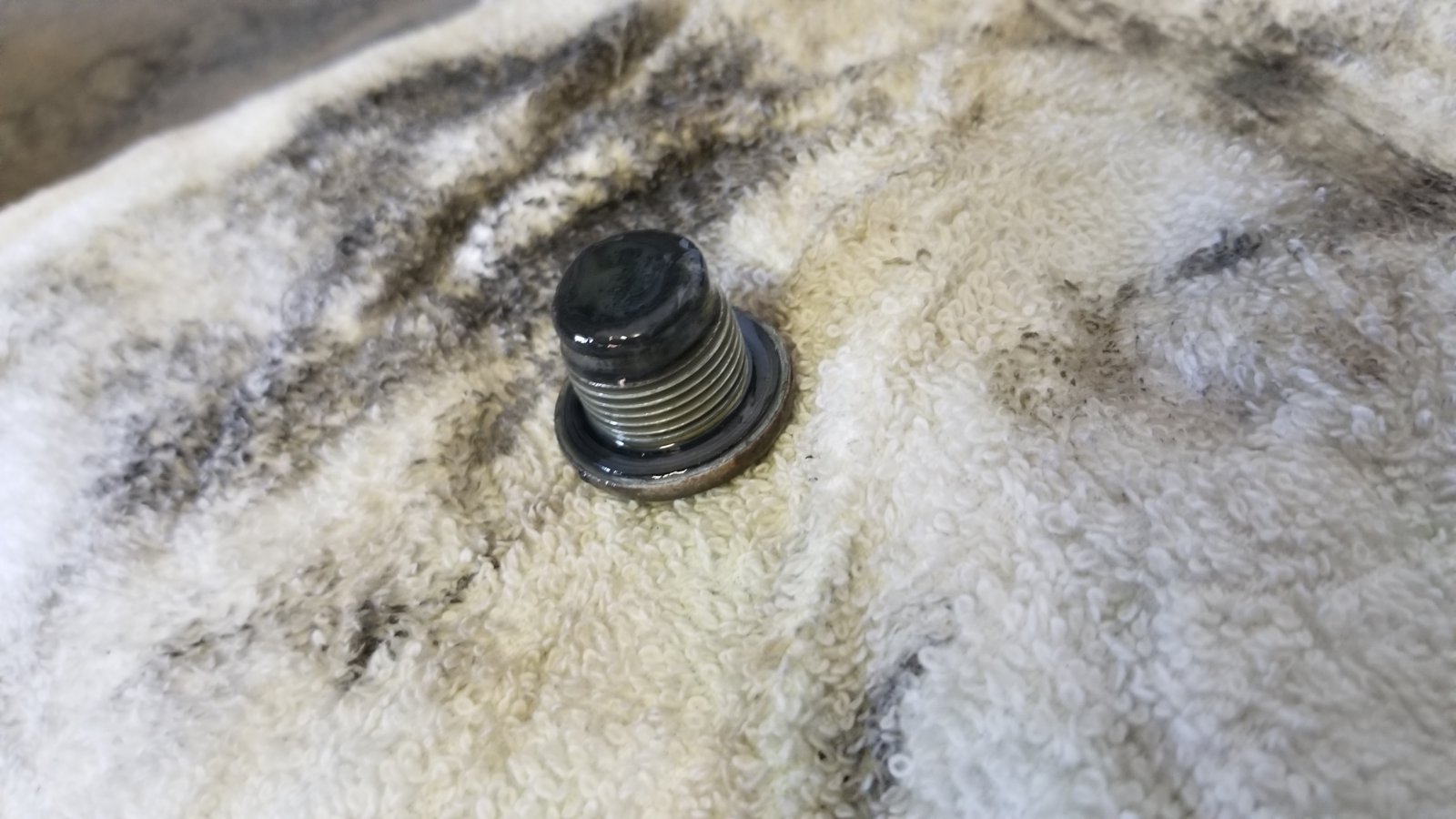

I changed the gear oil in both differentials and the transfer case fluid today. Used Amsoil Severe Gear 75w-90 and their Synthetic ATF, which is compatible with Dexron VI. I wish I had done this at 5k or 10k miles. See below...
The transfer case fluid was still red and not too dirty. No pics of the fluid, but here was the magnetic plug before and after.

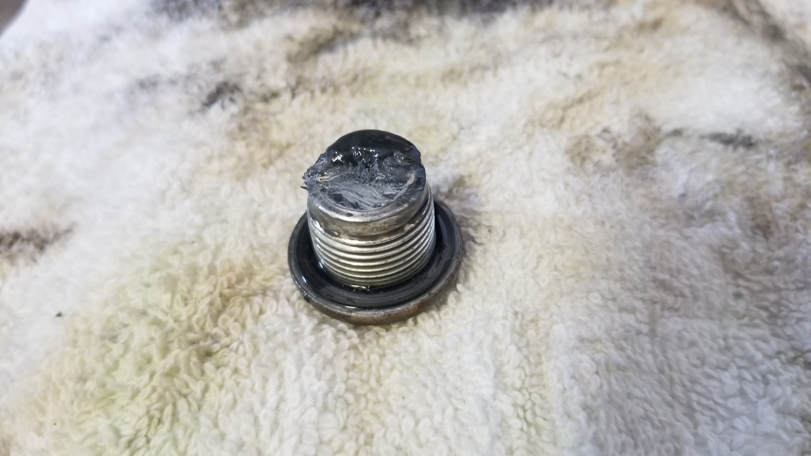

I had the exact same result on the font diff. 50k miles, 2016 SLT 4x4

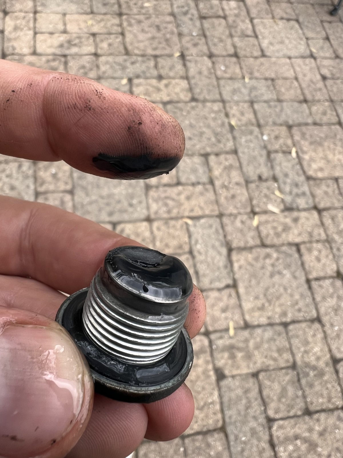

Hi Original poster update.
I’m at 94k and just did my transfer case and both differentials again today - 55k on the oils.
front diff oil was spotless - still golden in color and transparent. Very little paste on plug:
Transfer case plug had a little paste, fluid cherry red:

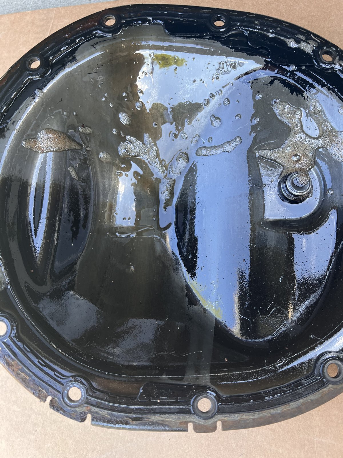

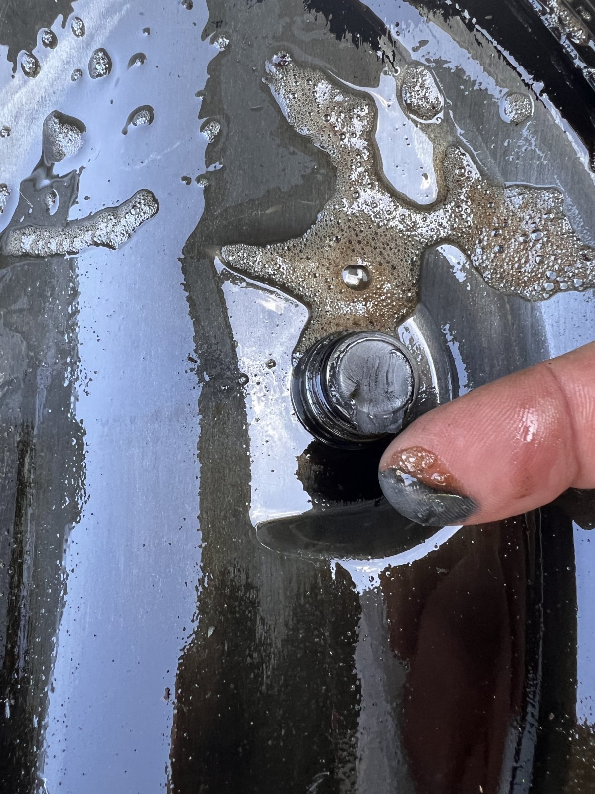

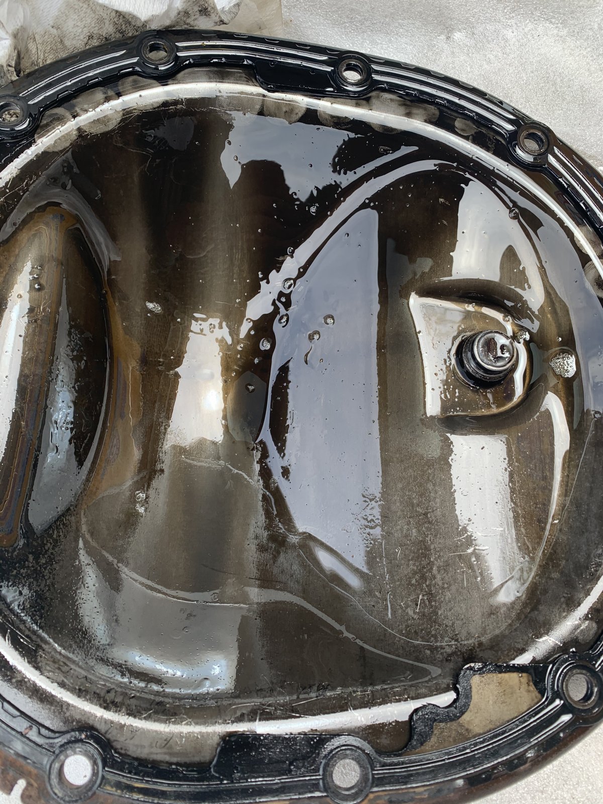

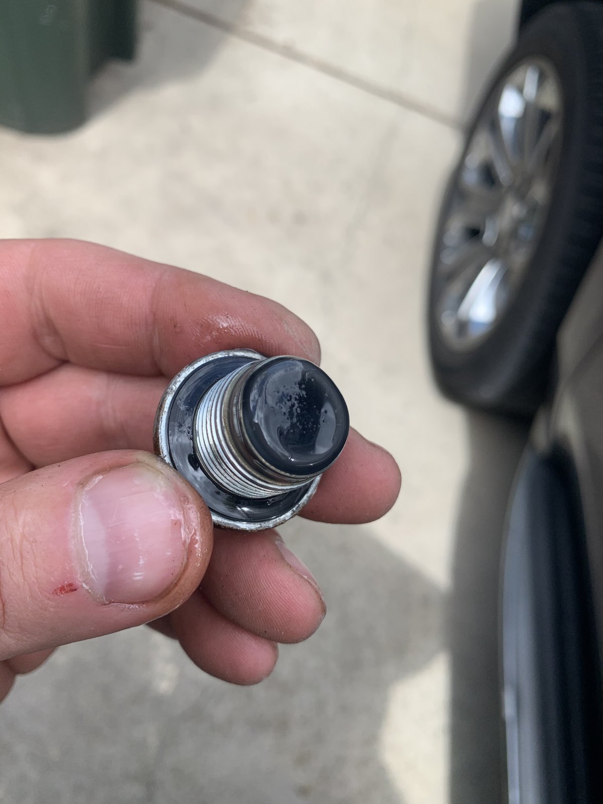

OP again. Changed rear diff oil today. 63k on Amsoil Severe Gear oil - 75w90, 158k on truck.
Magnetic plug had a little paste- same as last 2 times. Inside of cover was a little dirty / oxidized.
Sprayed out the gears with brake cleaner, wiped off magnet in pumpkin.
I thought last time was my last change, but glad I did it again. 60k seems like a fair interval for this truck and my driving habits.

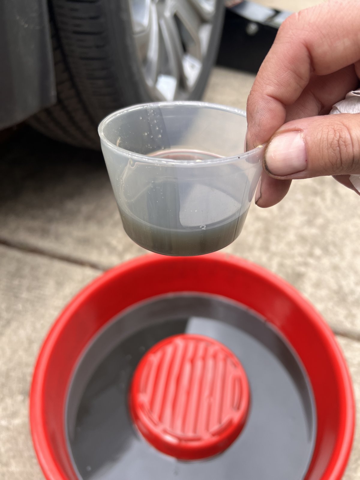

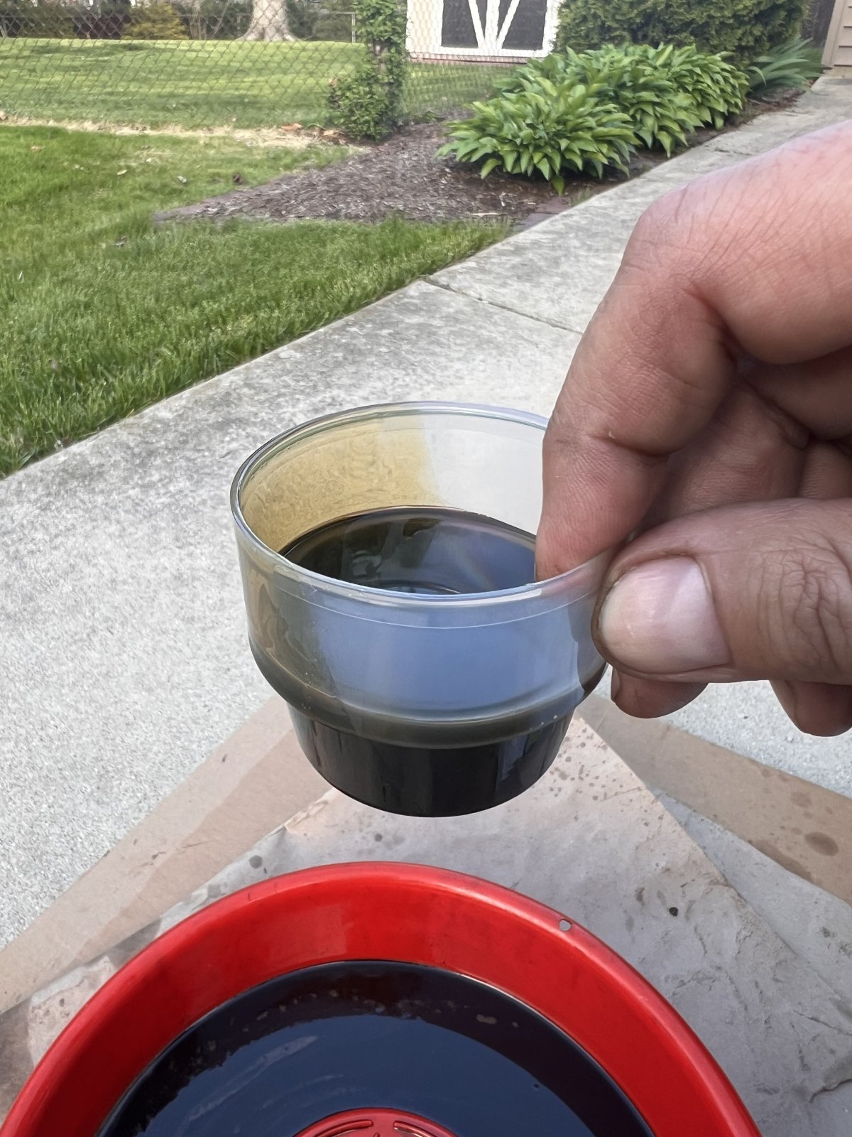

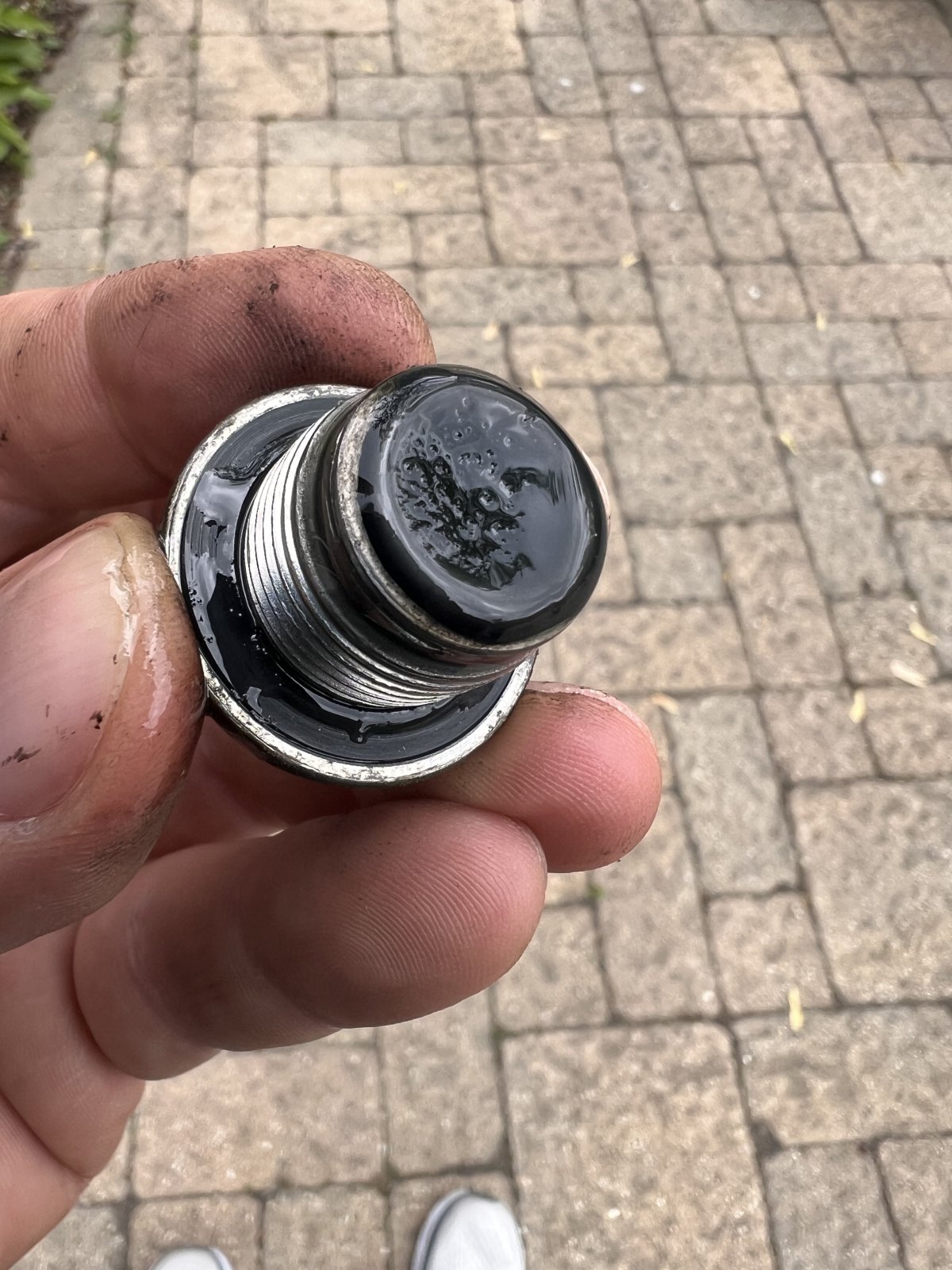

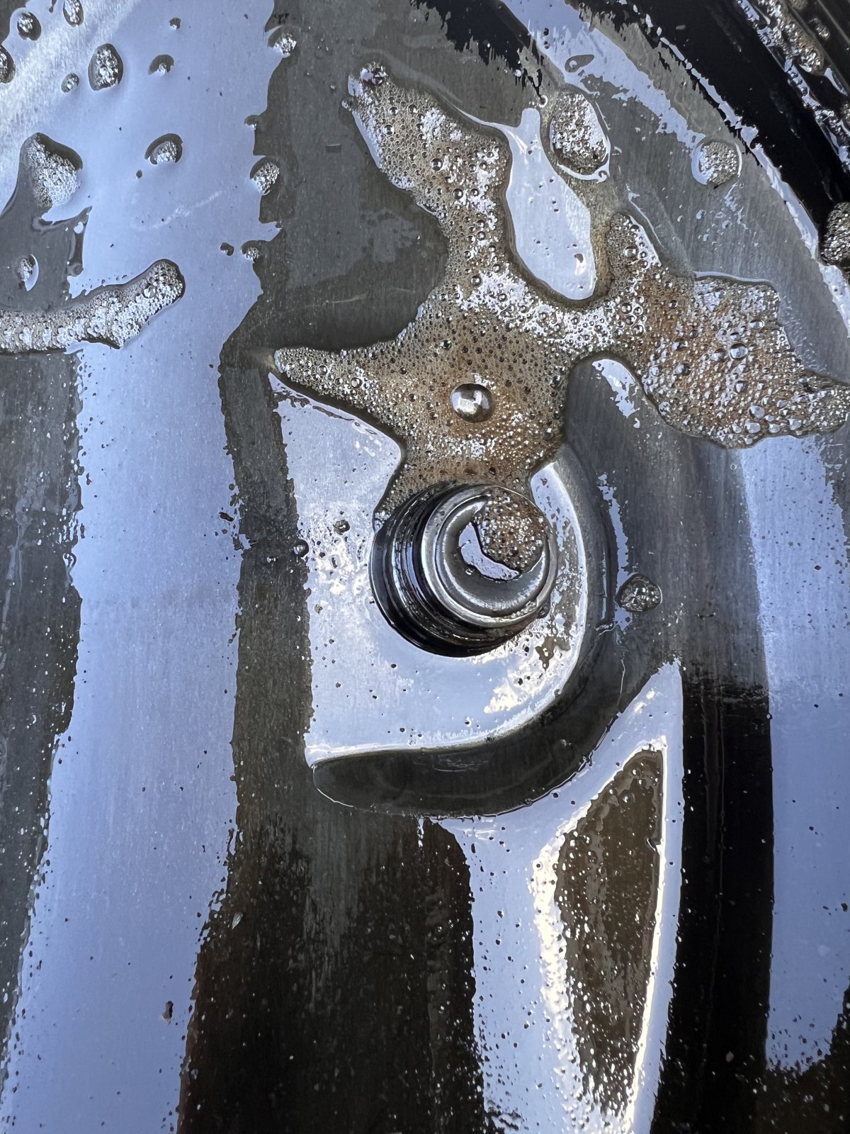

OP again, just did front differential again. About 64k on the oil.
Plug was pretty clean and oil was not filthy at all, could have probably left it ( as stated in my last change), but my OCD won’t let me…..
Out with Amsoil SevereGear 75w90, in with Valvoline synthetic 75w90.
