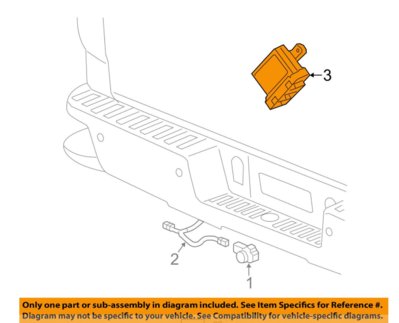

Can anyone point me in the right direction of where to find this module to swap it out? Dealership wanted $500 and the part brand new cost me $15.....utterly ridiculous!
Needless to say, I have it but can't find the location of where it plugs into the rear harness. Searched underneath the rear bumper from end to end.
Thank you and look forward to the help!

Post pic of module. Technically that can be anywhere in the truck.also, that may have to be programmed but i dont really know.

I looked real quick and it only ‘shows’ the module, not that it goes back there.

And that module is probably has an inside or under hood mounting position. Doesnt look too weather tight imo.

I'm thinking cargo area, right or left side (behind a cover that you are going to break 3 or 4 clips trying to get it off)

Just pulled off the upper lower cargo and side interior pieces with no luck....keep looking UNDER the rear bumper facia but still nothing looks compatible.....I may remove the rear bumper facia next to further my search. Called the dealership but he's already gone home for the weekend!!! This sucks!

FOUND IT....hiding under the left hand rear cup holder insert inside the vehicle above the wheel well! Unbelievable! Took me less than 5 minutes to switch it out and no broken clips! Thanks for the input!
