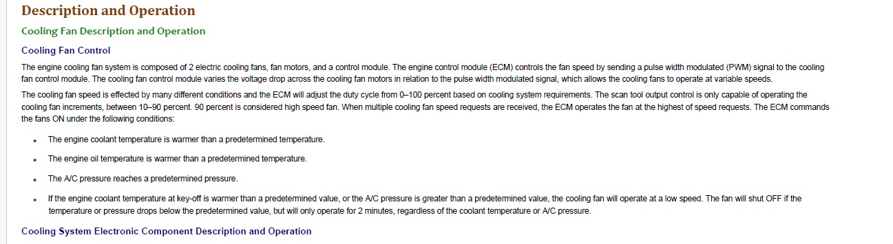

From the electrical manual I have on our trucks the fans use the A/C pressure sensor to vary fan speed through the engine ECM once it reaches a set pressure. Your A/C pressure sensor may be funky, it's a three wire setup per the wire prints. I would say if you have already verified the system charge it might be worth trying the pressure sensor. If it is showing that it meets minimum pressure it won't cycle the clutch but if it doesn't report a higher, more heat saturated pressure, it may not kick the fans up to high.

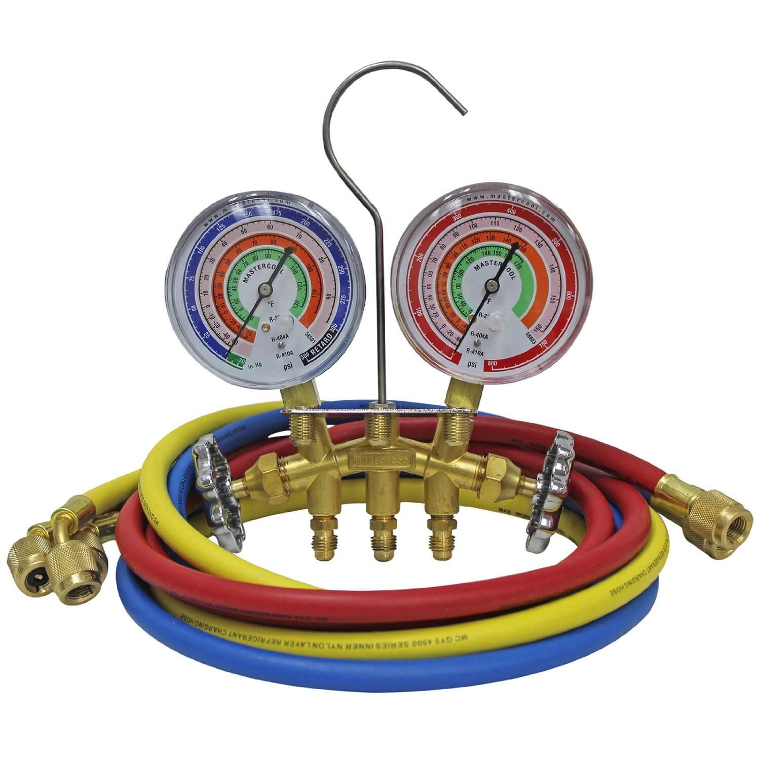

Had a similar problem with another vehicle a couple of years ago. Turned out to be low on refrigerant. I used the gauges James shows above to determine the pressures I was seeing vs what I should be seeing at the current ambient temps outside per the standard r134a tables widely available. I was able to add about half a can of refrigerant to get the pressures back in spec.
I know you said that the local shop said it's charged, but did they really put the gauges on it? I would take it to the closest local shop with a set of gauges and start there.
