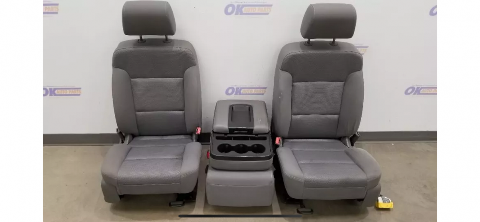

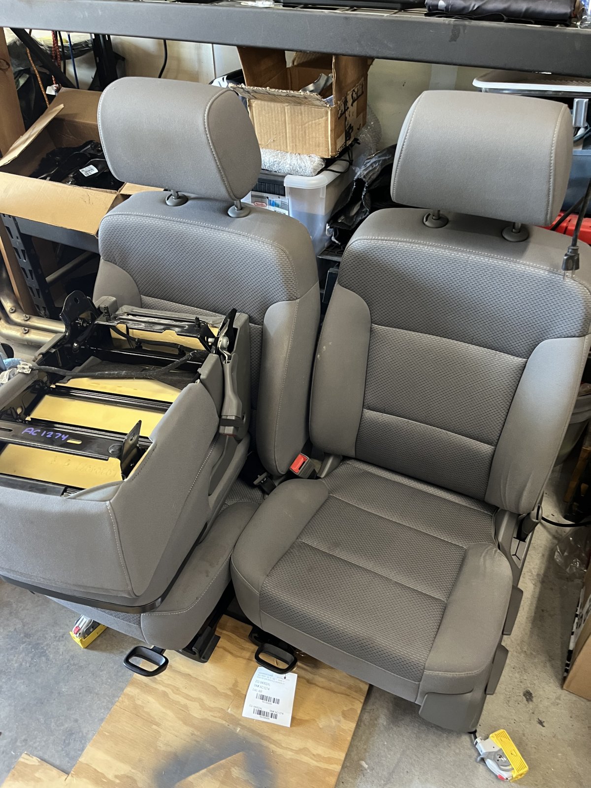

Figured my rebuild is on the other thread so I’ll start my interior thread here.
Just bought 2014 Silverado seats for my 2 dr tahoe. I’ll be buying the www.obsoutpost.com brackets to use these. I also plan to get a GEN5 3rd row to use as my 2nd row. All these have been proven to be an upgrade in both leg room quality.

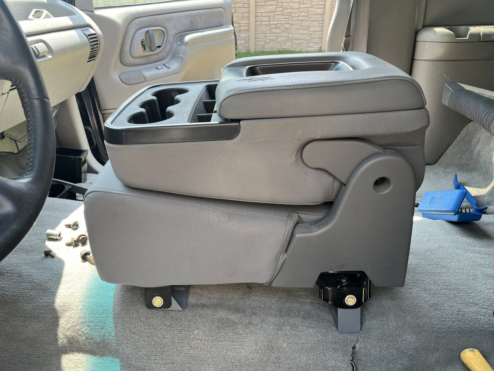

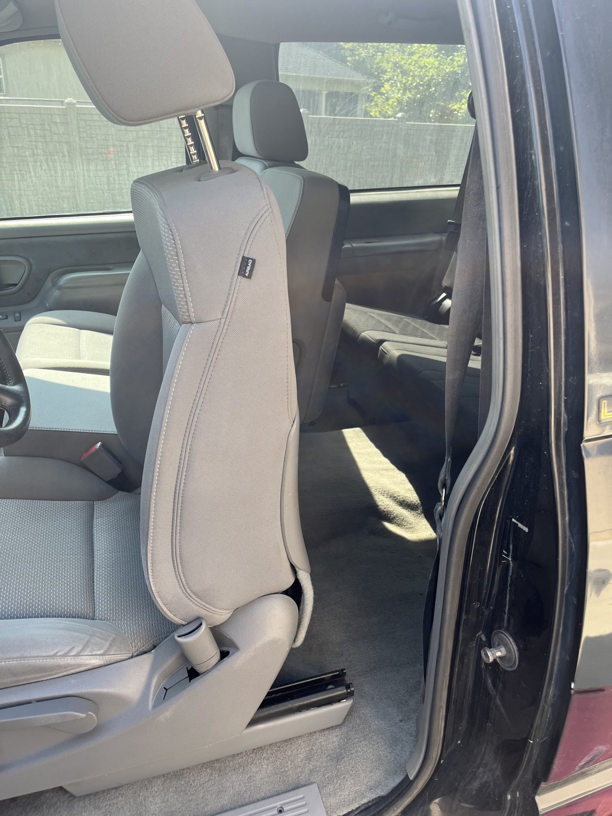

Well I got them all in and they look great, these brackets are made perfectly. No squeezing or modifying or trying to even them up. I forgot to take a final pic of the install but I’ll post what I have. Tomorrow I will get more pics and my thoughts but here is what I have
Back seat fully installed. You have to drill 3-4 5/16” holes where the flap used to be, you take that out it’s no longer used. Then 1 bolt between the seats
Center console. Again easy install, what is a bit challenging is the padding under the carpet. I had to trim some out but it didn’t take me long

Anyone know what the little receptacle thing is on the outer side that looks like something you would plug a seat belt into is?

They are super nice to sit in compared to the stock seats. I had reupholstered and put new foam cushions in the old stockers but I just didn’t like the lack of support in them.

After driving around town for a few days I must say I LOVE these new seats.. super comfortable, keep you well planted in the seat, we fit all 6 (4 kids, wife and me) in the truck the other night, thanks to the jump seat.. 2 of my girls are adult size.. it was comfortable and they loved the new rear seat
