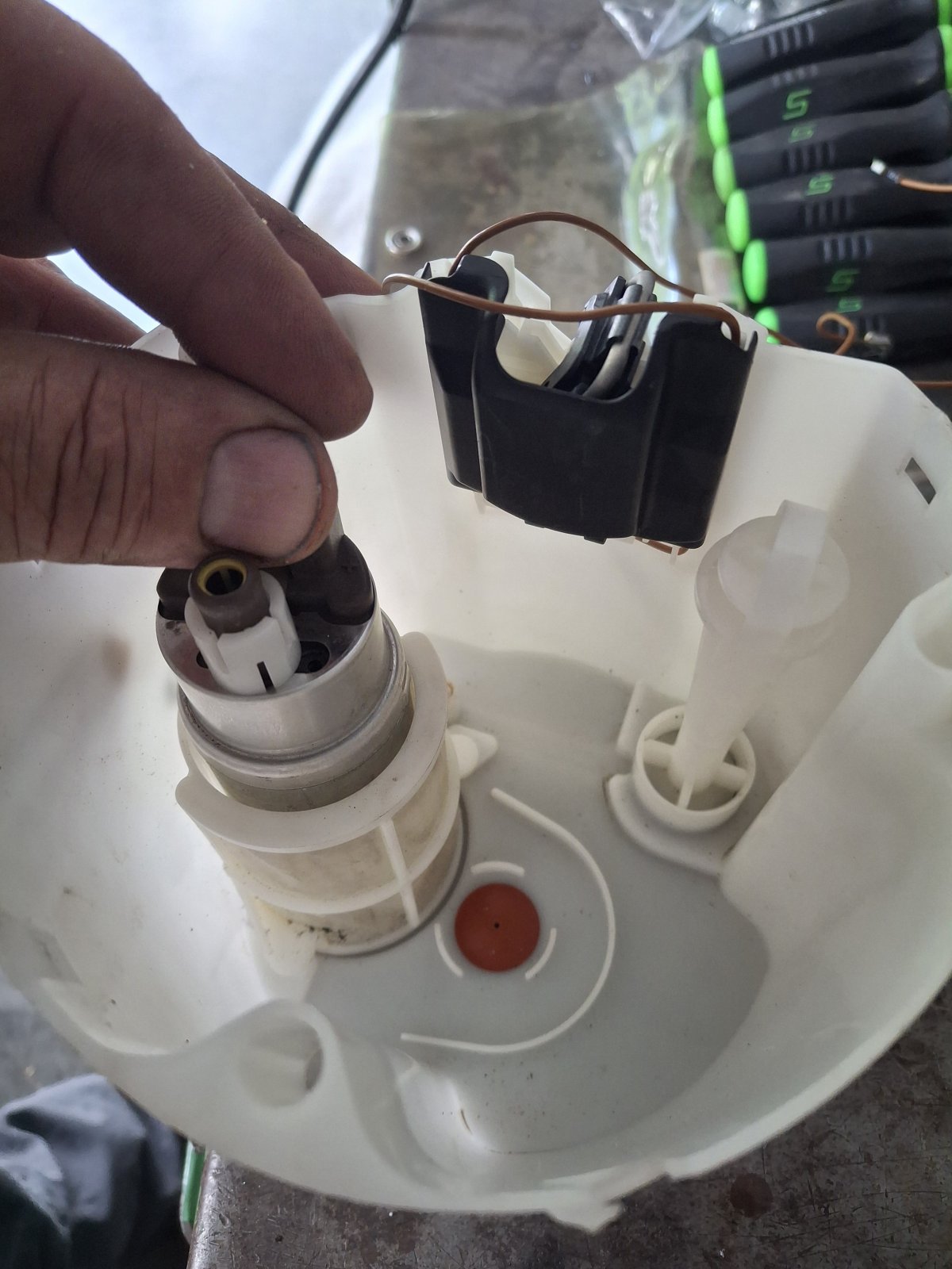

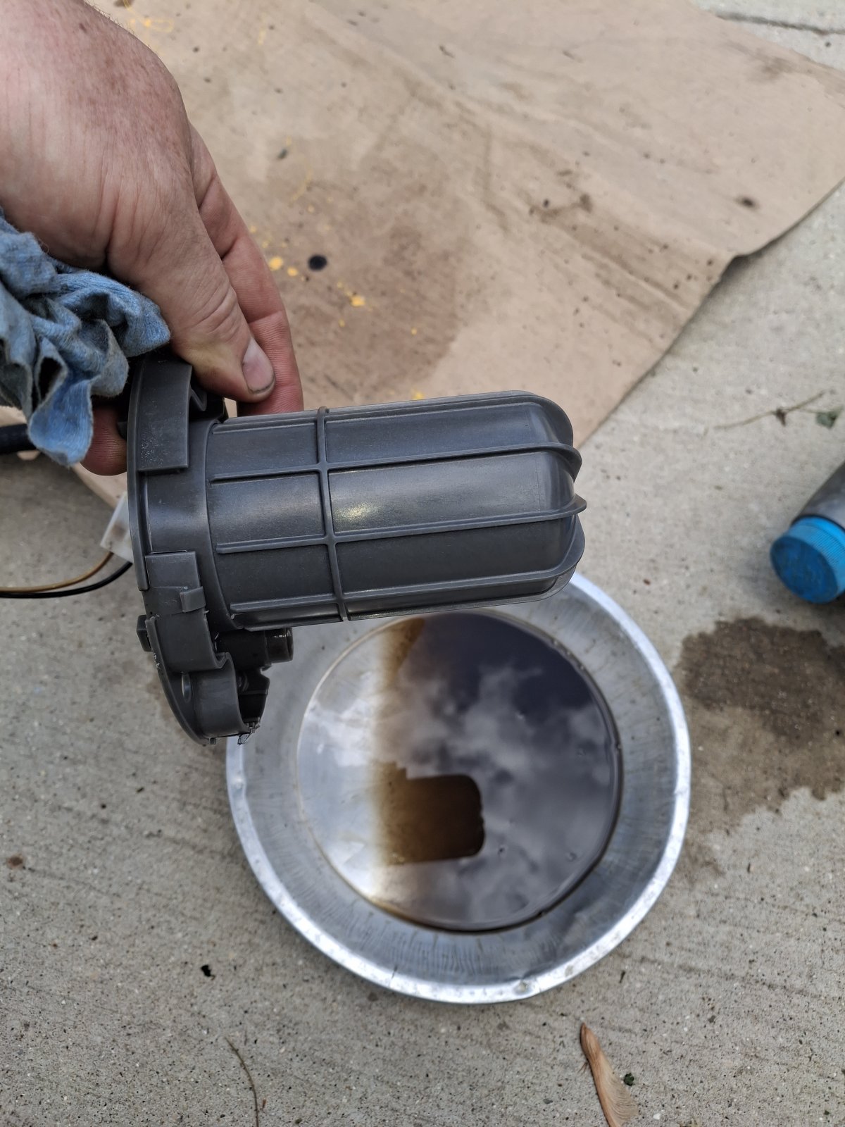

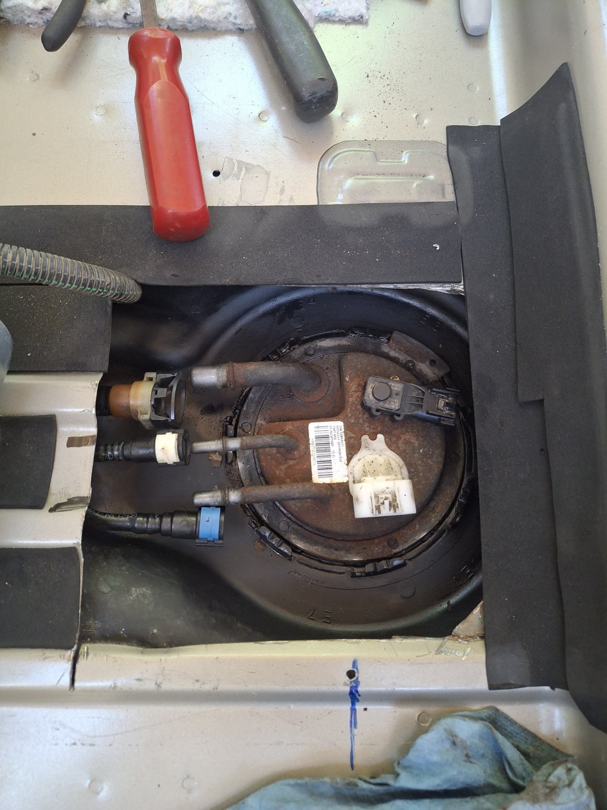

After dealing with a similar issue, I would lean towards the fuel pump. I found that the pump is a great design........the non-serviceable filter is a PLANNED failure point. A tank or 2 of bad, dirty gas, will plug it up.
My truck was gasping for air in MT on a road trip after filling with premium fuel (obviously they didn't move much fuel and I helped clean out the lines). I could barely accelerate, but I nursed it along and eventually made it home using lighter throttle input. Mountain passes were definitely slower than planned.
Funny thing is that I put in an access door before the trip and had a new fuel pump with me just for "what if, the truck has 200k on it." I opted to not get stuck needing some random part in the middle of a national forest and limped it back home. In hind sight, after replacement the very next day, it would've been easy to do on the road with an extra set of hands and the tools we had present. Sorry, long winded......
Here's what a filter for life looks like after 202k miles - and 1 or 2 tanks of questionable fuel quality. The black fluid is what flowed backwards out of the filter inlet.......it did its job because the outlet fuel was clean. Flow definitely restricted.

I had good fuel pressure on mine, which was the strange part, just not enough flow. I'm not 100% sure where the fuel pressue is measured on this engine, because it was always within spec when it was laboring to supply the engine. A new fuel pump and it feels like a brand new truck!
