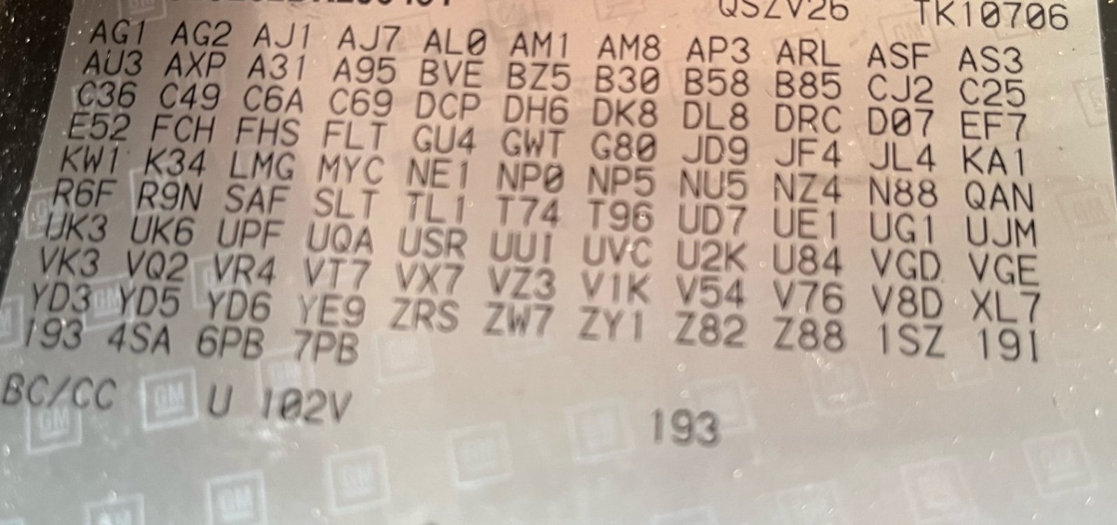

Edit: I've seen talk of Z55 suspension. Pretty sure I do not have that. Attached photo of part info from glove box just in case

ZW7 code says that you have the Premium Smooth Ride suspension with Nimovat shocks in the rear. Other folks on this Forum have Nimovat shocks, and they will chime in.

Thank you. I'll search for those code and suspension types in the forum as well now that I know. Appreciate the insight.
