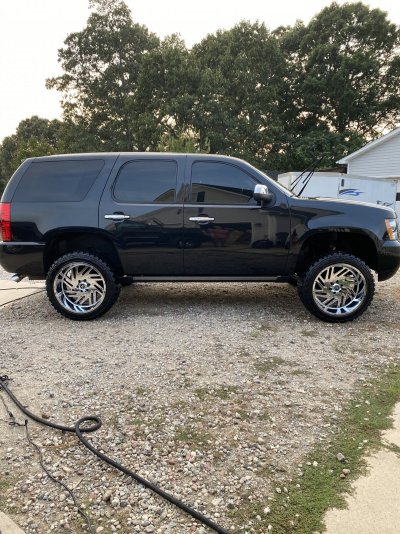

13 Tahoe with Z55. Looking for some options for the rear. Has the factory AutoLevel in the rear and has a 3inch spacer under rear coil spring. What could i put under it to get rid of that spacer

I think skyjacker makes some 2.5 inch springs but I don't know of any 3 inch rear tahoe springs.
I am personally running Moog 81069 springs with 2.5 inch billet spacers and would also like to get rid of the spacers some day.

Why do you want to get rid of the spacer? Is it not spacing? There’s nothing inherently wrong with coil spring spacers. They keep the factory springs and your good ride quality. I guess the only reason to change the rear is if you want a firmer ride.

Skyjacker cr 30s right? @Dustin Jackson is a 3.5 and the cr25s are 2.5 right?
Nothing wrong with using the spacers though unless you plan to run through the desert going 100mph I run double stacked leveling kits up front and have for years with no issues at all.
I believe rough country has springs also I have their 6” ones in the rear and helped firm my ride up alot
