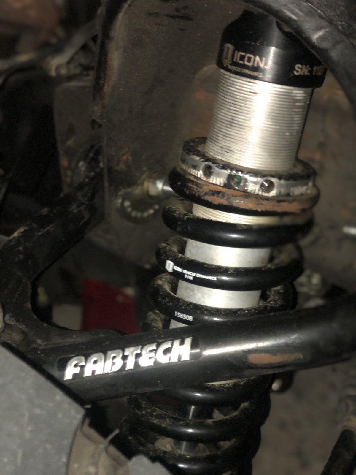

Idk I had it on mine but compressor never worked since day one I never did any kind of delete simply swapped the rear shocks for bilsteins off my Silverado and put coil overs up front with fabtech uniballs and I hit train tracks running 75+ driving with my knee with a 8” lift and 24x14 35/15.50s I diddnt like my rc uca when I simply swapped from them to the uniballs it was a big difference in handling
Trey Hardy
Jun 12, 2020
3,552
9,637
Before it was super soft and spongy feeling now it’s nice and firm not too firm but a nice firm that makes it feel very controlled and handles very well for what it is
