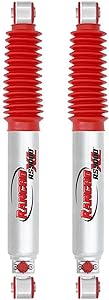

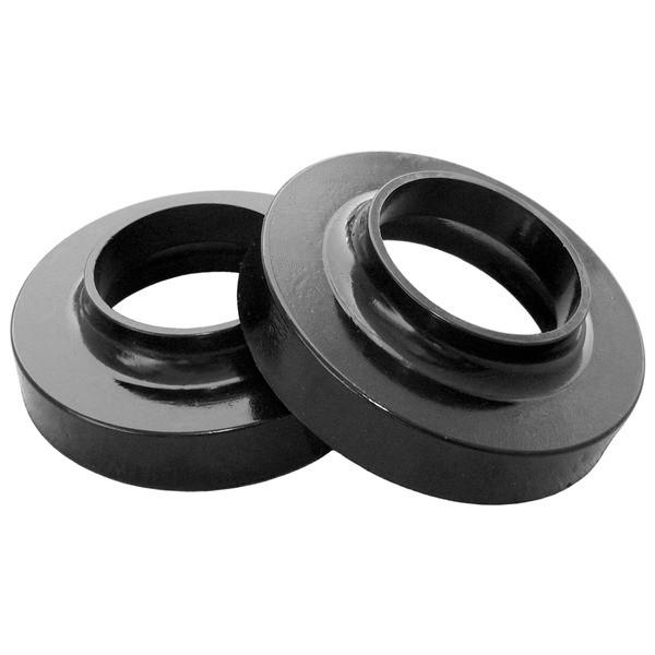

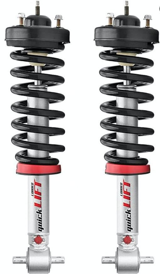

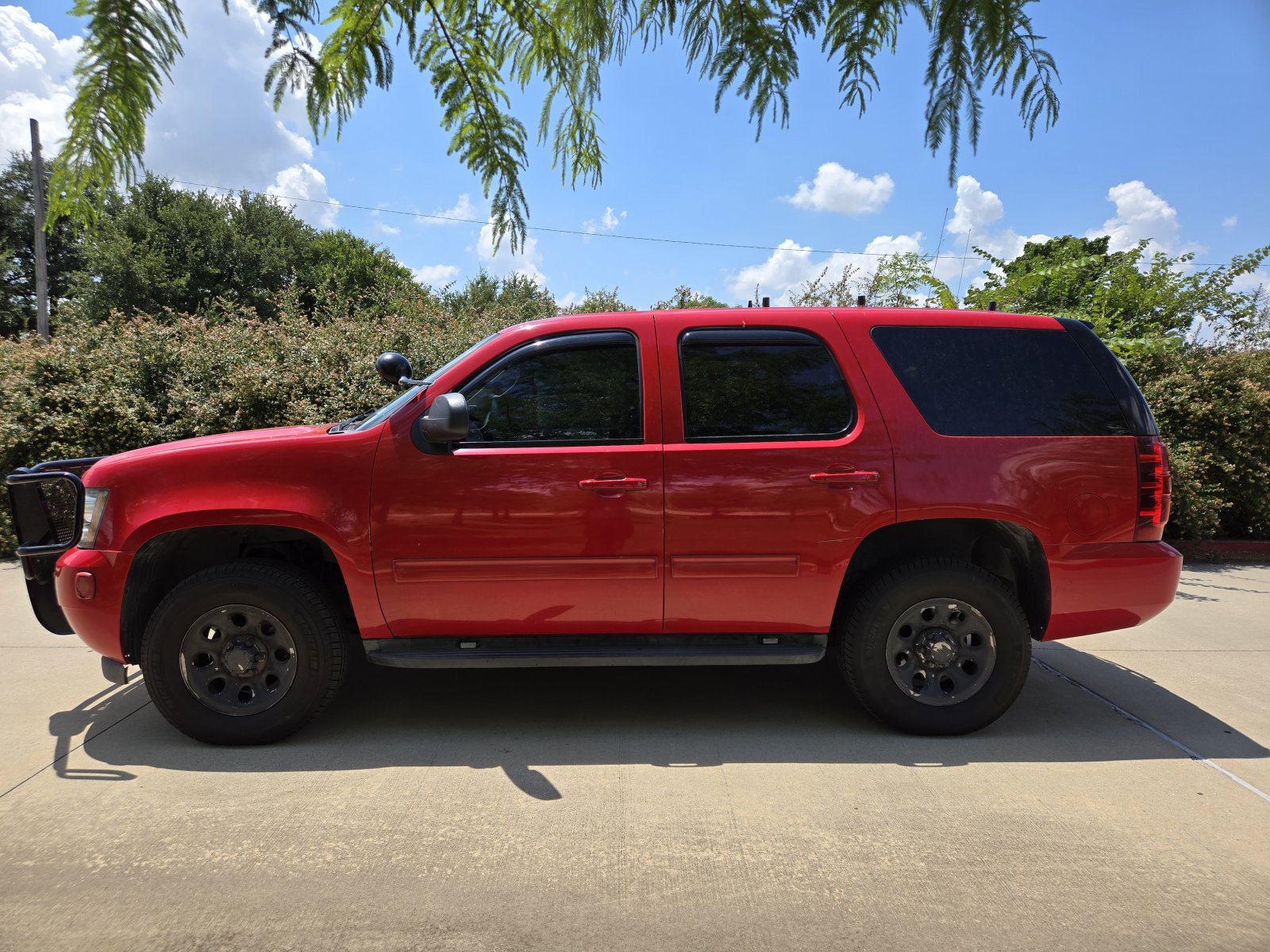

Does anyone have experience with the Rancho 2" Quick Lifts, 70075 Spacers, 9000xl rear shocks on any 07-13 models? I don't think me having an SSV is any different from the LS, I haven't seen any PPV/SSV changes to the suspension to suspect any fitment problems.
I recently purchased all three trying to level my SSV. It has a cattleguard on the front, so its weighed down around an inch, possibly more, from stock height. The spacers were purchased because it was noted that I had to purchase them to put on the rear to raise it by 0.75", I'm not sure if having a slightly lowered front from the guard will have any effect on it though. Any thoughts?

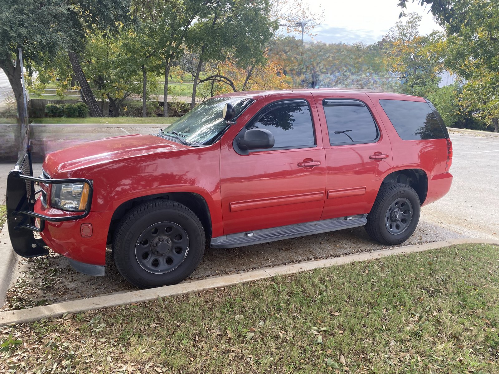

My Z71 looked similar to your picture before a level. (Have a push bumper and extra battery up front)
I have 2" lift spacers up front and no spacers in back.. and I feel I will add a 1" spacer in back..
You could do the front's first, then decide on the rear.

I would say my truck is pretty level, unloaded. So I prefer a little rake.
But not as much as I had, which looked very similar to the OP's.

my truck is in background
Here in my 'al fresco' garage, unloaded, 3rd row removed.
