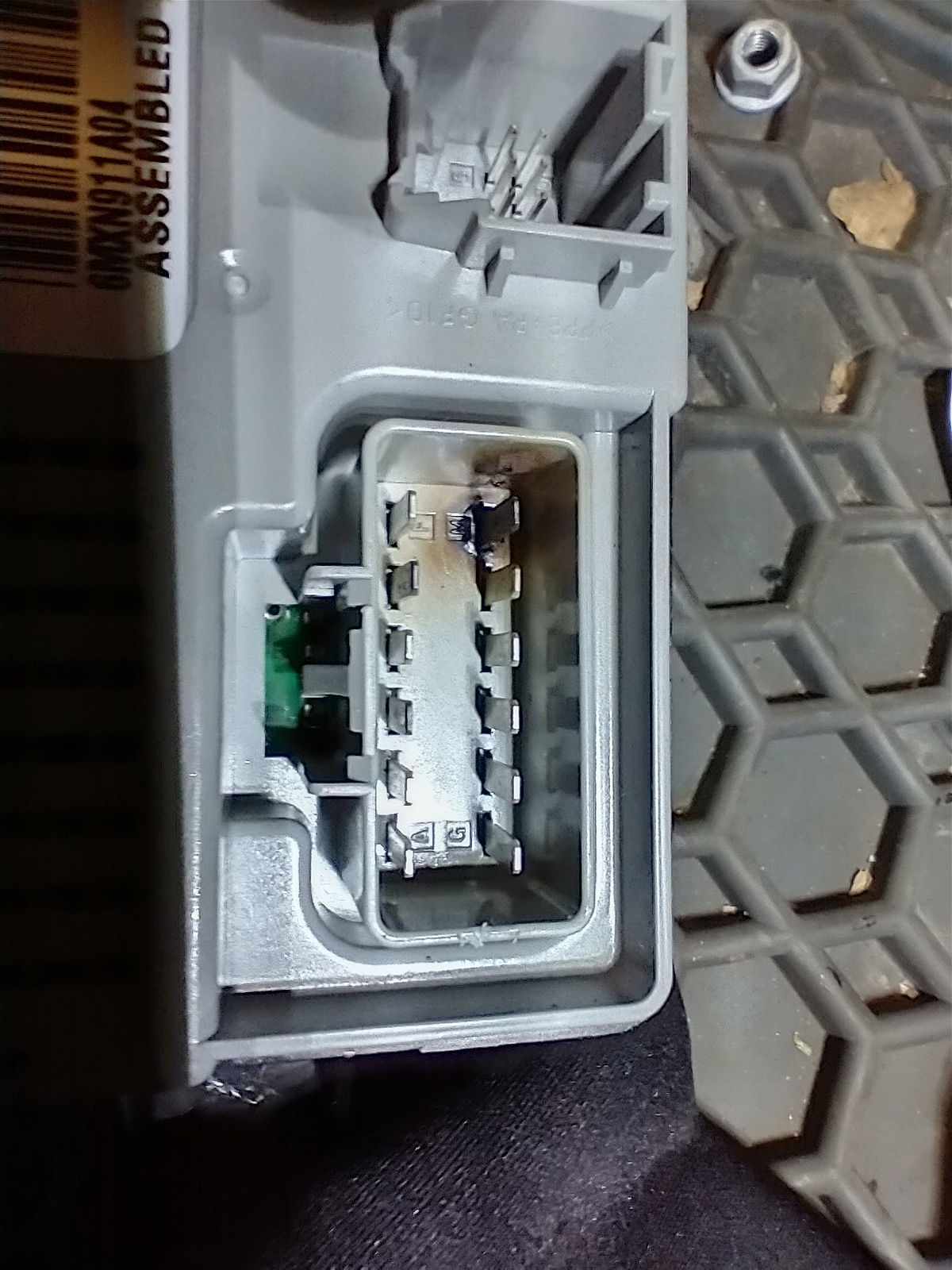

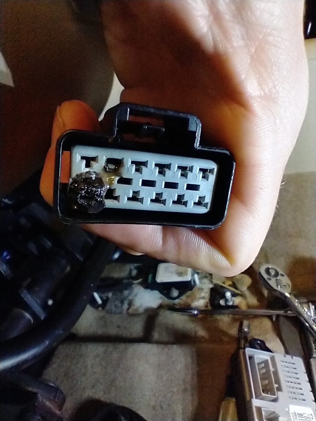

Another failed part. All the heated seated stopped working. This is another GM common failure, connectors not rated for high current. This youtube link shows the repair,
This is on a Cadillac but GM used across the entire line. I fixed it!

10 year old part that was not built for higher current? Lasted 10 years. Not saying could not have been designed/built better but to blame it all on the connector after 10 years seems like too much. Area where connector is located, resistance values thru the circuits and previous work can all contribute. After 10 years, I gotta give the benefit of the doubt to the connector. Glad you fixed it though.

a melted switch/control like this is more indicative of a short in the seat heater system (wire grids touching/shorted), poor ground, slightly over rated fuse, etc
around 2010 they made a design change from a wire grid pad or from a 6 way bottom seat vent to a one way a blower motor pad design instead for the bottom seat cushion, the lumbar is still a wire grid pad, rear seats are wire grid pads also.
the non cadi/denali lower pads may still be wire grid, not sure if the blower design change was made to all trims or not
