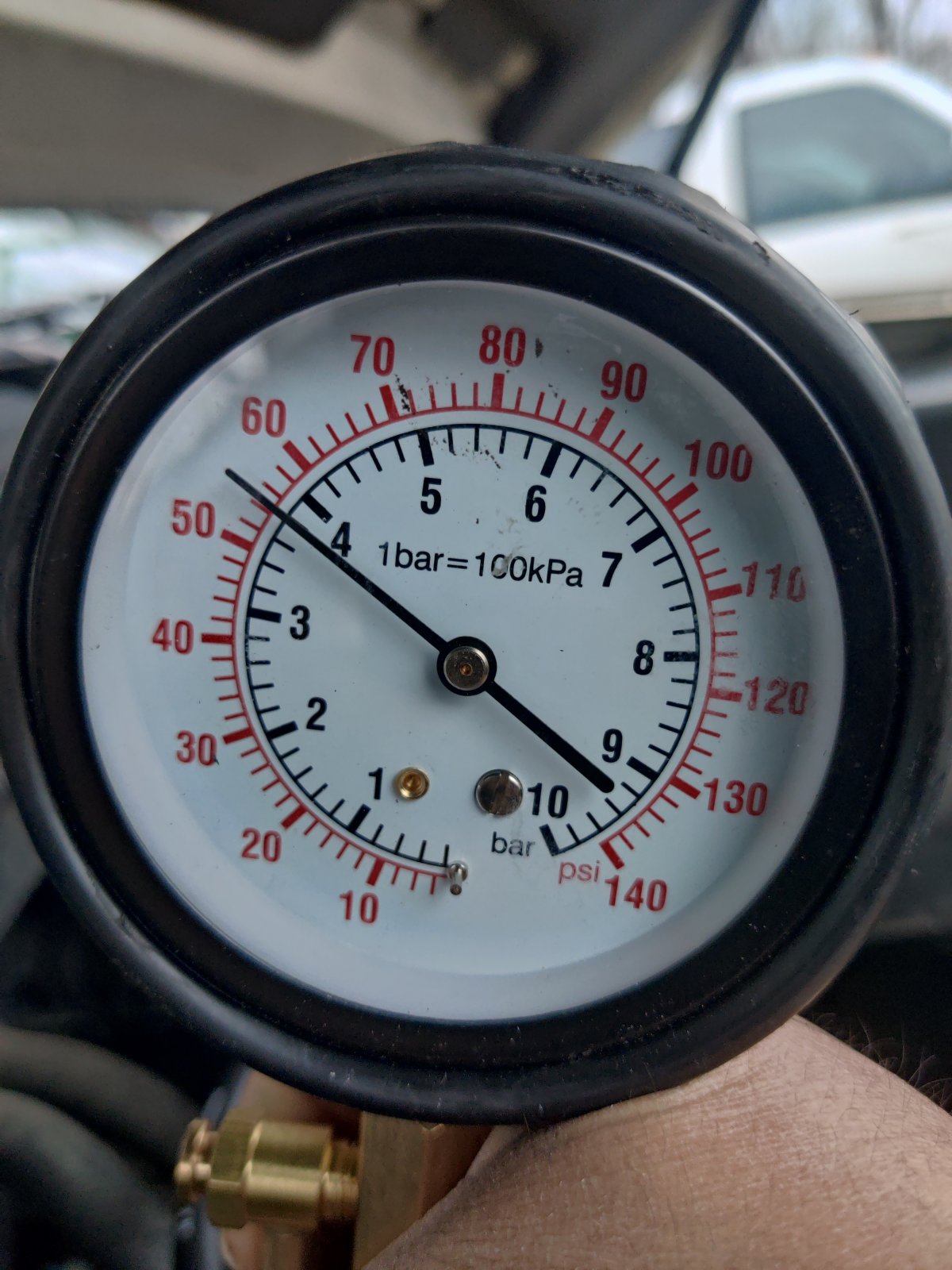

Checked for fuel pressure it's at 50 psi without starting and while running it's around 55 psi

Hopefully that gauge is off. Your running pressure is supposed to be 43.5 psi. I wonder if the balancer is starting to move on the crankshaft?
That's a good point, James. If this problem comes back, I'd be inclined to suspect that the pressure regulator on the fuel pump is starting to go. I had similar symptoms in my 2007 when the pump started to go south.
Thank you guys for the heads up. I am planning on a little vacation trip on April and I might as well get the fuel pump replaced just in case, I wouldn't want to get stuck somewhere
