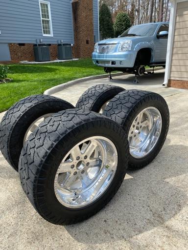

What is taking beads out of tires?
You can use beads in tires to balance them or use weights on wheels. It appears he tried to balance tires with beads and it didn't work so went with wheel weights and vibration ended. So his was a tire balance issue unlike every other fabtech rear lift that makes the driveshaft vibrate.
