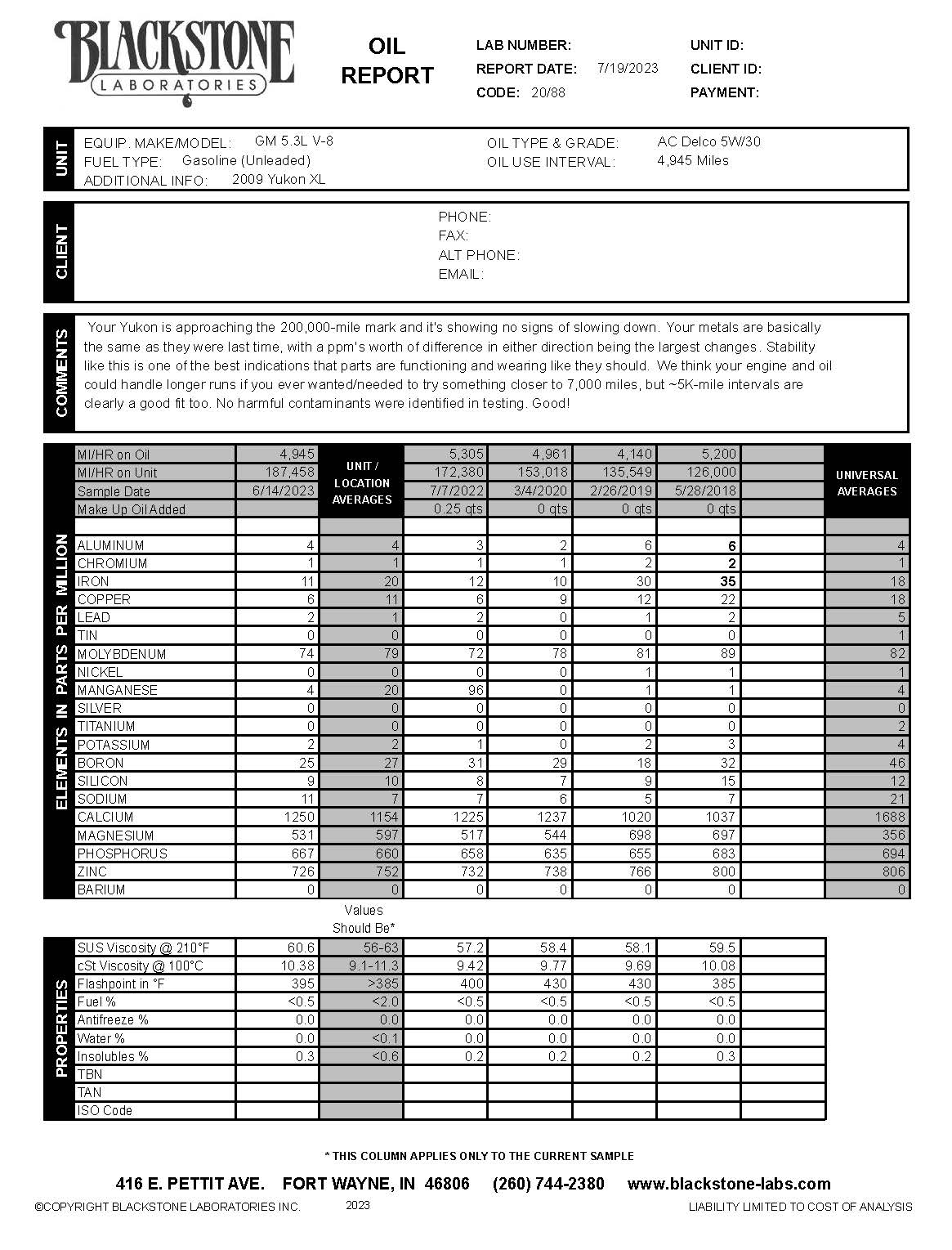

Plain Mobile One is not a good oil to run in these trucks. ACDelco 10-9330 or 19432322 and Quaker State Full Synthetic are far superior.
Compare the two oil samples on the right with the others, those were with Mobile One and the others ACDelco. I have another truck on Quaker State with nearly the same results.

Get your truck tuned and have them turn off AFM. This will extend the life of the drivetrain and deliver better performance. Use GM OE parts only and follow the severe service schedule for maintenance.

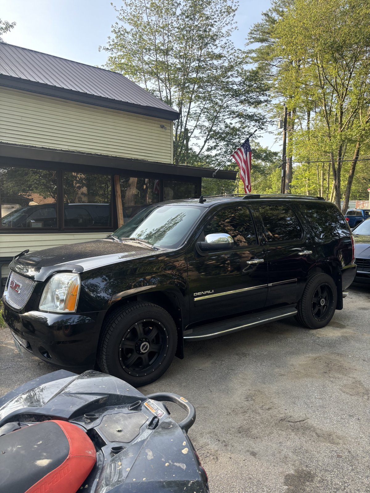

Welcome to the Forum from NH.
Pics of the truck, please.
You are already receiving sage advice from the knowledgeable folks on this Forum.
As stated above, it's basically a roll of the dice whether or not you will have an AFM issue in the future. My recommendation is to (1) buy the OBDII dongle to disable the tune electronically, or (2) purchase a proper tune (~$650), which will both electronically disable the AFM, and pep up your 6.2 motor and make dramatic improvements in the transmission's shift patterns. I went with option (2) for the motor and transmission improvements with BlackBear Performance (a valued vendor on this Forum), and IMO, it is the absolute best bang for your buck to improve your truck's performance and longevity (note that my 07 did not have AFM built into it).
Also, do NOT let your motor oil go over 5000 miles without an oil and filter change.
Derry, NH and I will look into black bear
