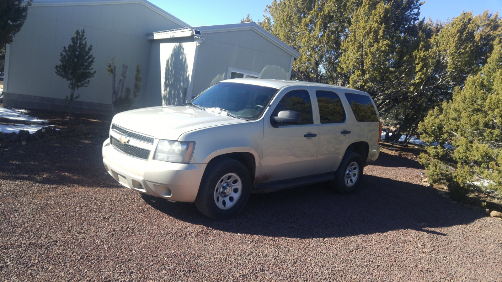

I just got my 2011 PPV or SSV today. Mine is a 4x4 so I've heard that it is an SSV instead of a PPV. I'm a totally newbie regarding PPV's and SSV's. I'm also new to the 2007+ body style trucks. I have had about 15 of the 2001-2006 trucks but nothing in the newer style cause I've always been afraid of the AFM system and it's horrible lifters. I have the Range brand ODBll plug in thingy that keeps the AFM off for now but plan to get it tuned from Blackbear Performance and hopefully do a full AFM delete someday
. I'm hear to learn about this new truck too. I'm following this thread.
