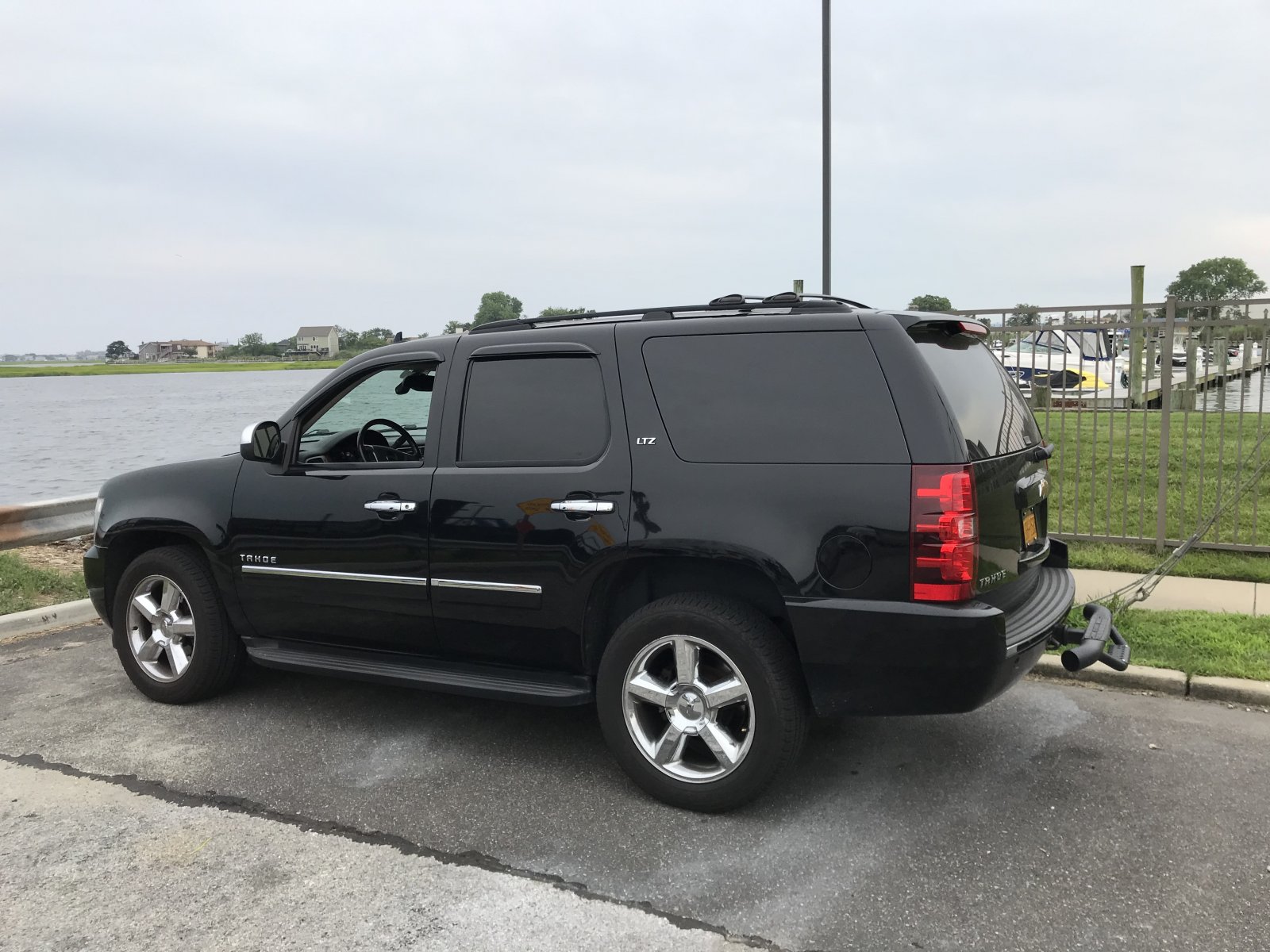

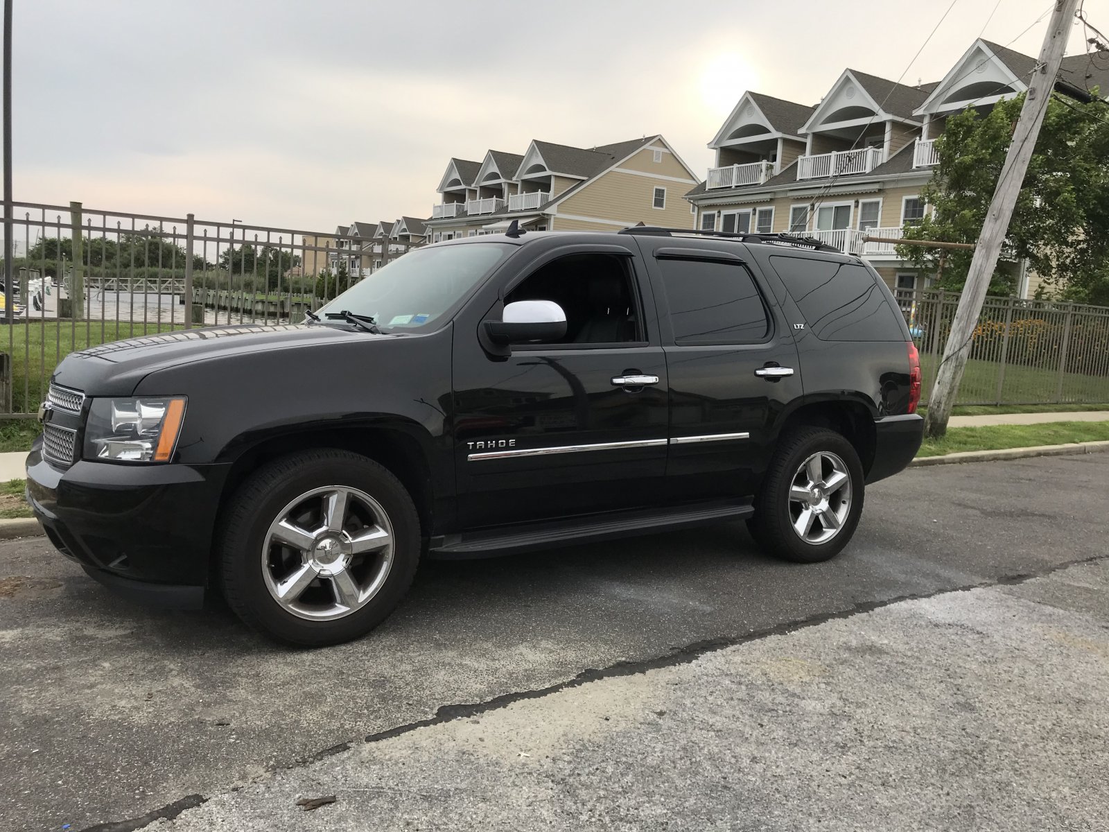

Pics of the truck, please.

Thank you all for your replies. I have been busy beyond busy at work but finally settling down to normal.
Well, here are the last 8 of my VIN#BR356650…..based on that I saw the z55 for the front shocks. Now here’s another question: Z55 translates to what?
I also added a photo…
