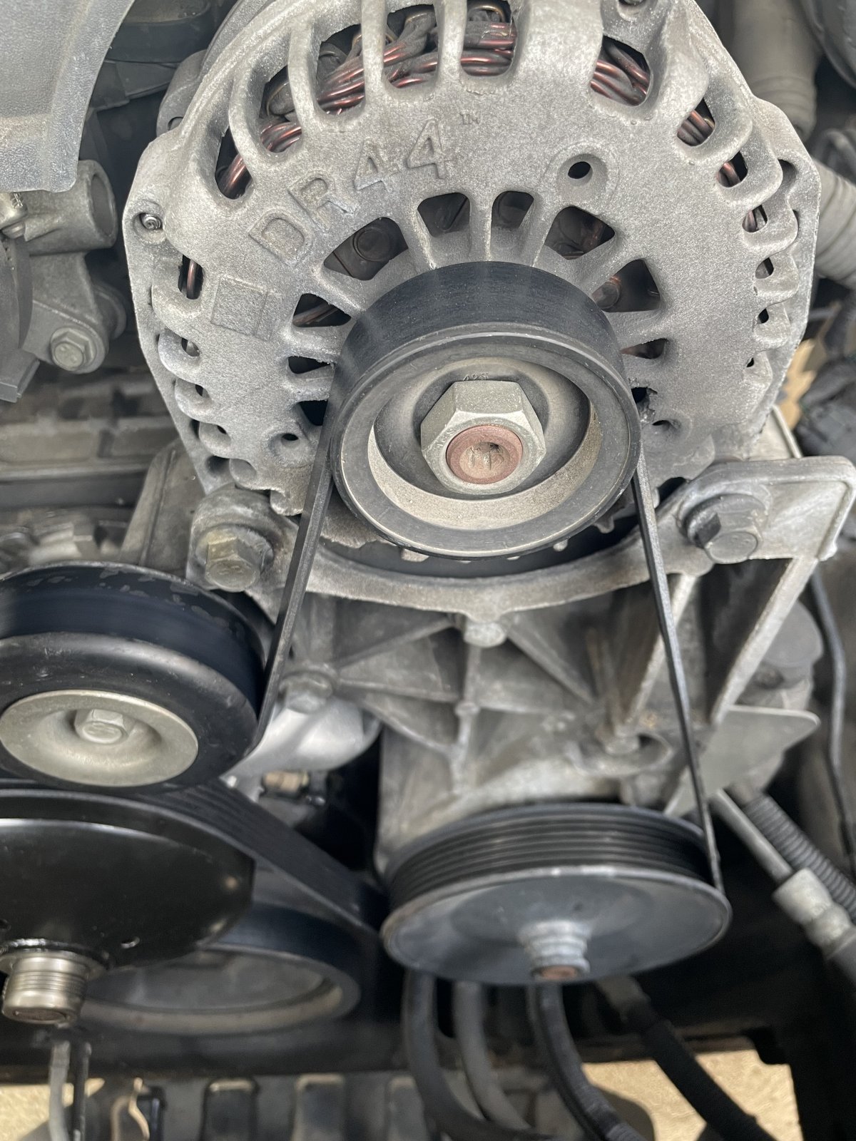

It was the pump… coolant must have bebe dripping on to the belt which then caused it to get on the alternator. Replaced the pump and all is well …
