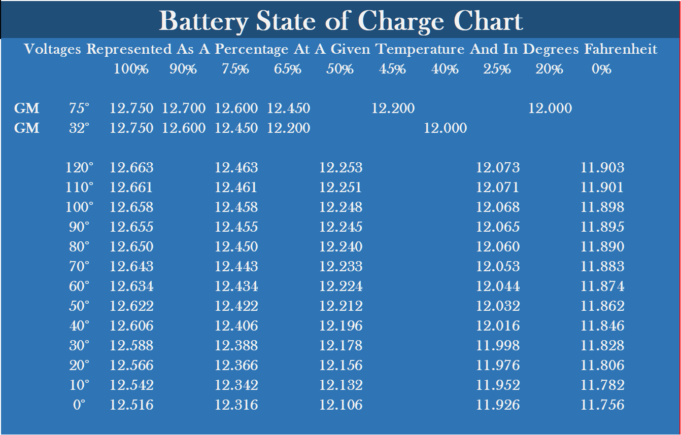

What's the temperature outside when you take that voltage reading? If the drive time is during the day and long, does the alternator spend most of the time at full output, over 14 volts?

Use that temperature/voltage chart when checking your voltage in the morning after the truck has been sitting all night to see what its state of charge is.

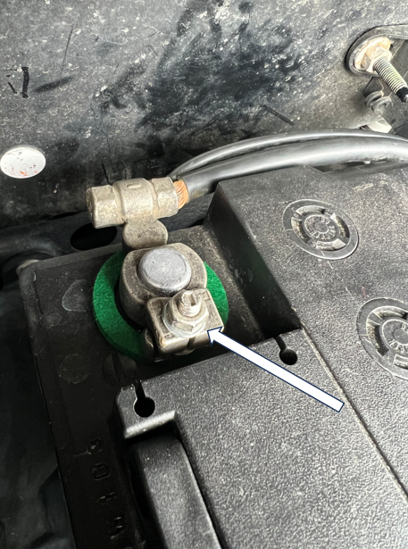

Looks like this issue was indeed being caused by a loose negative battery cable. I went to start the truck to take my son to school this morning, and sure enough I turn the key and I get the click with no lights. Opened the hood and jiggled the negative battery cable a bit and the truck started right up, and I didn't even have to use the jump starter! I tried installing a battery shim but it was too thick, and the negative battery clamp didn't seem to want to tighten up much around the terminal. I was stumped for a few minutes, and then figured I'd throw a washer on the bolt thread since it looked like the nut was digging into the terminal clamp. Before I was able to just pull the negative cable off the terminal with just a few tugs, so it wasn't on very tight. Now I can't wiggle or move it at all, so I'm hoping that will be a big improvement!
One tiny a$$ washer saves the day!
