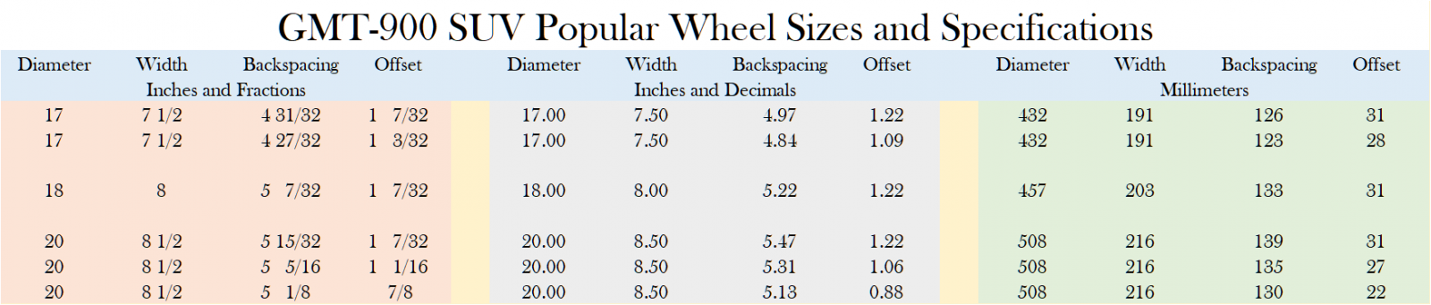

!!!WARNING!!! I'm attempting mental math here so wait for a few smarter people to reply before making a decision
I'm seeing the factory 17x7.5 wheels to have an offset of 31mm. The factory 18x8 has the same offset, so we'll go with that one for comparison. The AR172 is 8" wide with 0 offset, so that means it will stick out 31mm (1.25" converted and rounded up) further than than the OEM 18x8 wheel. This equates to about 1.5" further than your 7.5" wheel. Is your Tahoe lifted any? Stock tire size? I ran 1.5" spacers on my factory 20x8.5" (31mm offset) wheels and tires with a 2" front lift and had minor rubbing only at full lock.
Based on these numbers, I'd say they'd fit and barely clear if you were lifted at least 2". If stock height, the amount of rubbing will largely depend on the overall dimensions of your tires. Different brands and types of tires can vary wildly in actual size even if the advertised sizes are the same.

Thanks,my truck isn't lifted and I wanted to use the stock 17" tire.Thats why they said it wouldnt fit I guess.I didn't understand the offset.Thanks a bunch.

While I am no mathematician either, I agree with iamdub.
Unless you want to increase the scope of your project to include lift hardware or fender modifications, I recommend that you find a wheel that you like with a 31mm offset.
